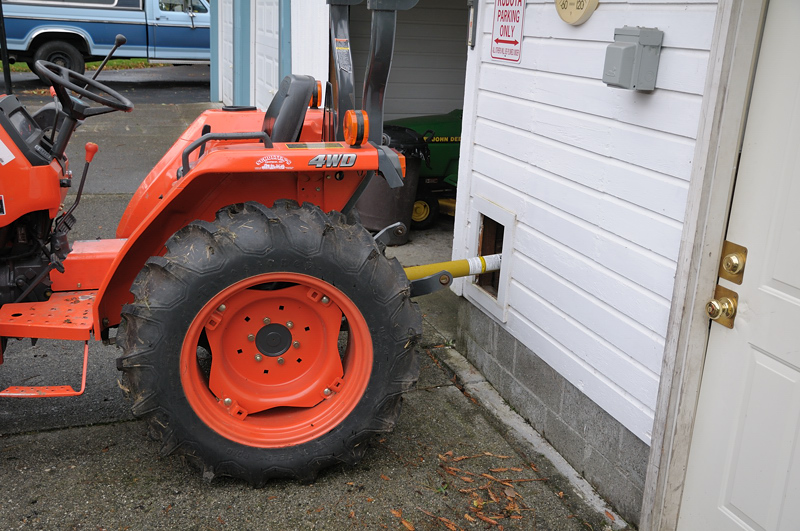

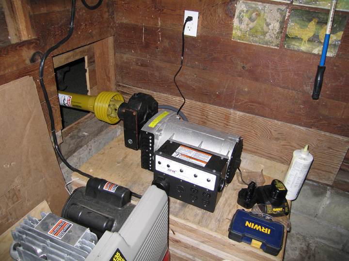

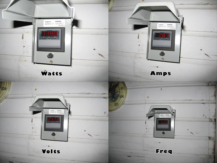

A PTO generator was one of the first implements I purchased as we lose power often. I mounted it in a corner of my shop and put in a removable hatch so I can back up the tractor to the shop and put the PTO shaft through the hatch. I also put in a multimeter on the wall so I can adjust the throttle and read the frequency (and amps/watts/volts) while standing near the tractor. The generator has served us well and will run the whole house (hot tub included) at 13kW. Plus we have a 500 gallon tank of diesel since we have a diesel furnace so fuel is never really an issue.
Nicely done!! And has given me some ideas!
