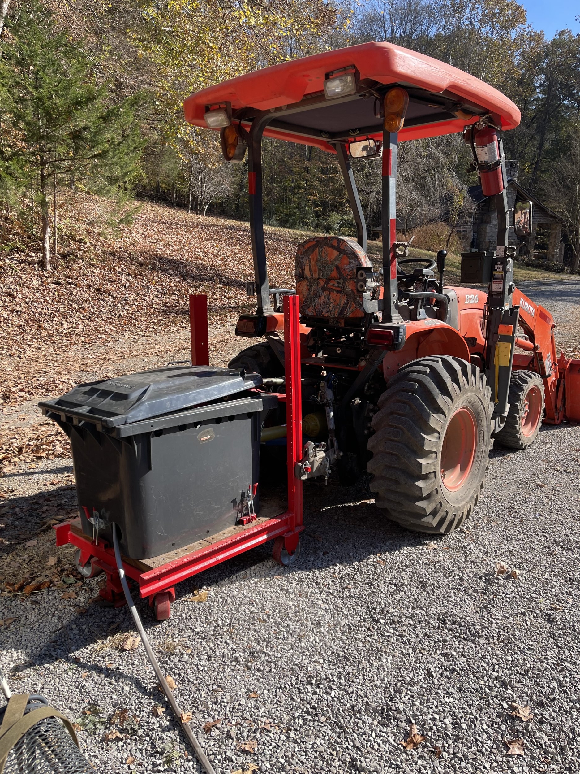

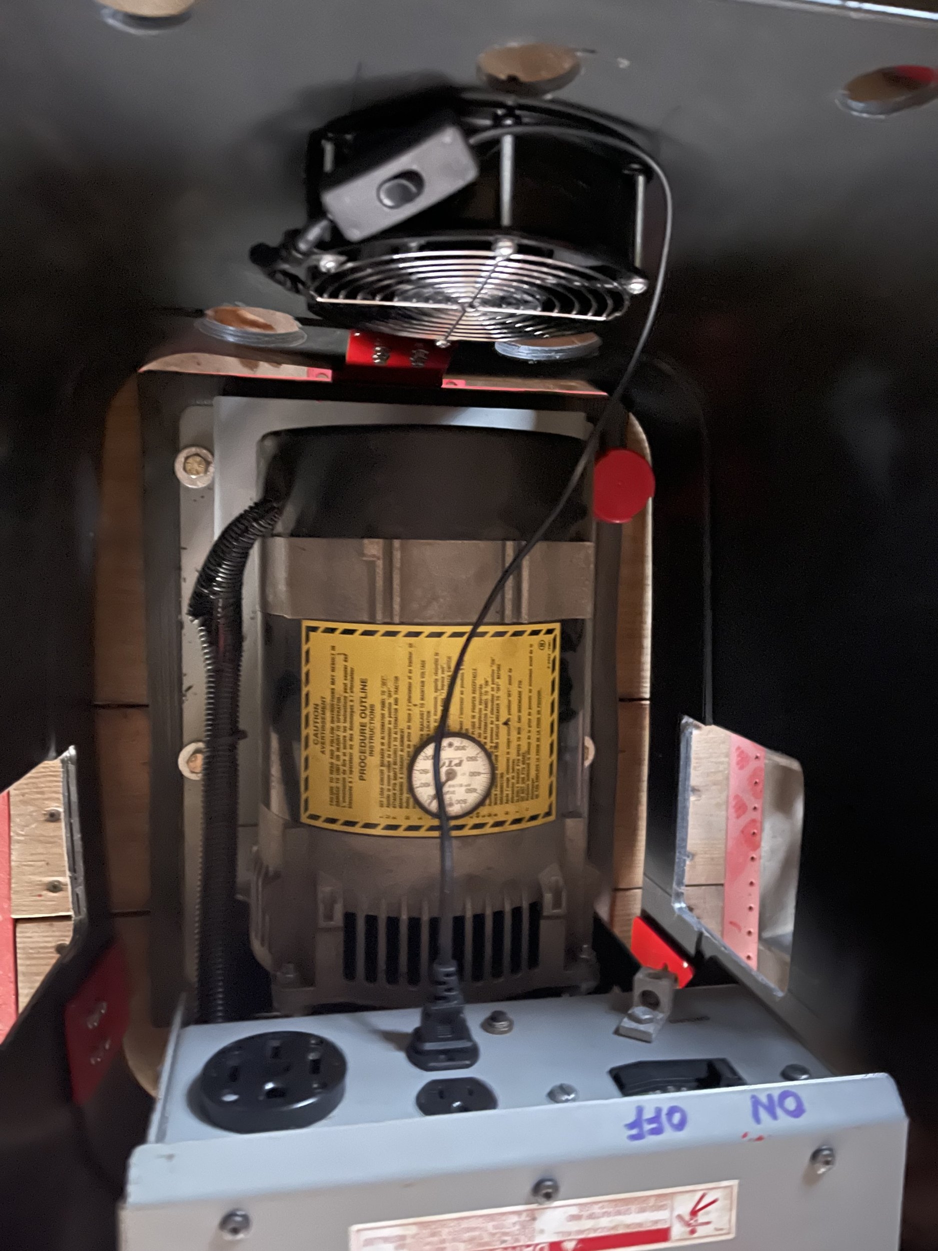

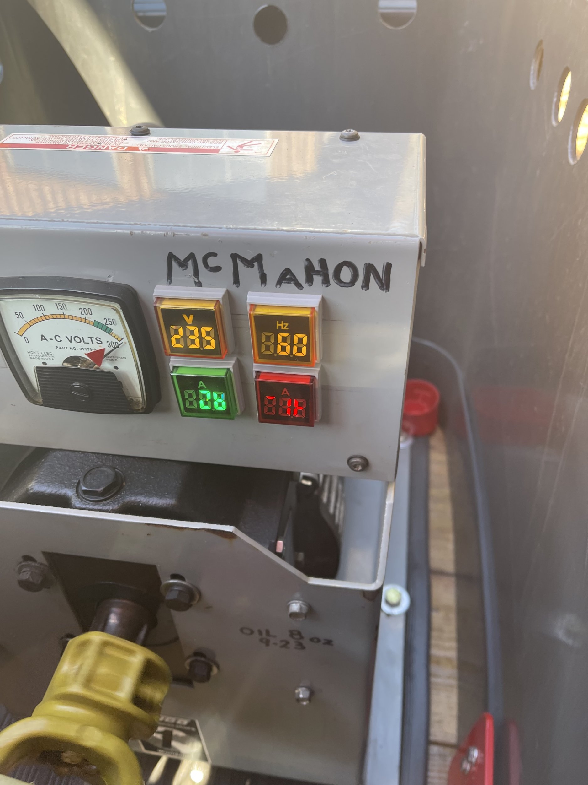

Built a weatherproof and storage cover for a Winco 10Kw generator. Does help with the generator whine. 515 input rpm helps a little too. Both gearbox and alternator noise.
The alternator does have a fan. In my tests the gearbox gets hotter than alternator. Installed a fan to help cooling. Improved meters on generator and in the house to monitor output. More details on another post.

I believe I commented previously on your well done trash can cover. I've taken measurements for covering mine, but have not bought the materials yet.
