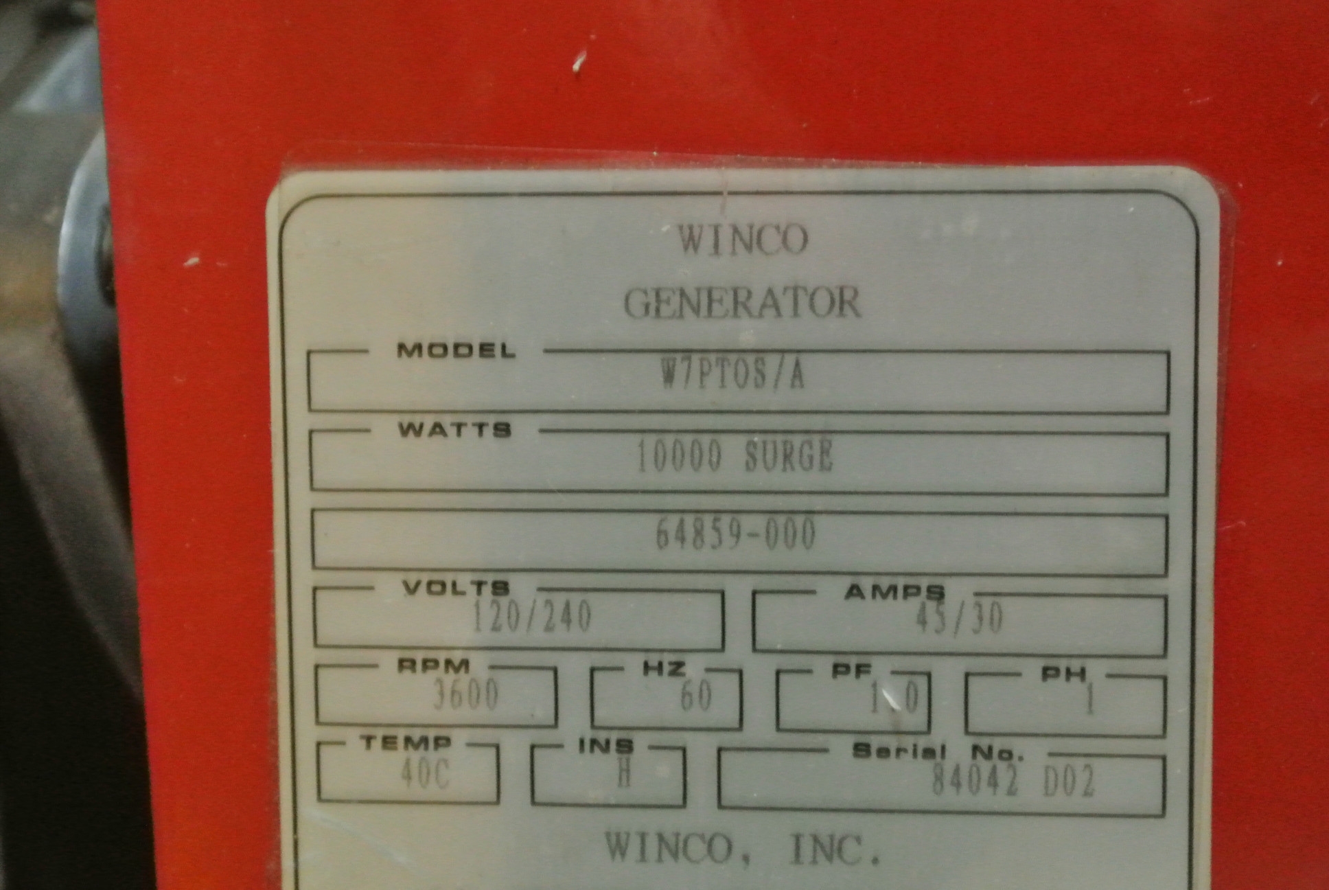

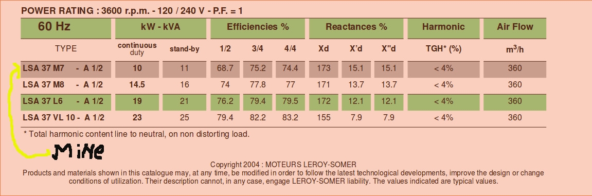

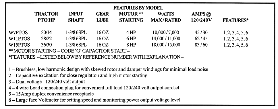

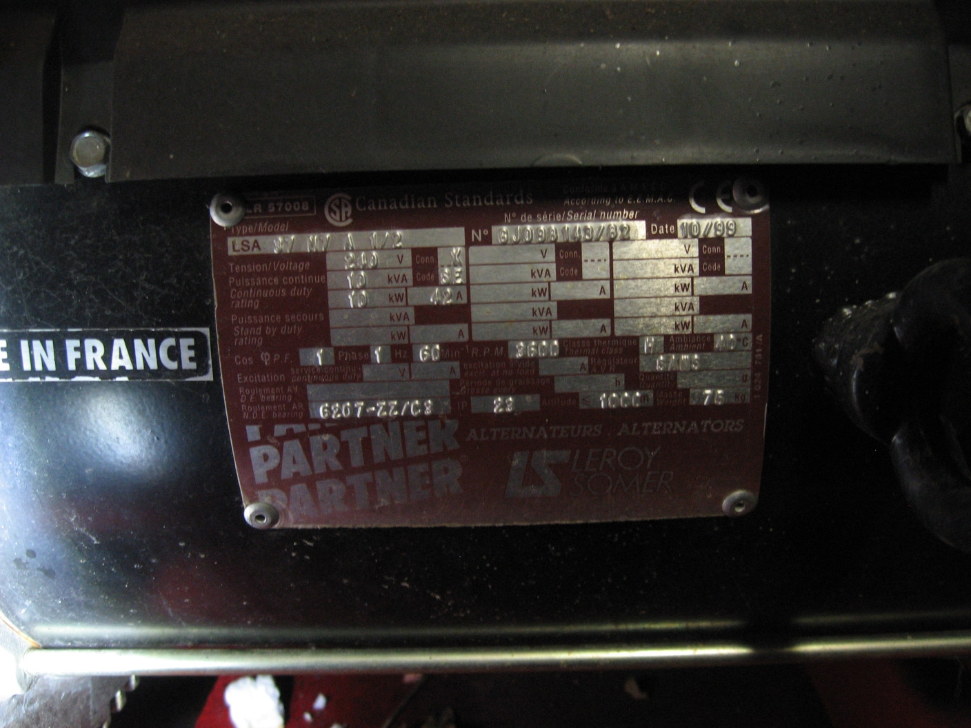

I have had a Winco PTO genset since 2003. When I purchased it, I remembered there being a discrepancy between what I ordered and what I was shipped. At the time I was told by the sales rep that they did not have the smaller generator head in stock, so they were going to ship me the next size up. I had ordered a 7Kw unit (W7PTOS /A) and they shipped me a 10Kw unit (W11PTOS /A).
In December 2022, we had another extended outage, and it got me to thinking about my generator setup. In Dec 2022, I contacted Winco to verify what I had. They told me to send them photos of both the Winco data plate and also the generator data plate. I sent them a photo of my 'model number plate' for the Winco genset and also the 'model number plate' from the Leroy-Somer generator head. One of their technical support team replied. And this is what they said:
"Per the data plate you sent in, yes you can expect 10 kW from this unit. (42 amps continuous rating x 240 volts = 10,080 Watts.)
Surge rating on that unit is 14,000 Watts. (roughly 58 amps.) You will likely need at least 20 hp at the PTO shaft output at 540 rpm to be able to fully load your generator.
Thank you,
Daniel xxxxx
Product Technical Support
Attached are the two plate photos associated with the generator. Also included are two technical images.
One of them seems to suggest that my Winco generator is capable of starting a 2-4-6HP motor, if I had at least 20 PTO HP.
