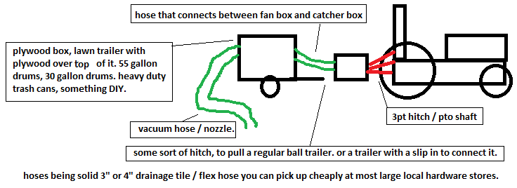

cleaning out a grain bin to turn it into a shed, and came across some old blowers that you might find in your central heating or central A/C. no motors but they have a shaft that a pulley or something could be attached to.
also found another blower that looks like it might have more suction power at moment has a 230volt motor on it.
i have some 30 gallon and 55 gallon drums.
some misc scrap plywood, silicon and spray foam and some screws. i think i have some 4" or 3" flex pipe you might use for end of gutters to get water away form the house some.
i really don't like idea of debris going through the fans, the 230volt blower might be able to handle debris without clogging but rather not do that.
so some sort of box would need to be placed around the blowers. and allow for a shaft to come out the side to connect PTO somehow.
errr perhaps getting a standard box cheap fan that you might have in your hose or prop up front of a window. and remove the motor, and hook it up to the pto shaft with some pulleys. to increase speed of the fan speed. and have it suck the air out of 55 gallon drum or some sort of plywood box. that had a 3" or 4" hose on it, to use as a vacuum.
something strong enough to allow small size crusher rock to be picked up. yet also able to say pick up grass 3 to 5 feet wide. no need for hydrualics or tilt bed dumper, or like a regular house carpet vacuum with the roller under neath it. just a straight shop vac like vacuum but ran off back of tractor PTO. with ability to make your own catcher, either garbage cans, 30 or 55 gallon drums. or building a plywood box on top of a small trailer or toe able lawn cart.
maybe a carry-all. to hold the vacuum fan that connects to PTO shaft and 3pt hitch on tractor. then a ball / hitch with a hose added to carry-all. to make your own size toe able catcher box.

more of lines of thinking of, a simple metal grate. or even plywood with a bunch of holes in it. with perhaps some sort of fabric or smaller size grill or another piece of plywood with even small holes. to protect the fan.
looking for cheap = better. and general materials that might be around and easily obtained for a few bucks.

two observations:
1. the containment "box" would have to be air tight in order to acheive a vacuum.
2. the main vacuum tube (filters) would be prone to clogging which will result in loss of vacuum.
i would allow the material to "pass through" the fan. not only will it be more effiacient, it will shread debri allowing you to fit more in the containment vessel.

I agree that the containment box would have to be tight, but considering the amount of air flow required for this project, a few leaks will not make much of a difference.
I see a system more like a big shopvac. Mount the blower on a big box with a filter cavity built into the box. line the filter cavity with old trampoline canvas or screen door material.

I don't believe you are going to get the kind of suction you need from those squirrel cage blowers. Put your hand in front of your air condition intake duct and feel the suction. Not much there.
Those large blowers/vacuum on the back of tractors or those that have their own engines, either have large blades, or the smaller blades turn at a higher rpm. The impeller on the Trac-Vac, are about 4 in wide, and the diameter is about 18 to 20 in, and they turn at around 3600 rpm. The blades also have to be thick, like 1/4 in, and even then, the tips of the impeller have been bent.
I wish you luck on those fan assembly's, but don't expect much.

Furnace blowers wont work. They move a lot of air, but to do so must have very large pipes because they can only develop an extremely small pressure differential. -- Therefore low velocity flow. It wont move solids thru a pipe.

An old grain blower would be a better choice. They move air at a higher velocity and are very strong. Have found them for very little money in scrap yards and all you would have to do is some work on to get them up and running and attach your hose and some sort of container. Have seen some that the blades are only made of thick rubber spinning in a 4' drum maybe 6" to 8" wide. If you can't find one cheap.... you could always bild your own out of an old fuel barel.... These things blow grain 30' to 40' into the top of bins this should be enough air moving to be a good vac.

Don't bother with a furnace fan. They are rated for less than 1" of static pressure. What you need is a high pressure blower capable of 8-10" of static pressure. Also, high pressure blowers such as in a dust collector keep the air velocity very high as well to transfer the material. Keeping rocks and other debris out of the fan is very simple with out using a filter. A relatively large settling box or tank will need to be installed before the fan. As dense material goes into the tank, the velocity slows to a point at which gravity has a chance to take over. This way only very light materials actually go through the fan.
Pull behind tractor vacuums work great with one minor issue, and that is with sticks getting stuck in the hose.
