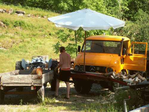

   / pto driven log splitter #45
I have an old Unimog and fitted it with a hydraulic log splitter using the 540 pto and an old hydraulic pump from a truck. The slow revolving pto and the big capacity pump gives an ideal speed on the splitter. No trouble with overheating. The splitter is mounted in front with a sliding attachment, (self made) A jerry can with hydraulic oil is enough, even if experts says otherwise.

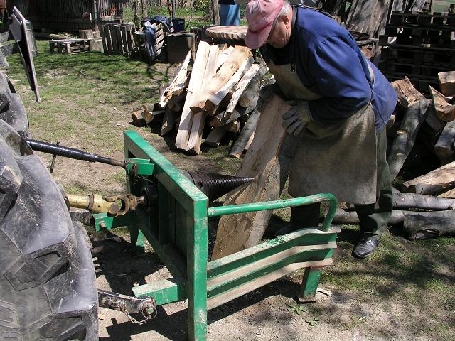

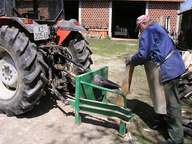

   / pto driven log splitter #48
People here only knows for that type of log splitter, and most famous tractor to run it is ZETOR, because it has reverse gear on PTO, in case if log get stuck and not a split completelly.
It is driven @540 rpm, and needs just few seconds to split a log.
My tractor doesn't have reverse PTO gear, but that logs are pretty small and there was not a problem to split them.
