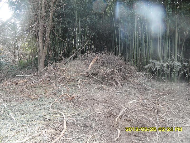

I've a 1/4 acre lot that that had been gone to nature for 30 years. Trees, sapling, briars, vines. After cleaning up I needed mulch.
These pics show maybe half the stuff I took out.
My choices were cart it to the dump myself in my F350 - about $15 dump fee and 30 miles of driving, plus labor of loading and unloading and I guessed at 10 loads AT LEAST. So I estimated $500
Pay a trashhauler to haul it - based on getting dirt trucked on a later project about the same - $500
Pay the county at ~$60 per 8'x4'x4' tied/bundled load
Rent a chipper for about $800 week
or
Buy my Jinma 8" chipper for ~$1,700.
Since I knew I would use the chipper later in Mississippi I bought, got good use out of it and have used it several times in Mississippi.

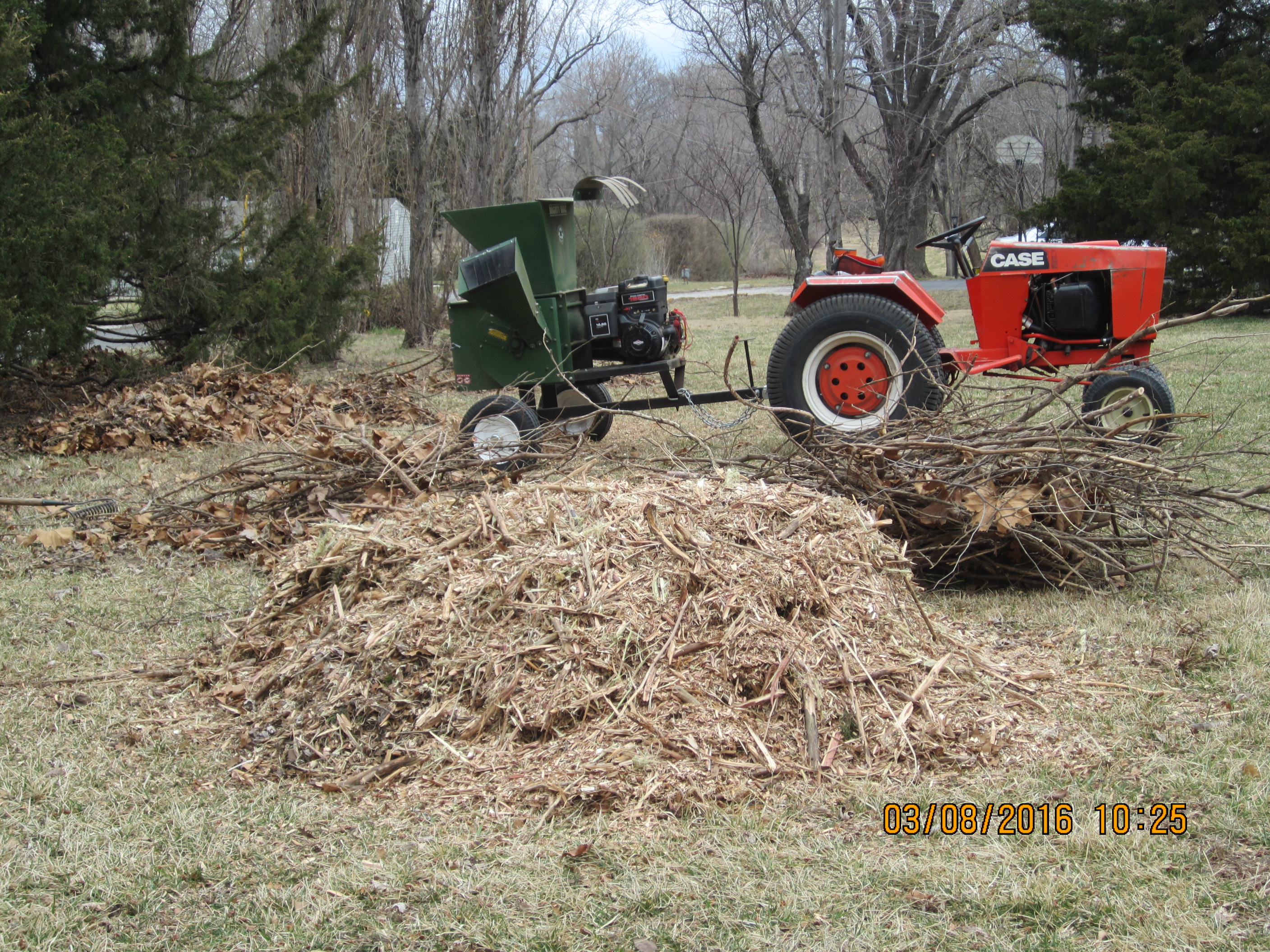

In my case i had already bought a stand alone chipper/shredder (MacKissic). I like it for small jobs and use the shredded/chipped debris for mulch and walkways on my little three acres and around some of my kids' places in residential neighborhoods. It can be towed by itself to their place.

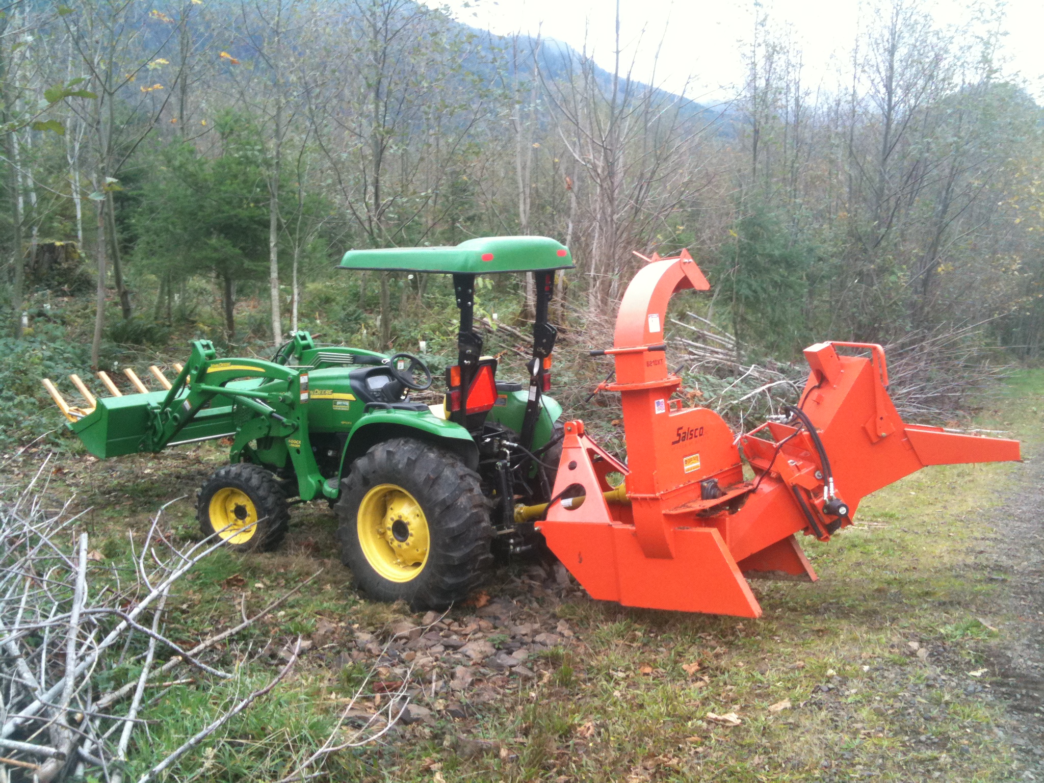

I thin my young stands of Ponderosa pines and will cut and chip 750 to 900 young pines every spring. I have a big 'ol heavy grapple on my tractor but for this job it is useless. No way I can ***** foot the tractor into the stand of pines and retrieve a single fallen tree. All cut trees are drug out by hand - unfortunately, those are my hands - and stacked on a "to chip" pile.

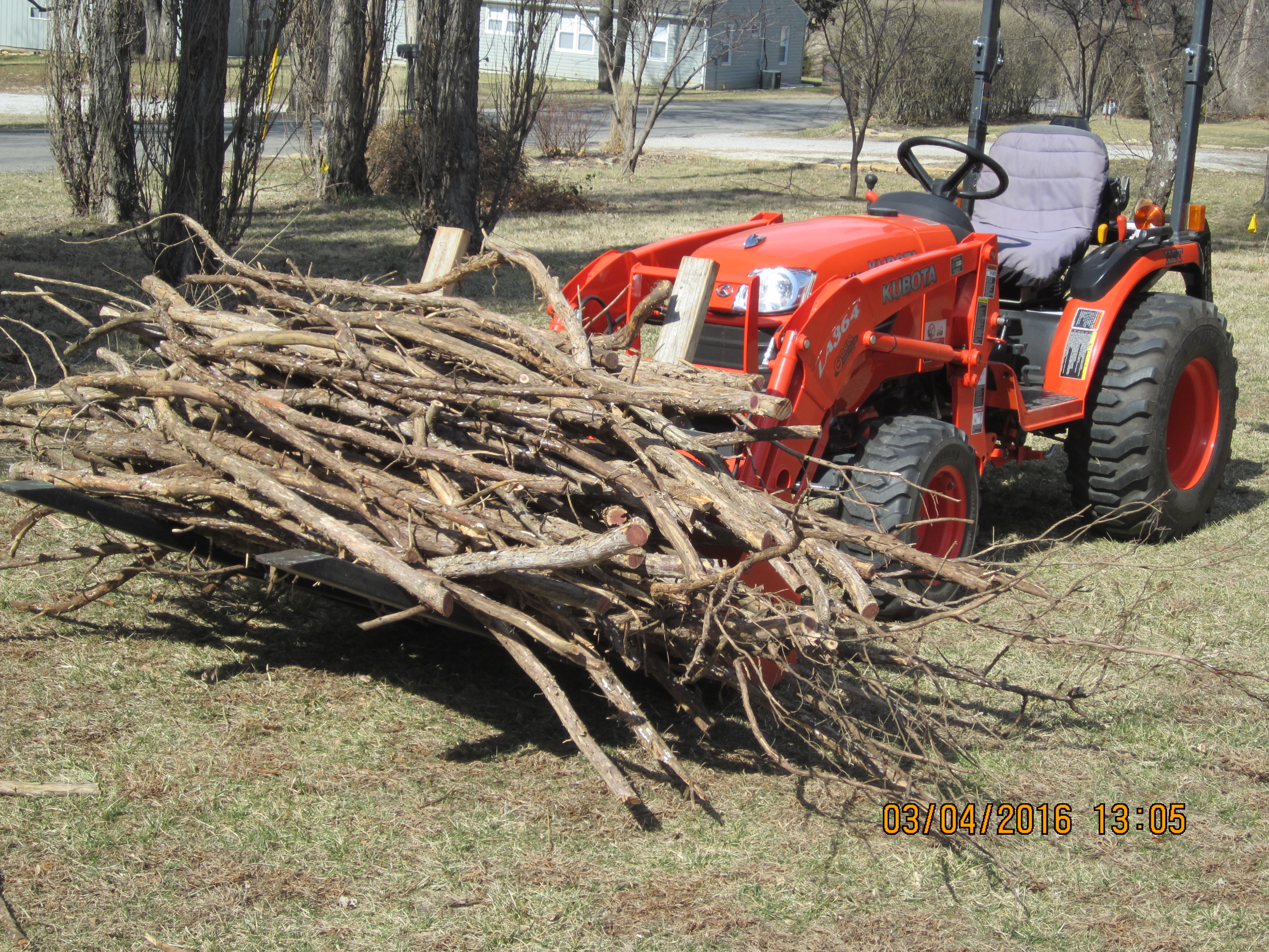

I leave the chipper on the back while I'm picking up material with the grapple and taking it to the chipping area, then when I'm ready I turn around and chip it. Of course if you have a helper feeding the chipper it can't be on the tractor.
Before I got the grapple I'd hand pile the material to be chipped in a place that I can get the tractor to (our land is steep). With the grapple I still have to pile it where I can reach with the grapple but I can take it elsewhere to chip.
