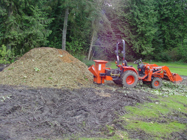

I have a Kubota B7500 - 21hp (16 pto) with a Bearcat 70554. It's been a great machine for me. Easy to service and handles just about everything I give it. It's rated to 40hp, so your tractor could handle it nicely. It's just a little over $2000. I really like the fine chips it produces. It composts quickly and makes a great mulch for landscaping. I've attached a picture of one of the piles I've done with it. Last year I did about 30 yards of mulch with it and plan to do at least that much this year. It's not a commercial model, but I'm not doing commercial work with it. For 30 yards a year, this machine is more than adequate for me.
Greg
