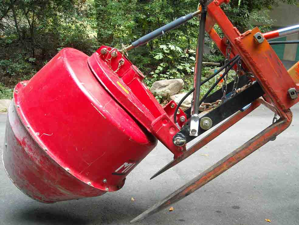

Does your mixer have the series of holes for the lift arm pins to go in for different lift heights?
Yes, my MIXER80 has 4 pin positions for the 3-pt lift arms, and 3 holes
for the hydraulic toplink.
With thick concrete, I was dumping all the way to the ground with the
pins in the lowest holes, on a Kubota L2550. When I acquired my
1st JD955, I discovered that its lack of height was a dumping problem.
I am now using the 2nd to bottom hole on my Kioti, but I now use the
mixer on my loader's 3-pt. The BX is shorter than the JD 955, too.
The first problem I had with the mixer was the lousy single-acting cylinder.
You really need a double-acting cyl, so I converted mine. Now I no
longer use the cyl at all.
Sorry for re-opening an old thread - but I'm curious how you power the mixer. Do you run it on the back of the tractor and then move it to the front to dump? I think I see hydraulic hoses going to the bottom part of the mixer - are you powering the mixer thru hydraulics ? If so I'm really interested to hear how you did that - because I'm thinking of doing the same thing. Thanks!

dfkrug, have you thought about making the mixer attach using a standard SSQA?
/ pto cement mixer #31
I suppose if the Kioti CK30 came with a QA FEL bkt back in 05 when I
bought it, I would have opted for that. The one that comes on the
CT230 loader, which I bought in 2010, was nice.
I decided not to add my own SSQA to the KL130 loader because I
wanted to retain as much of the lift capacity that I had.
As it stands, I rarely remove my forks, and I only remove them when
I need my 4-in-1 bkt. I can use 3-point implements, my large firewood
bkt, my trailer-tender, and my manlift all with the forks attached.
