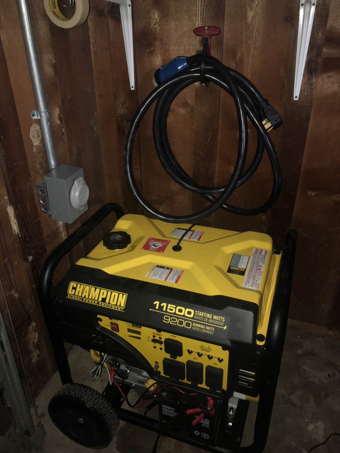

I just recently setup a generator for the house.
Wanted easiest setup for wife or anyone I needed to set it up when I am out of town.
It’s a champion power equipment model 100110 ( 9,200 running watts, 11,500 max watts). I have a interlock switch to prevent the main breaker and generator breaker from being able to be on at the same time.
I am currently keeping 28 gallons of fuel on hand with a full tank ( 7.7 gallons) in the portable generator. It is said to get 10 hours at 50% load on the 7.7 gallons. So I got just under 5 full tanks/ 50 hours of fuel available. I am looking into a 55 gallon drum to store more fuel.
Overall, it’s simple to setup and get on line, runs all but my stove, oven m, dryer and AC. I can run some of the stove but not all.
I don’t want to loose wattage output by converting to LP or NG. Happy with the setup overall. $3,500 at most invested. IMG_2864.JPG

And by cycling it, the fuel will last a lot longer. Your freezer will go over a day without power, the fridge about 5 hours. During a long outage, we take showers when the generator is running as we are on a well. Typically run it an hour every 5-6 hours. So 5 hours a day. Doing that your current fuel supply will last 7- 10 days. Ethanol free gas will last longer but is 35% more costly, so we use 10% ethanol with Seafoam added, but we only keep it for a year, then use it in the vehicles.
If you go with a 55 gallon drum, it needs to be vented. We have a 300 gallon tank with a hose and fill nozzle to make dispensing safe and easy. Our codes here call for it to be 50’ from a building. Before getting the tank, I had 10 5 gallon plastic gas cans stored in the garage but was always worried about how the insurance company would view that if I had a fire. The tank is safer and is handy for fueling the snowmobiles, lawn tractor and the other stuff we have.

I can get ethanol free also, but plan to do 10% or less. I am treating with PRI-G fuel treatment. Have seen videos and reviews that say it’s amazing.
Unless I know we are gonna be our for a really long time, we will probably keep it running most of the time for tv and all the other conveniences.
