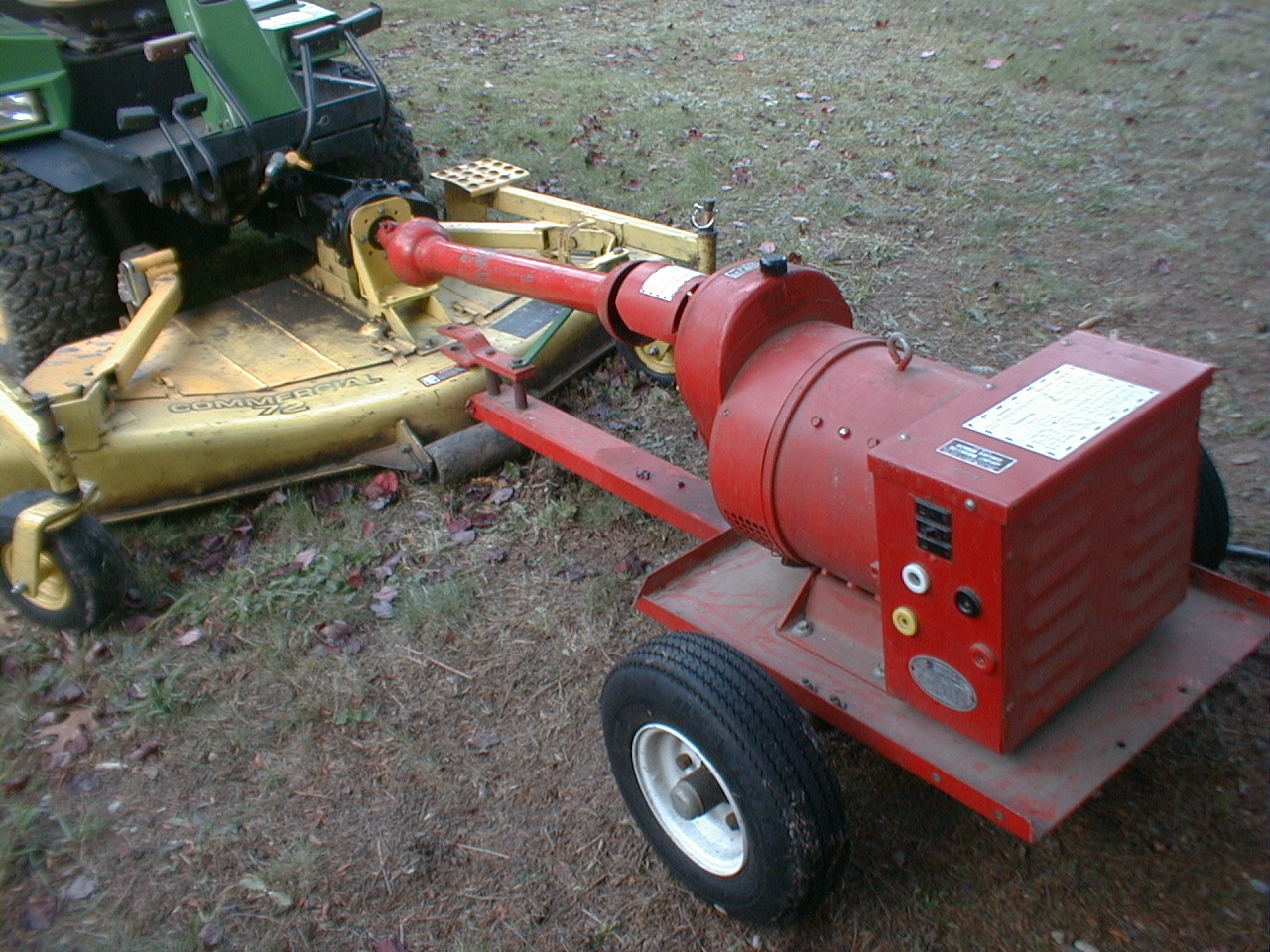

Funny: I often run my 50 kW WinPower of od my JD F-935 (~21 hp) without any problems. Sure, I'm never using all 50 kw because of the 3 cyl diesel power output. I run the 2100 rpm pto thru a 3.x :1 reducer to get 540 at the alternator. (Yes it runs the reverse direction but who cares (Santa Clause, the IRS, Howdy Doody, Hillary Election Campaign, ...)
This setup allows me to use my farm CUT to do other more important things after a storm (like fetching brews from the closed party store, getting the mail, clearing the pond for a hockey game, PIC00017.JPGwalking the dogs and of course running over the mole tunnels).
This setup allows me to use my farm CUT to do other more important things after a storm (like fetching brews from the closed party store, getting the mail, clearing the pond for a hockey game, View attachment 566171walking the dogs and of course running over the mole tunnels).
746 watts per hp at 100% efficiency. That's it. At 90% efficiency 21 PTO HP - 746 X 21 X .9 = 14.1 kW possibly some more for very short surge due to inertial storage of rotor.

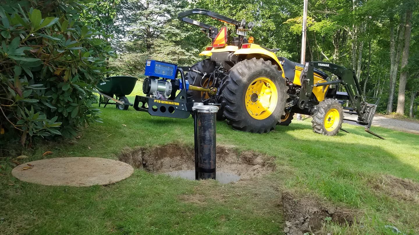

I had a well technician at my house yesterday to raise my well cap above grade. My well was drilled in the 1950s and the cap was below ground, rainwater runoff and clay had been leaking through the cap and contaminating my well. The well cap is raised by removing the pump and welding on an extension pipe, then reinstalling the pump.
Well, excuse the pun, the technician couldn't get their 15KW gas generator started to run their ARC Welder. My Yanmar LX and PTO generator to the rescue! In about 10 minutes I had the PTO generator hooked up and in place. A home standby generator wouldn't of been much use in this situation. :D
