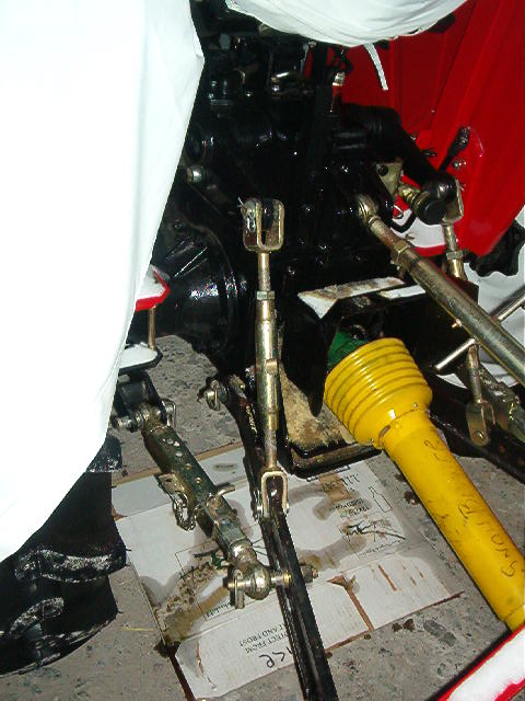

Need more help with this clutch adjustment. Any ideas about the pedal, the travel distances, where the PTO stops and the tractor gears should be in the travel of the clutch pedal? I am not certain I am asking the right questions. See the picture. any suggestions would be greatly appreciated! Have read all the articles at CTO and JohnS sites.
I am not sure this is what you are after, but these pictures may help Jinma Dealer, Wood Chipper , Compact Jinma Tractors
