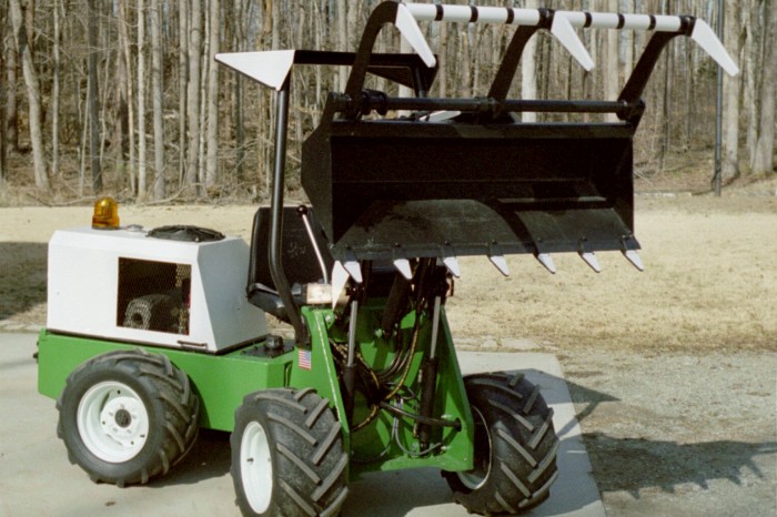

<font color="blue">My neighbor, Danny, who has owned 63 tractors so far and usually spends several hours a day on one, immediately upon trying my Grapple Bucket remarked that it needed sharpening! He has achieved excellent results by grinding every edge, bottom and sides of buckets, and sides of rock teeth, with a chisel-like one bevel 45 degree cut, like a lawnmower blade. </font>
Hey, Fourteen!
I pulled out the grinder and sharpened the blunt nosed rock teeth to a 45 degree angle. Made a very noticeable difference. So much so, that I transplanted two forsithea bushes with easy. First, I pointed the toothed bucket down and jammed the teeth into the soil. By applying down pressure and rocking the joystick side to side while dancing on the treadle pedals(my favorite pallet fork method), I was able to get the little bucket completely burried. Then it was just a mattter of curling it up while operating the pedals and I popped out a perfect bucket full of soil. I set it aside, then went and did the same thing under the bush. Popped it out and put it in the exact duplicate hole that I had dug. Picked up the pile of soil and replaced it in the hole where the bush was. Repeated for the second bush. Took all of 5 minutes to transplant both bushes.
Thanks for the tip! I recommend it to anyone with the factory rock teeth. By the way, I used my $14.95 el cheapo Harbor Frieght grinder to do it. Took about 2 minutes per tooth. /forums/images/graemlins/wink.gif
