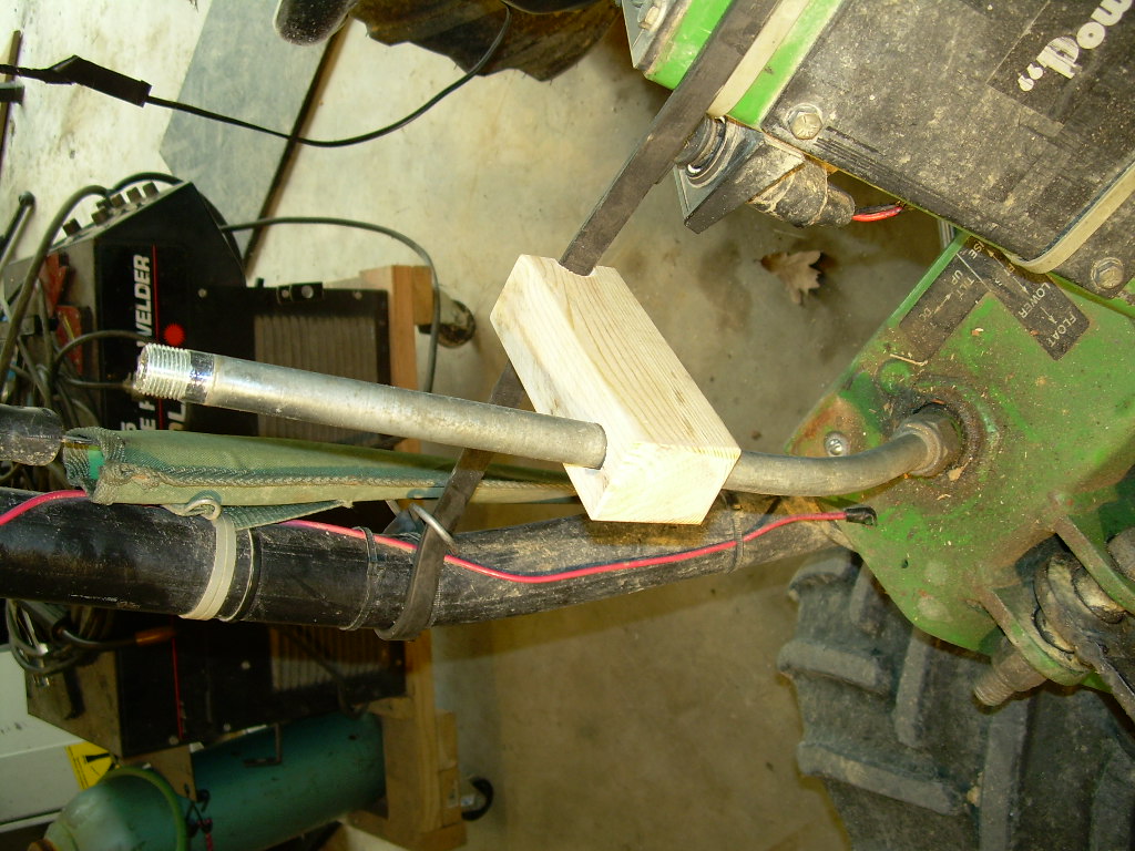

/ PT422 will not stay in float
I looked at the linkage and could not see any problem. I then machined a paw out of wood to keep it locked in place. It took a while to make this, but I think it is a good first try. It's really primitive. Please see what you can suggest to improve. It was hard to measure the exact dimension of the wood. Other people seem to have the same problem.

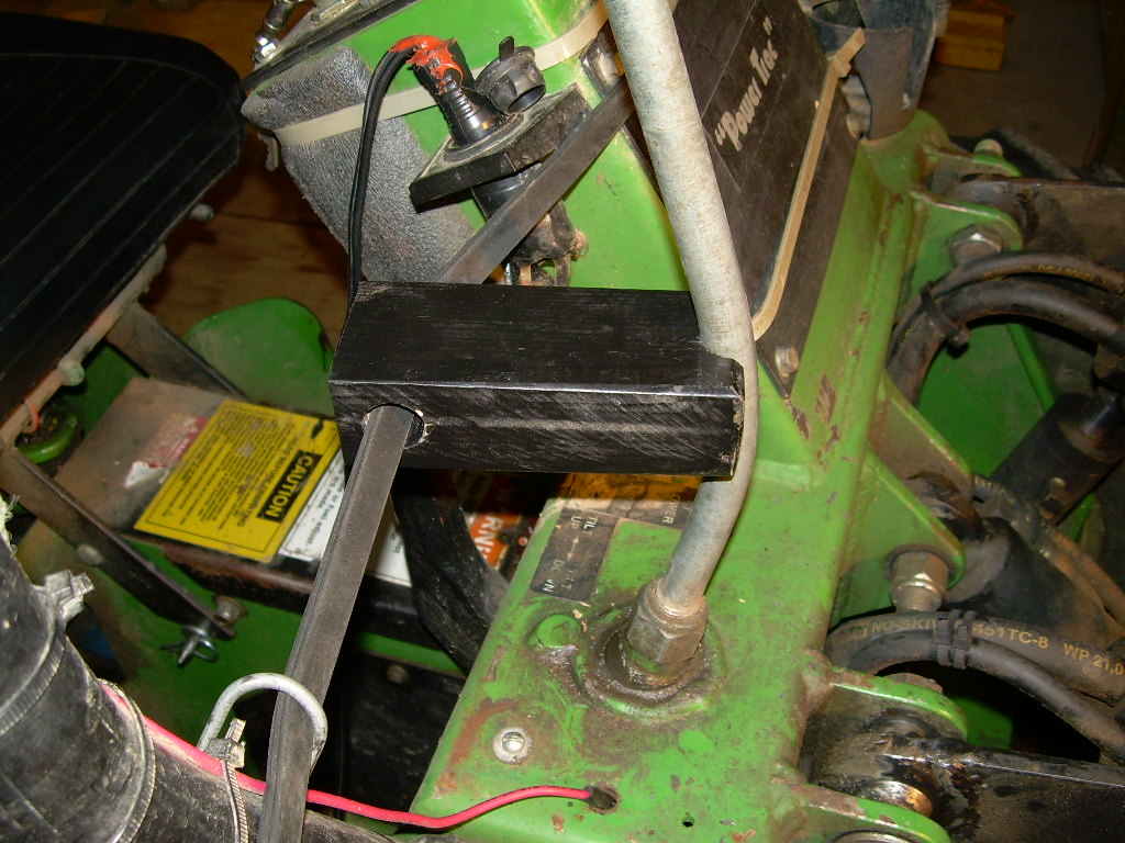

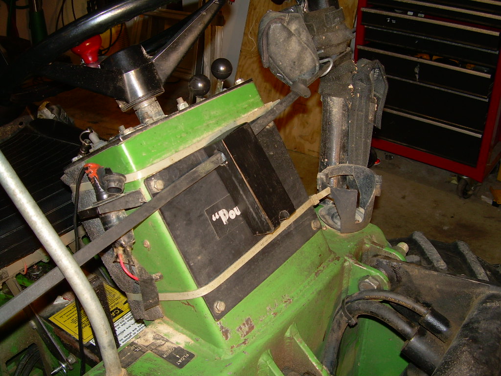

#13

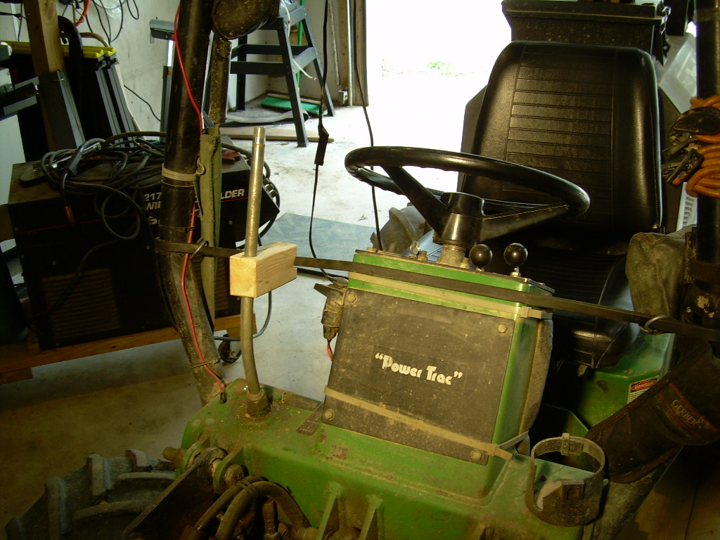

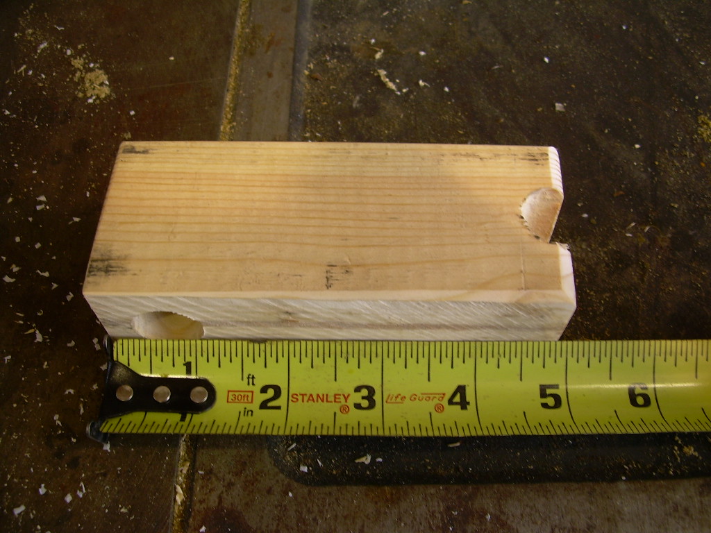

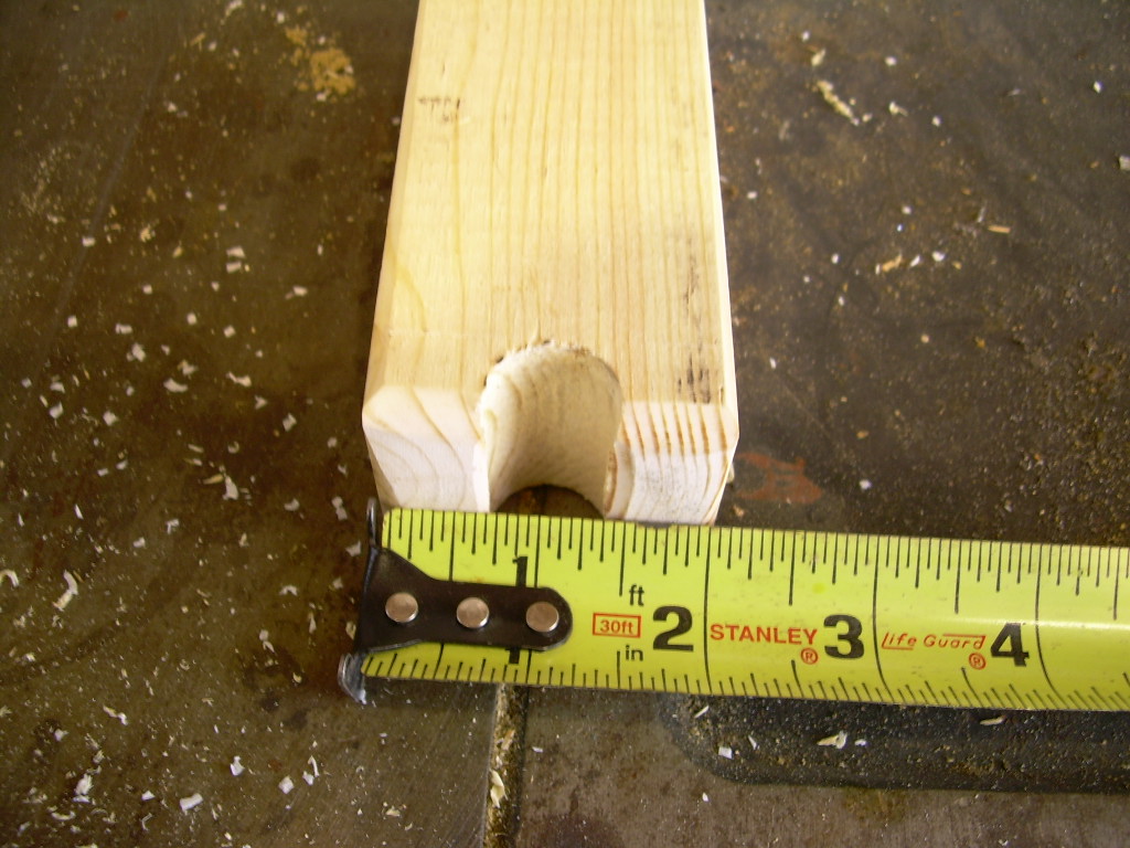

I had another idea to correct this jumping out of float. It involves a bungee cord and piece of wood. I have not driven around with this since it's raining, but it seems to work pretty well in the shop. It also can be left in place when not using it. See attached pictures.
The block is made of a 1/5 by 2 inch piece.
/ PT422 will not stay in float #14
the handle is too long and too heavy for the detent to hold it. the 180 uses two short levers,the long ones on the rest are to make them easer to control.but to get something you have to give up something.......jim
#15
Good point. PT has an upgrade for this, but it was around $60. My solution was cheaper.
#16
I have been using this modification since April 2007 and it has worked very well. When not being used the block can get in the way a little bit. Today I made a simple change to correct this. I took the end of the block with the hole in it (not the slotted end) and took it off of the control lever. Then I ran the bungee cord through this hole. It was necessary to trim the bungee cord to get it through the hole. Of course I could have enlarged the hole. I tied a wire through the bungee cord and pulled it through the hole. The act of pulling stretched the cord and thinned it out so it went through the hole easier. I can store the block in front of the pedestal when not needed. I have attached two pictures.

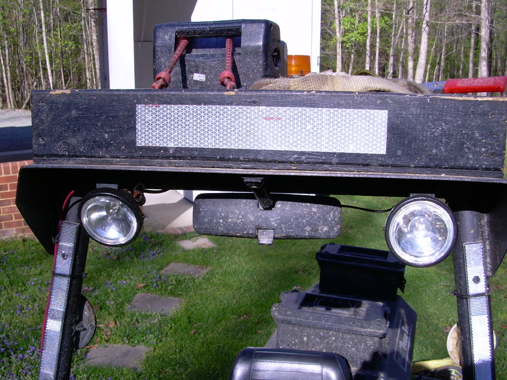

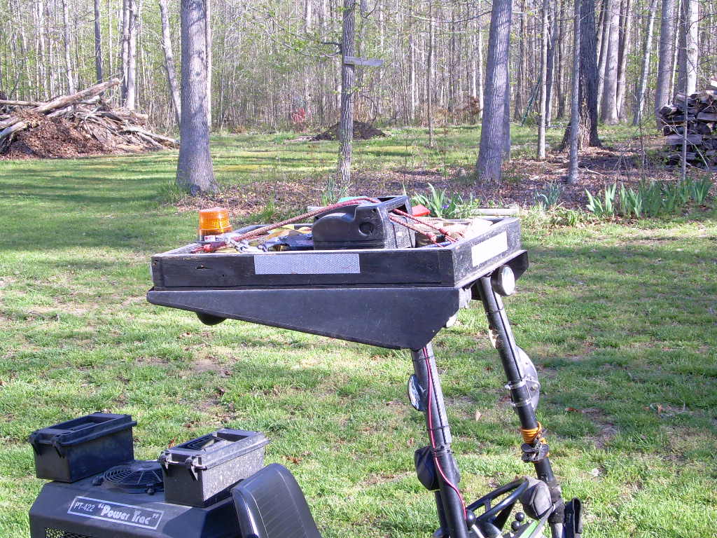

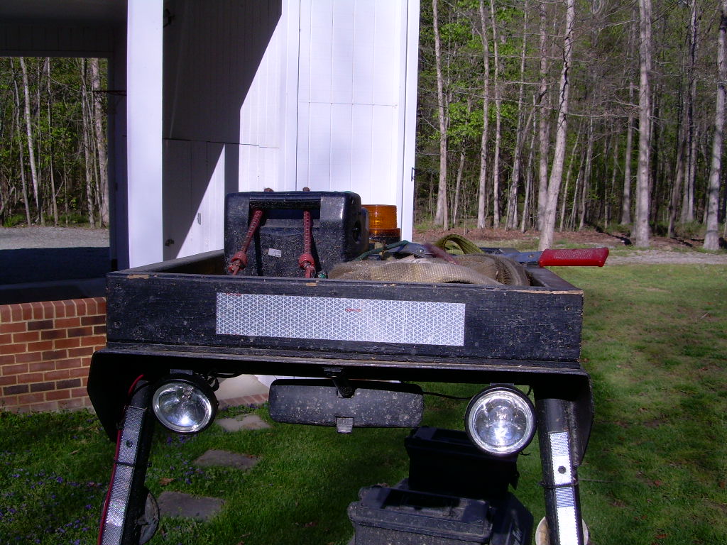

#18
woodlandfarms said:
Bob, the thing is looking like Franken-tractor. What is the 12volt supply supplying?
Carl
It runs up to a 4 switch panel. The panel controls the headlights (one for each side), the backup light, and the flashing light on the back on the ROP. I have moved the headlights to under the ROP. This works much better if you have the bucket on as you can see over the bucket.
