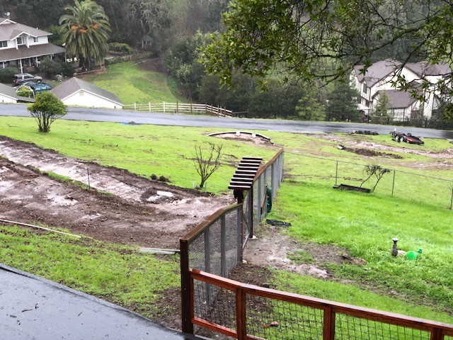

I am concerned about driving a standard tractor on our pasture. When we bought the place we had the previous owners tractor guy come out and give us some tips on how to take care of the pasture... and of course throw his hat in the ring to do the work for us. We talked a bit more in detail about liming, he told me we would have to do a portion of it by hand and that he wanted me to keep an eye on him while he was out there, said there were a few places he wasn't comfortable with. This was coming from a professional heavy equipment operator who has been on tractors most of his life.
We have a JD 25hp riding mower 600+hrs that I have used to mow down the pasture grass when it gets too tall for the animals. I have definitely put myself in some questionable situations on that machine.. sliding out of control on a turn into the fence line, almost getting hung up on a blind rise, going down hills I had no business going down. Those hills make for some great sledding when we get the occasional snow storm. Kids love it, I'm not at all convinced a tractor would.
Maybe I should do like ernemats suggested and have Kubota give us a demo or heck even ask the tractor guy to come out and lime/seed for us to see what that would look like.

I am concerned about driving a standard tractor on our pasture. When we bought the place we had the previous owner's hired tractor guy come out and give us some tips on how to take care of the pasture. We talked about liming, he told me we would have to do a portion of it by hand and that he wanted me to keep an eye on him while he was out there, said there were a few places he wasn't comfortable with. This was coming from a professional heavy equipment operator who has been on tractors most of his life.
A traditional tractor with small front wheels and large rear wheels will be less stable than your riding mower with four equal size wheels.

Well, from that description, it really IS steep. In all honesty, most people come on here and exaggerate the slopes. When they actually measure them, they are much-less steep. But seems like you really do have slopes that do need to be considered. So, what do we do about that? :laughing:
I've never seen the slope rating for the 1445 anywhere, and I don't know if any of our current members have that model. So that's something to look into.

Seriously though, assuming the 25% (1 in 4) depicted in Maple's map are grade not slope, they're significant but very doable in a Powertrac. Maybe not so much on a conventional tractor. If a demo of a Kubota could be arranged on site - that would be really good to experience.
For reference, this picture is of roughly 25% grade (15 deg slope). I've had to take dirt from the pad I've carved out up top down to the retaining walls below. Straight up and down hill, maybe a regular tractor could handle. Going sideways and dumping a full bucket of dirt on that grade maybe not. Slope.jpg.
