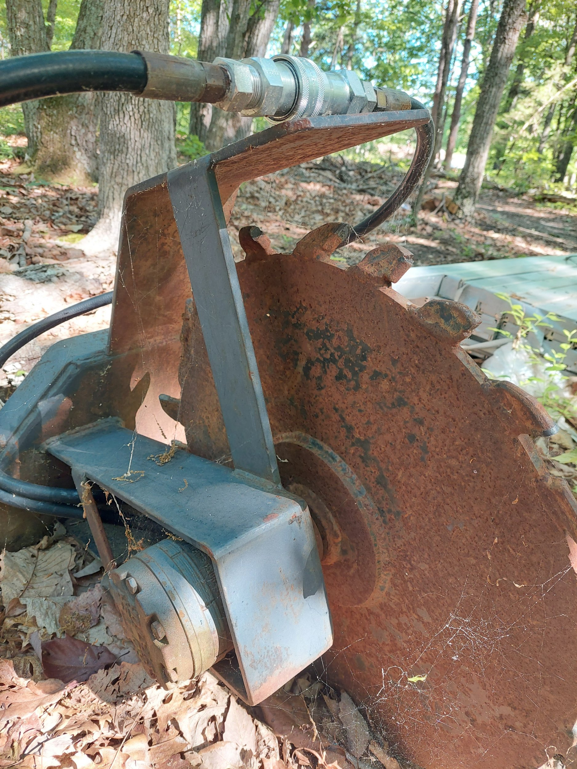

I was trying to sell my PT1460 stump grinder but no one is interested. It's just sitting here and I now have some 12 to 16inch diameter pine stumps that I could use it on.
Anybody with experience with the PT stump grinder? The PO didn't take care of the blade and it looks like about 70 percent of the carbide insets are broken off the teeth. I assume with that many broken teeth, I will need to buy a new blade?
I was avoiding using this implement cause I thought it would be too rough on my machine. Am I being too cautious?

I had one on a old 422 and it did great. I reversed the blade and the hoses to throw the chips away and did some huge cherry and maple and oak stumps. yes you will need a new blade or see if they can fix that one.... Pine stumps are a cake job ....lol.... jim

That hose needs replaced it's too small, should be the same size..... I use mine to make a ditch too, to bury electric lines... jim

BTW. Stump grinders have bolt on teeth, that maybe a trencher or a super old stump grinder.... jim

I can't really tell from the photo how many teeth are in trouble. If it is just a few chipped teeth, I would go ahead and use it for awhile. Pine stumps aren't going to put up that much of a fight.
You can buy replacement teeth and weld or braze them on, depending on whether you buy a full tooth or just the carbide. It isn't too hard.
I don't own a stump grinder, but for your photo the carbide inserts look almost like they are bolted on, in which case replacing them is a cakewalk.
@johara1: I am curious why you think the hoses are too small. This is a 1460.

Unfortunately, this is the older style blade with the teeth welded onto the circular portion of the blade. I wish it had the bolt on teeth as there are more teeth without the carbide than with it.
I think the hydraulic hoses are original.
