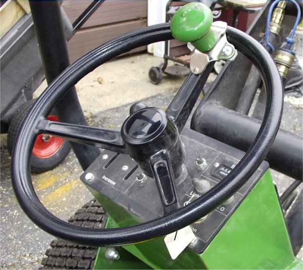

/ PT Steering Project #26
Well, for starters, the machines steer much more easily at full throttle. 3600 RPM gas engines are meant to be run at 3600 RPMs, so make sure you're running at full throttle. Anything less and you aren't running the engine's cooling fan fast enough to keep the engine cool, which can lead to heat build up in the engine and lessen engine life.
2nd, I wonder if a larger diameter steering wheel would help? More leverage = easier turning. Some math genius here do the calculations and see how much leverage you would gain with a 1" or 2" diameter gain in a steering wheel.
Or, let's post pictures of where the spinner knobs are mounted.
Here's mine. It's a tad inside the ring of the steering wheel. I wonder if mounting it farther out from the center would gain significant leverage to decrease the force needed to turn the wheel. Of course, you'd have to be sure your won't be smacking the joystick with your knuckles.
/ PT Steering Project #27
Aircraft , tanks and a lot of things use HYD because it is the best thing for low power input to high power output at the moment.
On the subject of spinner knobs, I always mount mine at about the 270 degree position with wheels pointed at 000.
