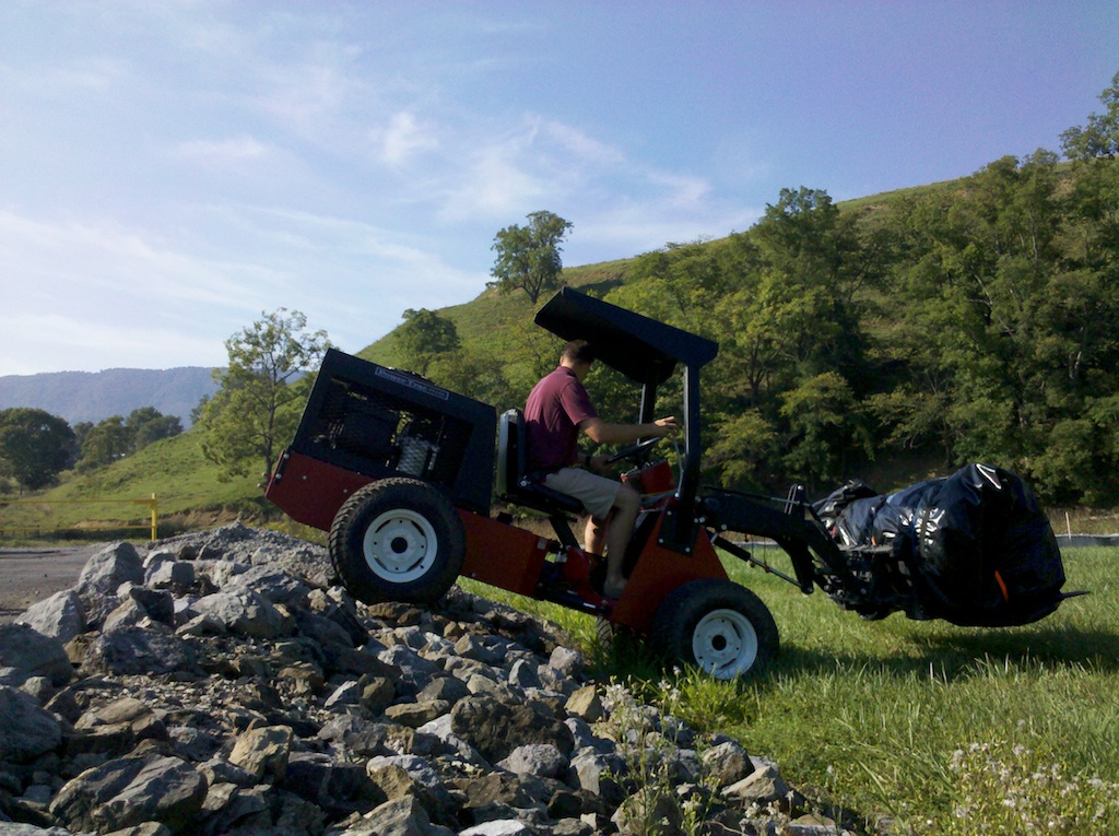

Here is a pic of me driving the 1430 at Tazewell with our 40 foot screen on the forks!

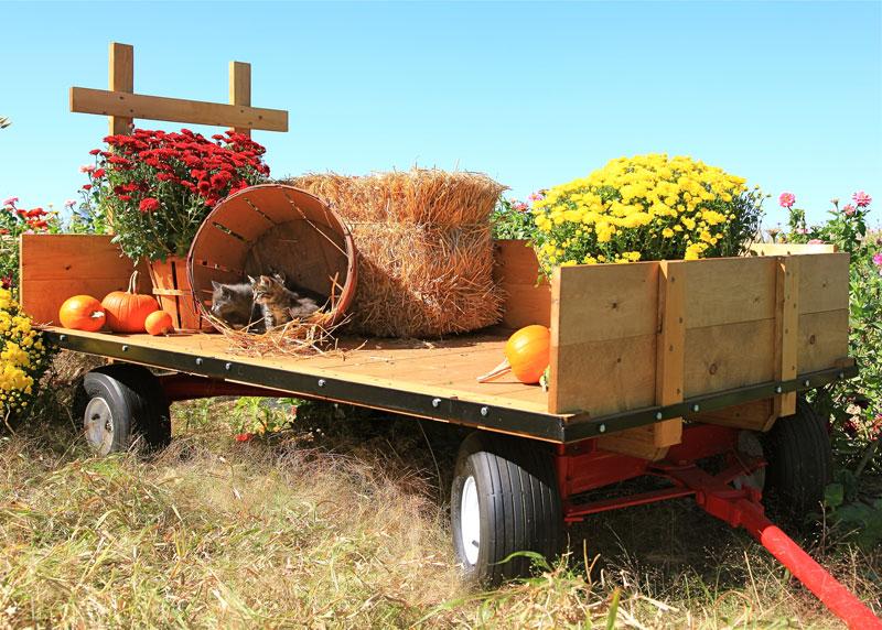

   / PT capabilities as an all-terrain fork lift #38
Hi Aaron,
The kind of wagon I was talking about was one with bigger tires like this:
I wouldn't think pulling that would rut more than the PT carrying a 700# load directly but I'm no expert either. My thought also was the better the ground conditions the more you could take in a single trip to the site. If it was soft then maybe only one pallet at a time, if it was firm maybe load 3 or 4 pallets at once. Actually, it could be the same road worthy trailer that you haul the PT to the site on that you would use to take the pallets to the off road location.

Thanks Aaron, I feel it will fit my needs!
Well, that's about as good a test as you can do.... take your equipment with you and see if their machine can handle it. Beautiful!

The problem with that or any other trailer is that you now have to move more weight with less weight on the drive wheels which in soft ground WILL lead to getting stuck and/or making ruts.
I would not use a trailer like that on the road regularly as they generally dont have brakes and they can have issues with tracking properly.
