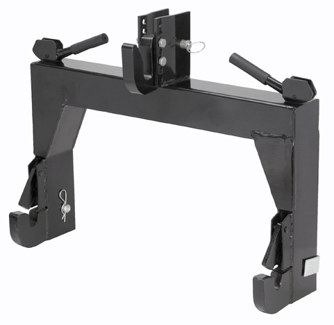

If you would use this attachment and attach a male PT plate, you could use PT attachments. If you attach a female PT plate to another 3ph unit, you could use 3ph stuff on a PT.
