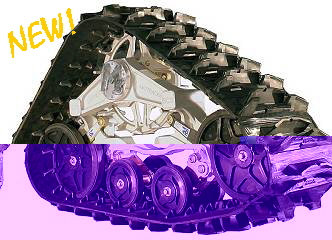

These probably aren't strong enough (being designed for ATVs) but should give you some ideas...
Introducing new LiteFoot M3 and M3 Ultra-Ride rubber track tread
These wouldn't even require the second set of wheels...

According to their web site I would lose 25-30% top end speed because of the gear reduction- so if the top speed for my 180 is 7 mph. that wouldn't work out to well plus the increased ground clearance might be a safety issue.

That loss was for a higher-RPM, higher-speed application on an ATV. Not sure you'd lose as much on a low-speed application. Also, usually when you lose top-end speed, you're trading it for low-end torque...
But, the challenge would be trying to sychronize the track speed with the speed of the front wheels...
