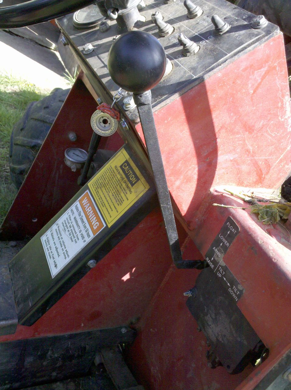

For simple ease and fast start, ask Terry to send you two new hoses. They'll have all the proper fittings, reducers, couplers, etc... and you'll be running as soon as you swap them. But you will be limited to one direction concrete mixing. Is that a bad thing? I do not know. Would you ever want it to rotate in the reverse direction? Can that help with unloading it. Big concrete trucks mix in one direction, then rotate in the other to dump it out. I've never seen a small mixer that rotates in both directions. My el-cheapo harbor freight electric mixer only rotates in one direction. I worked for a brick mason in high school ( a loooong time agoooo ) and his mixers only rotated in one direction.
With that said... think about a few things you can do with it being on the AUX PTO circuit instead of the MAIN PTO circuit. As one person mentioned, a bungee cord or clip for the AUX PTO handle could be fabricated pretty easily. That would allow you to rotate the mixer continuously with the parking brake on, and walk away. Also, being able to SLOWLY rotate and stop and start the drum while you are dumping might be useful in emptying it.
You won't be able to control speed very well with the MAIN PTO.
First, its 8gallon per minute flow while the AUX is much less.
Second, the MAIN PTO is either ON or OFF and if the engine is at a higher RPM when you flip that switch, WHAM! it goes and puts quite a shock on the system and can even stall the engine or engage the bypasses(with something like a mower).
So it may be advantageous to try it with the AUX PTO first and see some past threads on TBN about handles and locks that PT owners have made for their AUX PTO levers.
