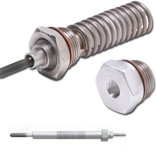

There are short heater coils that you can put in the intake manifold. Given where you are, I would highly recommend them. I'm told that they make a world of difference. Mine starts OK down to 35F; beyond that I have no PT experience.
Here's one; Deutz Manifold Glow Plug/Heater - 12V
If you are in the southern part of the state, I would recommend trying one, and seeing if it is enough, if not, you can always add a second one. If you are on the northern end, I would buy two to begin with. Either way, I would size the relay for it big enough for two heater coils. You turn on the heating coils for 2-10 seconds before cranking, and leave it on for a few minutes afterwards to keep the combustion air warm. (Keeps down the diesel going well.) You can also add a delay off relay to make it set and forget, if you want. e.g.
https://www.amazon.com/Timer-Delay-Relay-Hours-Cycling/dp/B00PD65UGA Let it control the relay for the heater coils.

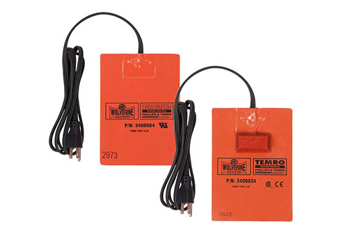

You can also get 110V oil heaters from Wolverine (now Phillips and Temro) that many here swear by. This has the additional advantage of not having pump cavitation from cold oil.
pad-warmer-1.jpgSilicone Pad Heaters - Phillips & Temro Industries
Tip: Get the paint on the oil tank really, really clean, or grind it off down to metal, and put it on.
View attachment 581833Silicone Pad Heaters - Phillips & Temro Industries

As many of you know, I worked at airports for about 6 years back in the late 70's/early 80's. We almost always used a propane powered pre-heater on all the piston engines below 30 degrees F. Several planes started using those types of electric pads on the oil pans. As I recall, they removed any paint and glued the pads on with some sort of epoxy, then touched up the paint. And, of course, since it said "AIRCRAFT" on it, they were quite expensive.
I recall one of the aircraft mechanics put one on his vehicle, too.

Ken S installed glows on his 1850 I believe. He is in upstate NY. And he says they work well. Nothing for deutz is cheap, FYI.
