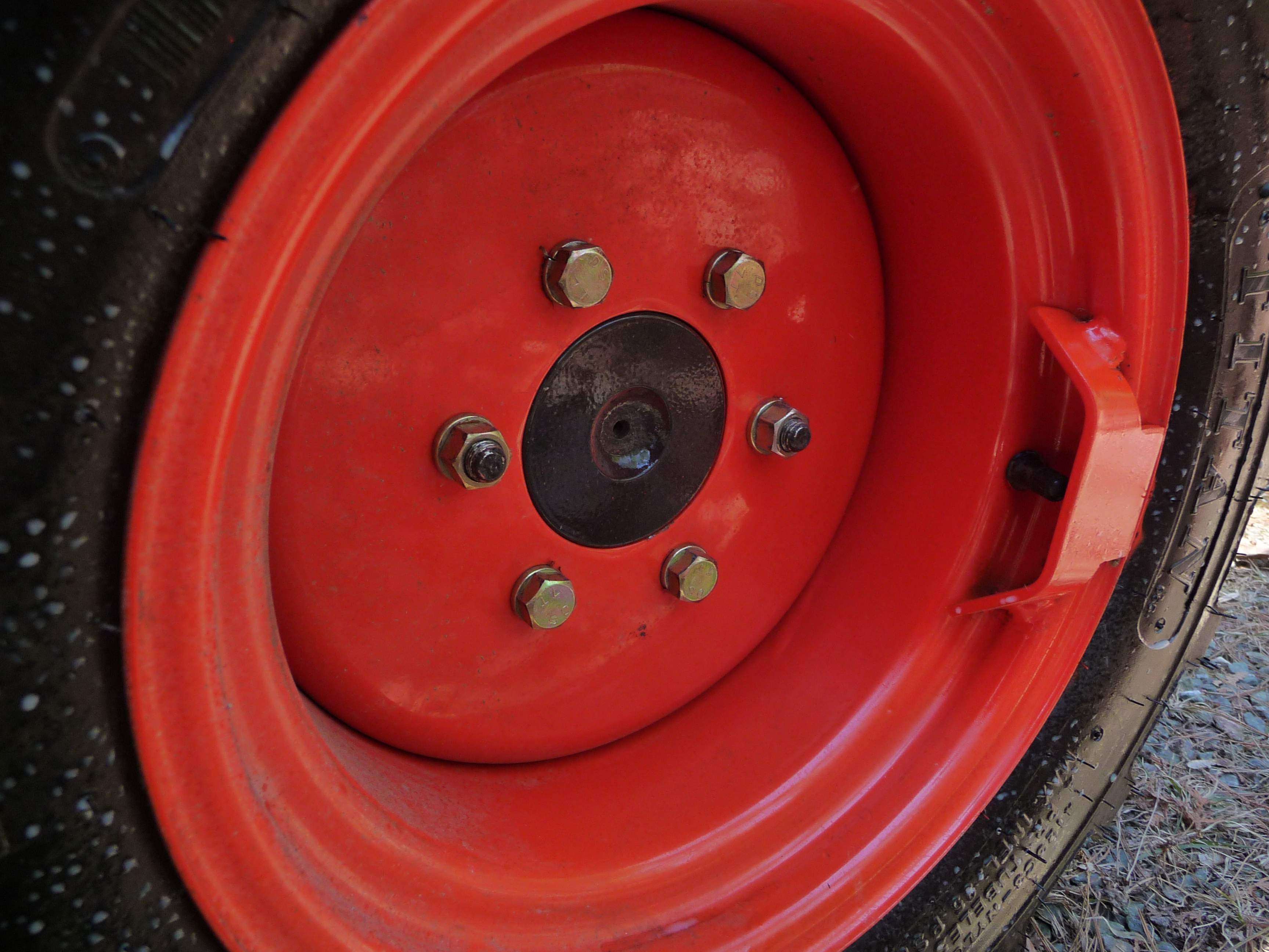

Hello RD!
I just came back from PEI / vacation!
Beautiful golfs with Rodd's resort! I saw a lot of JD over there! My system seems to work out well, just enough clearance for pressure gauge. Here a pic.
Best of luck - Phil
