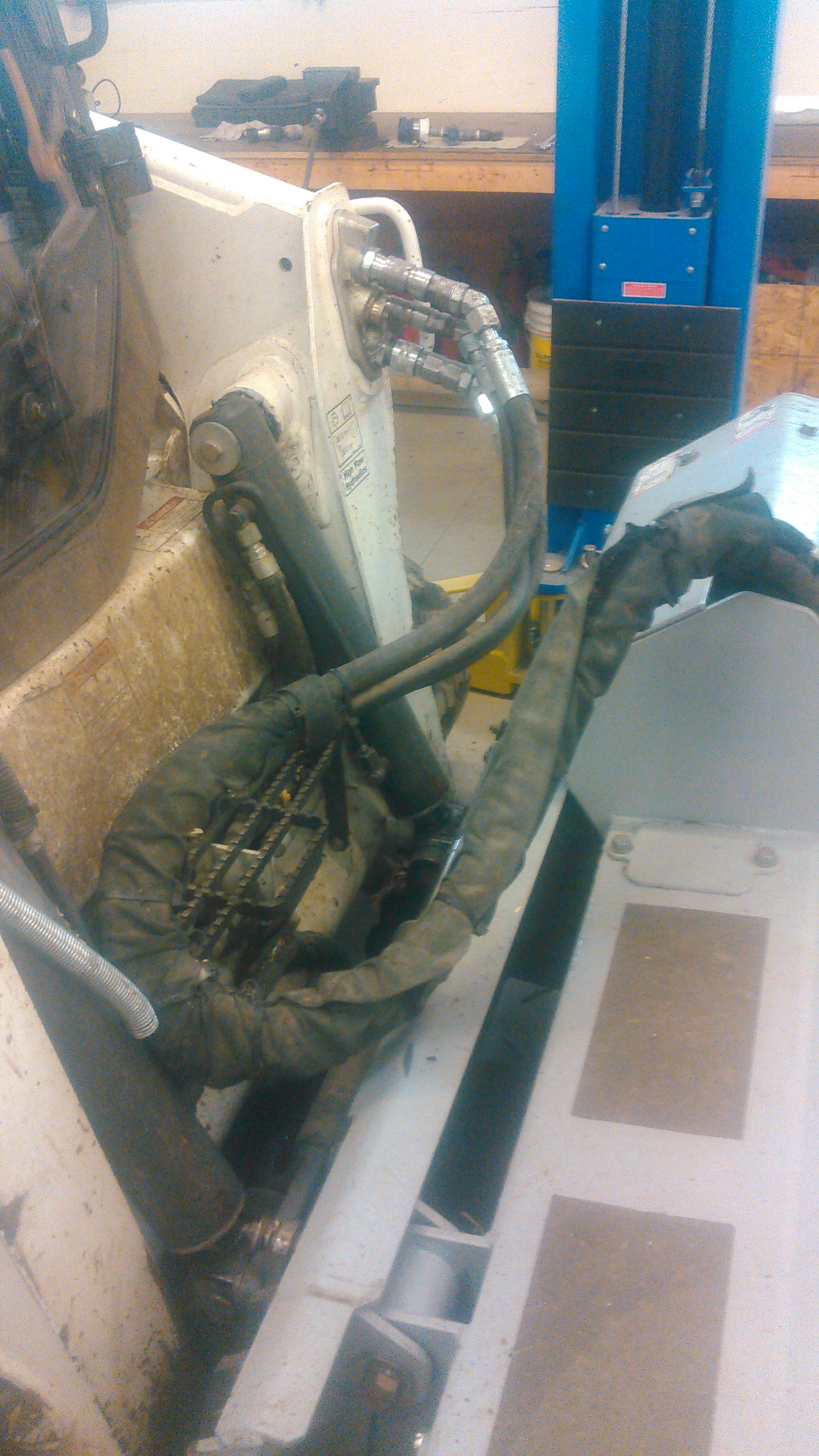

Hello all-
Running a diamond mulcher and cat 415c and have already changed several lines from material punching thru the lines. I have tried locating the lines out of the way with rubber bungies but they dont stay in place. The canvas sheaths are being punched right thru.
Ive seen the spiral wraps, but cant a stick punch thru an opening since they're not solid....
And ive seen solid drain hose being used....but again i wouldn't think impenetrable? Looking for some input....

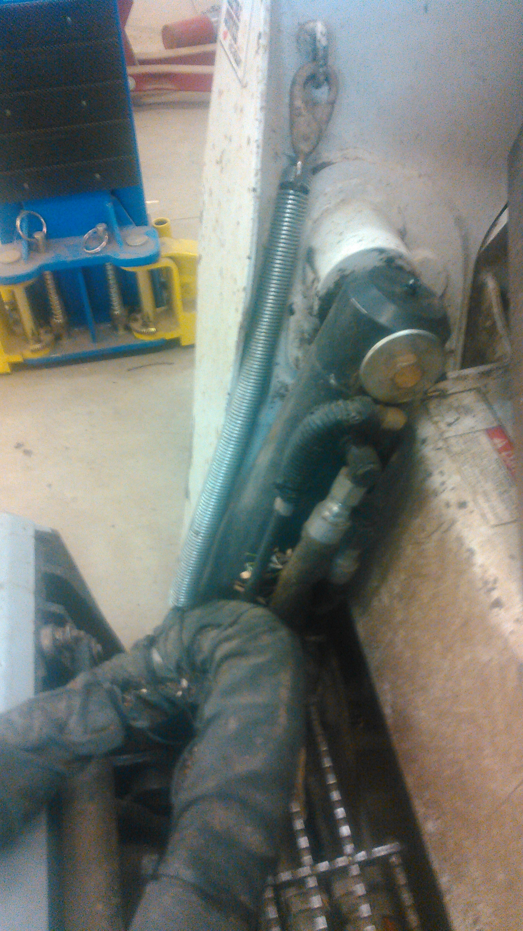

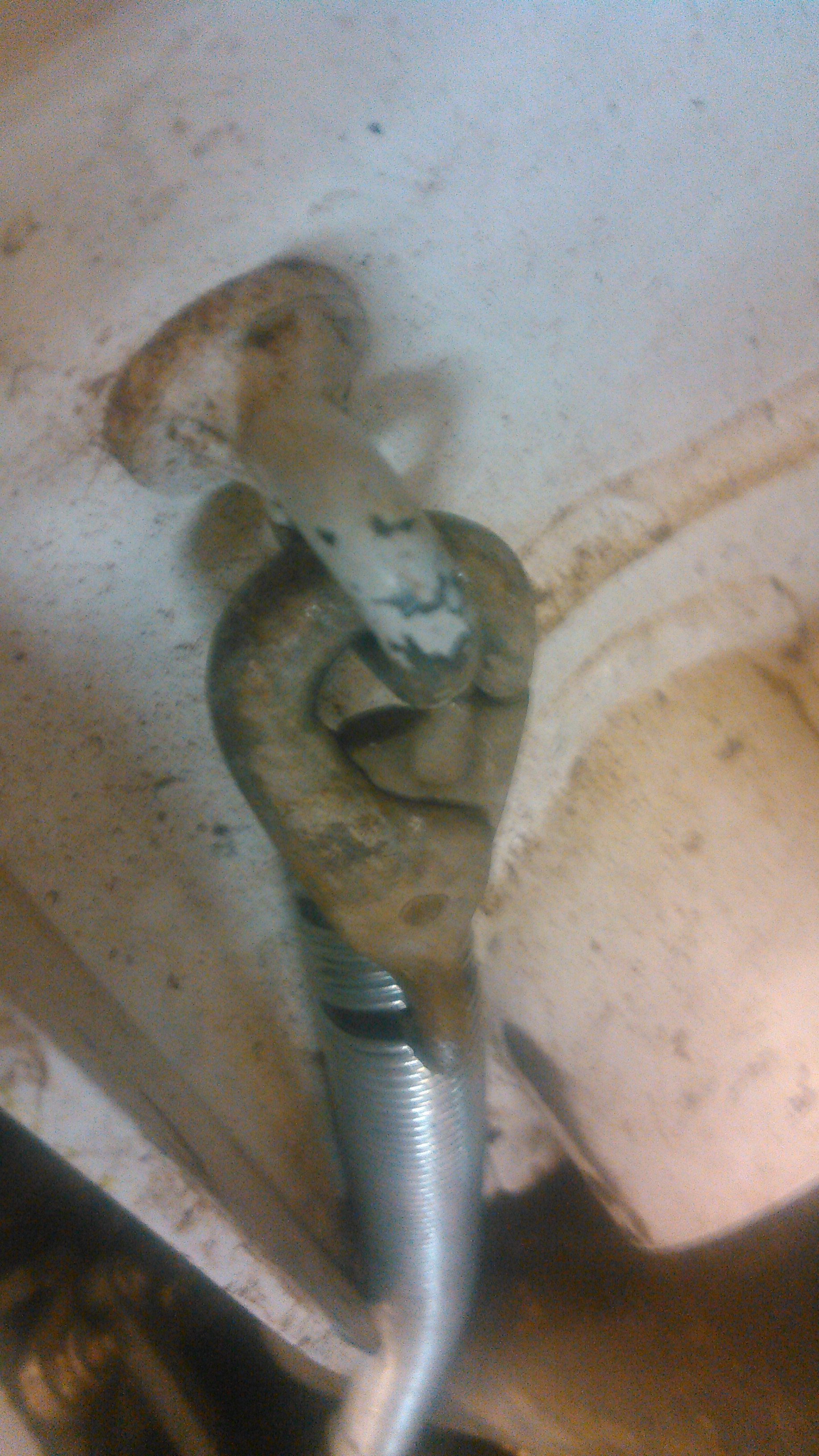

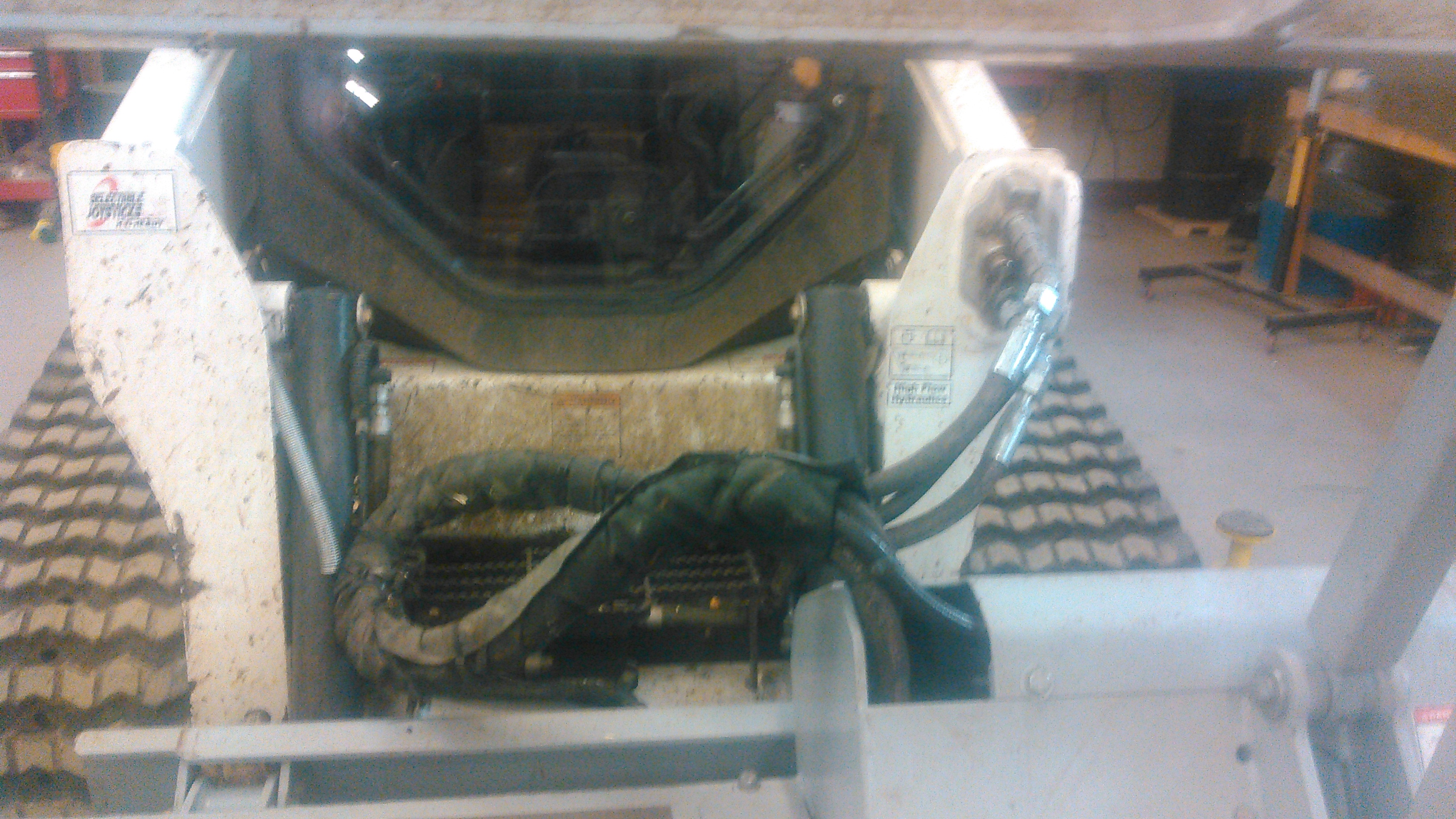

I am running a Cimaf head and am using a canvas sheath and 45 degree on the fitting. as you can see in the pics I am using a gate spring from HD attached to the other arm. I have not had any line problems for the last 2 years. You have to watch that you don't get too much between the head and the arms, but with a little practice you can clear it easly. The attachment point on the other arm for the spring is a chain link welded to a piece of all thread. Bobcat has a hole in the arm at that point.
View attachment 675550View attachment 675551View attachment 675552View attachment 675553
Same as you, but I welded a hook to the crossbar on the Cimaf and hooked the spring there. No chance of pinching the hose.
