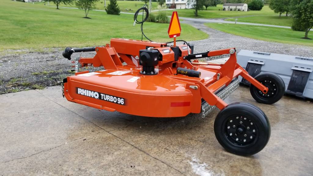

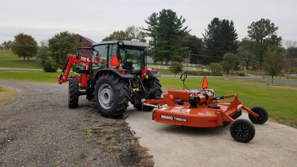

I like a pull type. Its mows better with less scalping as it follows better. Also, you can back it under trees easily. I use a rear mounts camera. Works awesome. Only disadvantage is crossing ditches. Much better on slopes. Pull type is also easier to hook up and can be moved around with a pickup truck if necessary. 20181026_120043.jpeg20180911_172837.jpeg
