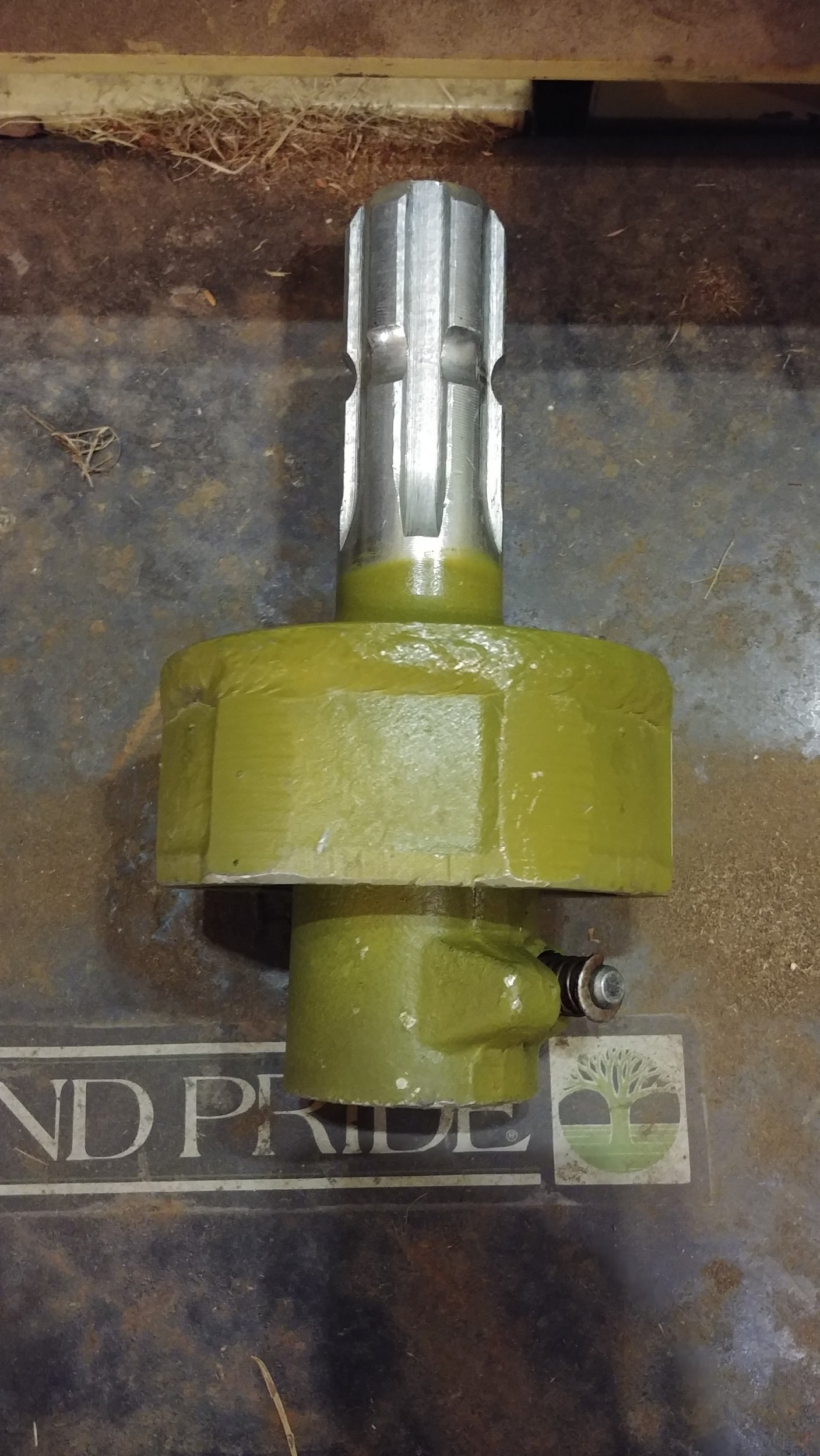

I found an overrun coupler here locally and will post some pictures when I have a chance.

Here is a photo of the one I picked up. Supposed to be good for up to 70 hp. Have not had a chance to use and test it yet since mowing season is over in this neck of the woods. Hope it serves me well and does the trick.
