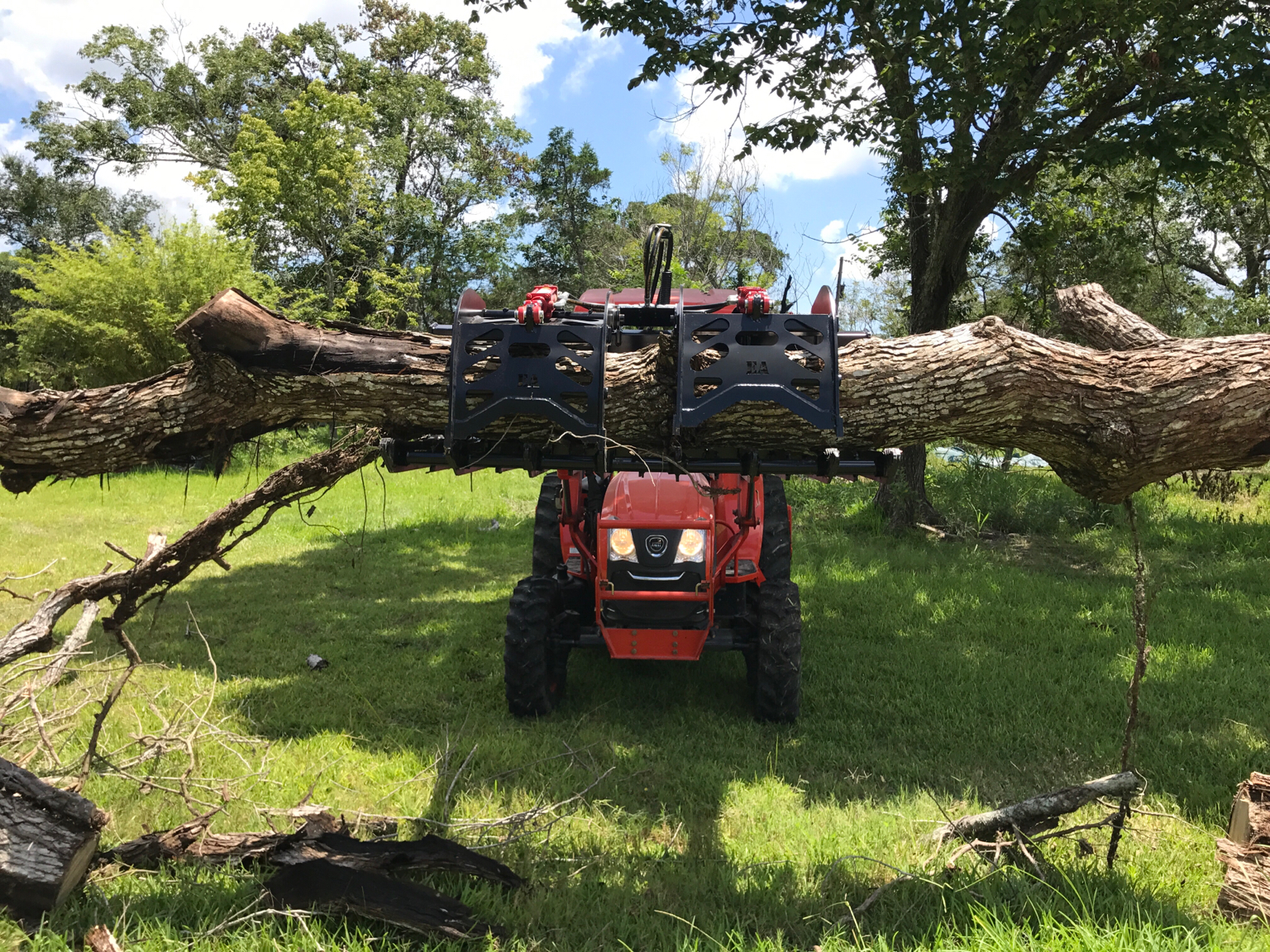

That's why I was upset. If I can find it I will post a picture. You will see what I mean it was a little pile. I think the second one snapped because all the weight went to the one side. What was crazy was they both snapped at the same place on the shaft. It wasn't like one was higher or lower on the shaft, they were both snapped in the exact same place.

Dk35vince I had a small pile of brush. I went to grapple and then I seen hydro oil blowing out. Got out to look and seen the shaft broke and fell out of the cylinder. Then I got back into machine and went to try and move the loader down and the other shaft broke and fell out and the grappler came crashing down. It was a$1000 bill to replace both with no help from dealer or kioti. Sad is the dealer and kioti both admitted they have never seen that. I had the pictures on my old cell. If I can find them I will post them
