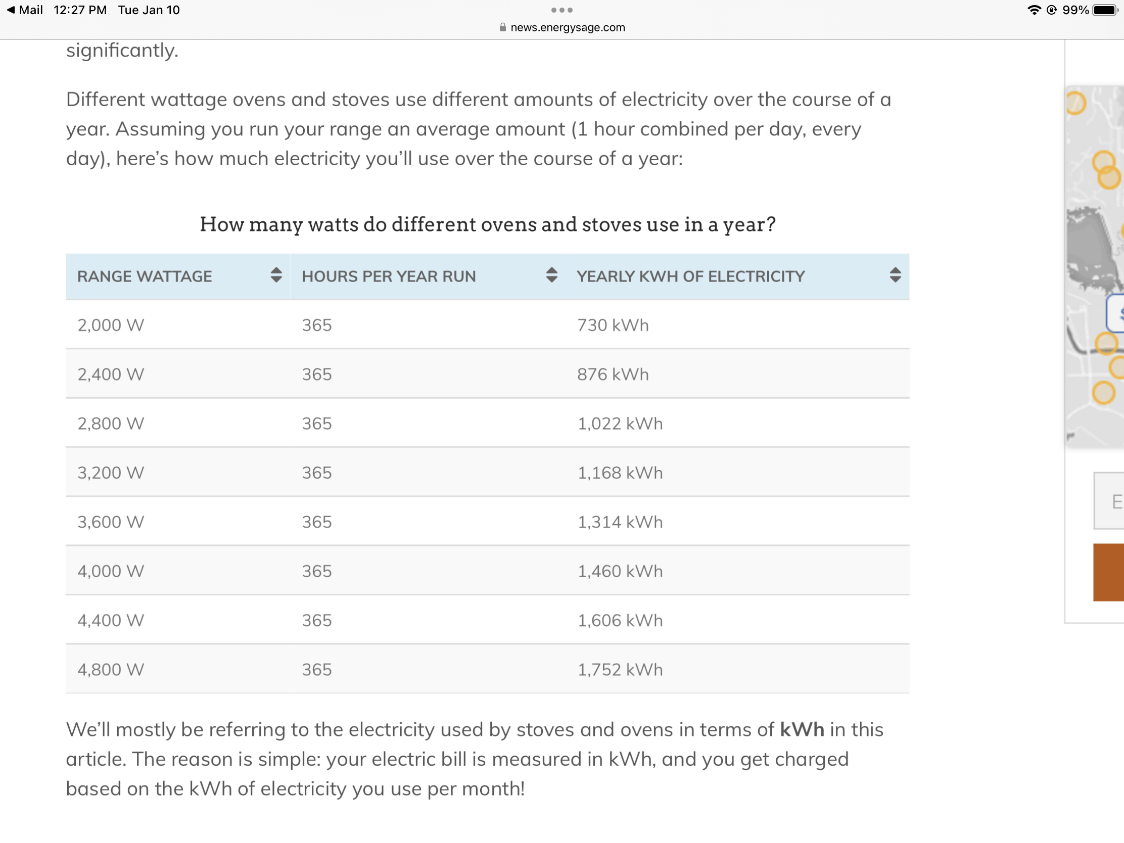

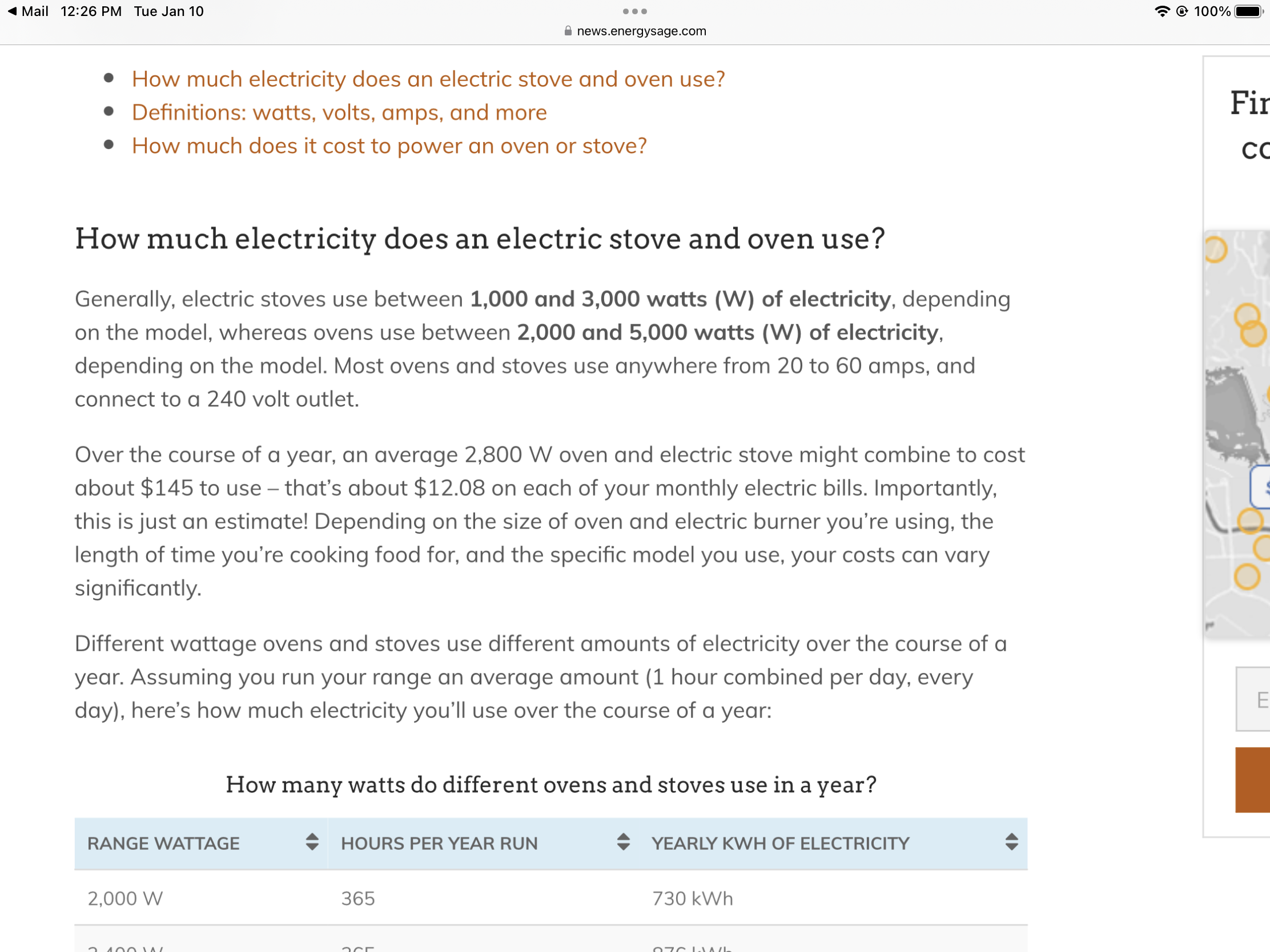

Okay, just did some quick research. I'm seeing one quote for 35%, which is more than I had suspected. I'd believe that another source may be as high as 50%, although I didn't see it myself, there's always a lot of error and bias in these estimates.
I also pulled up the circuit utilization of our all-electric range, and I see we put 17 - 25 kWh on that circuit every month. My wife cooks on that stove/oven at least 6 dinners per week, as well as occasional lunches. Our household usage is about 3000 kWh per month, so the electric range makes up about 0.7% of our household usage. Our primary heat is wood and oil, so the fraction would be smaller if we were the more typical heatpump household.
Based on these numbers, we'd expect the increased hit to the grid would be less than 0.35 x .007 = 0.25% of current usage, if every owner of a gas stove instantly threw theirs in the garbage, and switched to an electric range. Not a lot, even if it's mostly at peak hours.
Someone please check my math on this, as it seems low to me. I honestly expected the numbers to be bigger than that.
Heres the numbers from a electric stove manufacturer
