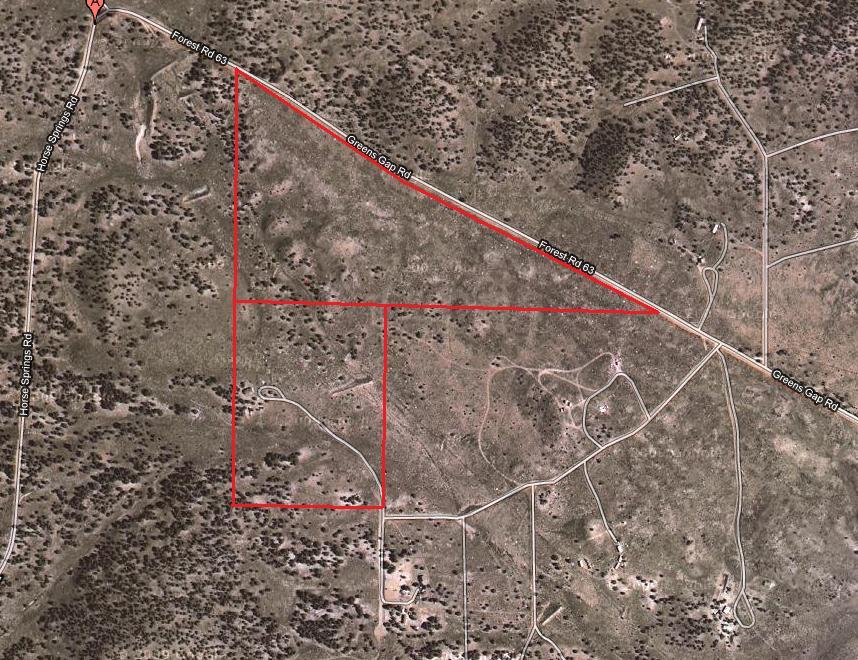

I want to install a metal pipe fence around my 40 acres. The pipe will only be used for the corners and T-post and barbed wire in between.
So how do I dig a hole and set my pipe if there is a survey pin in the corner? I know the pin must be left alone. I am guessing I will have to set the pipe on my side of the pin. None of my current neighbors have any fence up.

Yes the Pins are the property line for sure. It was originally a square mile that was divided up in to 24 pieces and mine is 40 acres. One surveyor did the whole place a few years back when it was divided and nothing has changed.
My piece is a triangle with a county road on one side. State property on another side, and my uncle and some other person on the third side.
I am only wanting to fence the road side and the other side between the other guy that is a less than a good neighbor.
The piece where the 3 of our land meets will be easy I can just straddle the pin with the pipe. The other two corners along the road is where I will have to move it a bit. I figure I can plant a 45 corner with the corner on the county road side just inside the pin to my side. And the other two ends of the 45 will land on the line and be on the line from there on out.
