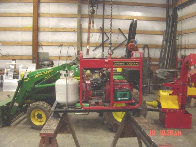

About 12-years ago I bought a 10,000-watt generator, bought an after market propane conversion kit, I can run it on the 20-lb bottles or the 300-lb tank out front.
If I wanted a welder / generator combination I would buy one of these. A very good friend of mine has the non propane version, fantastic welder!

That is exactly what I did. Mine's not trailer mounted, but I can easily move it with the front end loader. It is a Lincoln gas machine that I converted for bifuel operation. True that LPG has about 75% of the energy content of gasoline, but I haven't noticed a big difference when using it as a generator. I tapped the LP line behind my shop where my transfer switch is also. I can run for several days on 500 gal of LP. I live on the Texas coast and during hurricane power outages gasoline can be hard to come by. LP has been much easier to get.
A machine thats LP from the start will give you full power because the engine is sized for LP use. But your limited to only using LP. With the conversion kit, you can swap back to gas for any remote welding job. I haven't regretted it for one second.

I've never had any problems with switching back and forth. In fact, I've heard that you need to run on gasoline now & then to keep the o-rings & seals from drying out. who knows.
The LP enters at a venturi that is installed at the opening of the carb. My smaller generator (5500w) has no problems pulling off a 30# cylinder, but the welder/generator (10,000w 20hp) wont. The LP cylinders have an excess flow check valve that shuts off.
