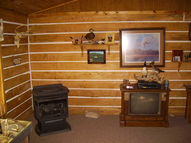

Your cabin looks large for the only heat to be a gas fireplace! Do you have a blower on it? How long do you get out of a 100lb tank? My cabin is 12' X 20', uninsulated dutch barn style.
My cabin is 28 X 36, one large living room/kitchen area, two bedrooms and one bath. The propane fireplace is in the large living area, pic attached. I have electric space heaters to augment the propane fireplace. I do not leave it on overnight because too much moisture builds up. I probably use only about 1.5-2 100 lb. cylinders per winter. Of course it is only a weekend place, and I probably average being there every other weekend in the winter.

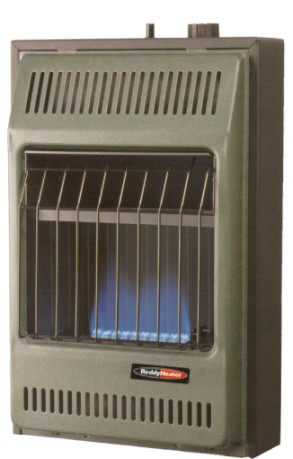

Update: installed the Reddy Heater Outdoorsman and used it the other night....great unit! Warm, quiet, no odor, heat for the cabin. Running on medium, kept my uninsulated cabin 20 degrees above outside temp. Used about 1/3 of a 20lb tank in 12 hours. Have it on a 30lb tank now. Highly recommended. Picture is from web site, not my install, I'll post that later. Really like the blue flame as opposed to red hot infrared type heater that started this thread.

That is exactly the one I have in my cabin, couldn't remember the name.

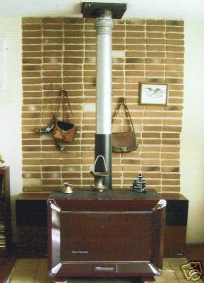

I have a 26 x 26 with 16 x 26 second floor (5 rooms total) in northern NH. Heat it with a Warn Morning vented propane heater. Has a blower but heats by convection if power is out. I probably use 500 gallons of propane a year but heat goes on in Oct & off in mid April. Can get to -50F in Jan & Feb, often -30F. Heat to 68F 7/24 but use wood when we're there every other weekend. It's an older heater, like one on Ebay ending today in NJ, pic attached. Mine has glass front so you can see the flame. Absolutely reliable & virtually maintenance free with or without electricity.
As for kerosene heaters, run a damp cloth around ceilings & woodwork after a few days use & you'll see just how clean they burn. OK for occasional use in a shop but not where you live. MikeD74T

very good choice. That's why I mentioned the blue flame over the radiant. In my opinion, they are safer because of the glass over the flame
