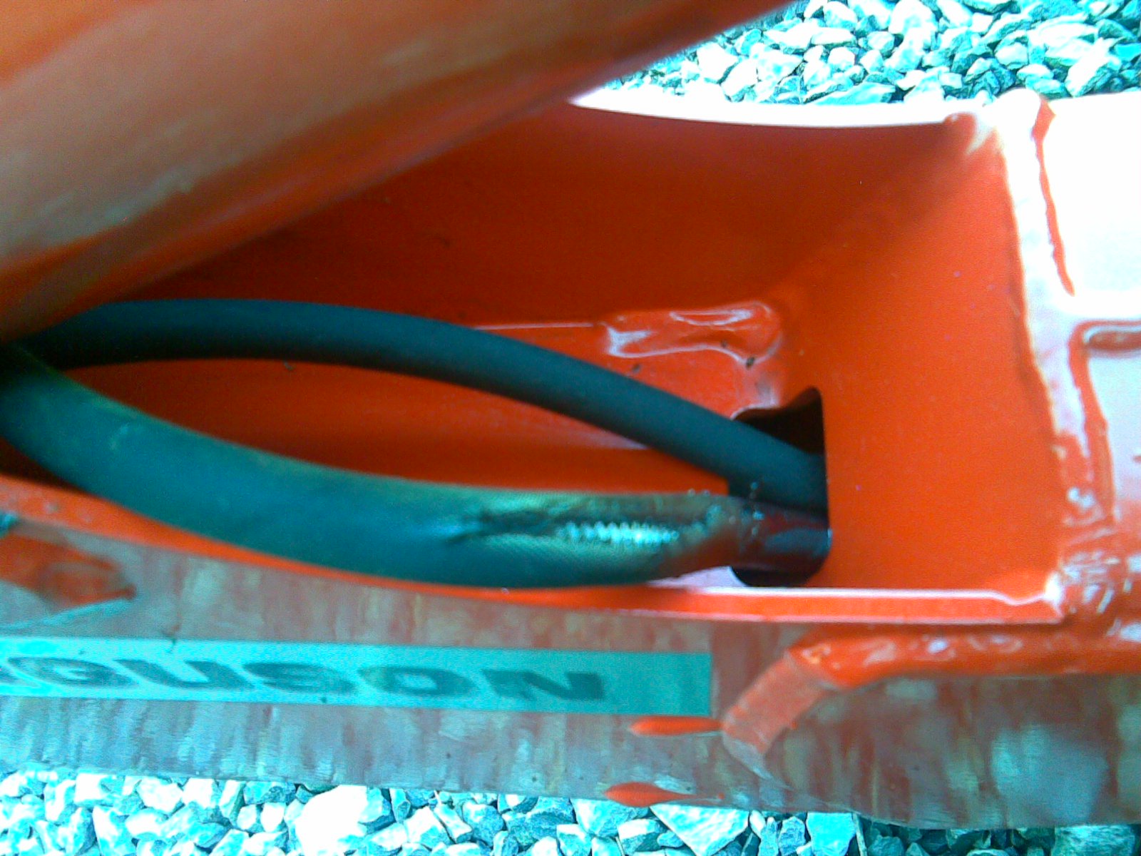

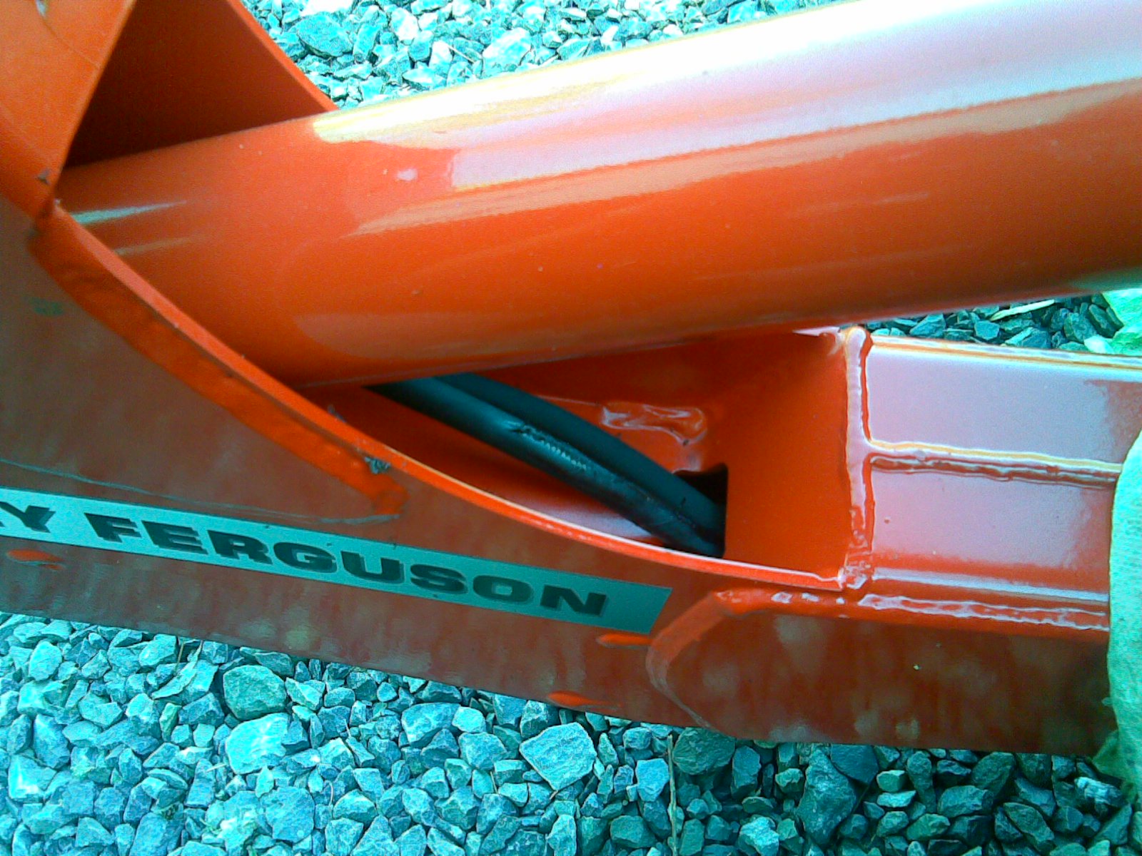

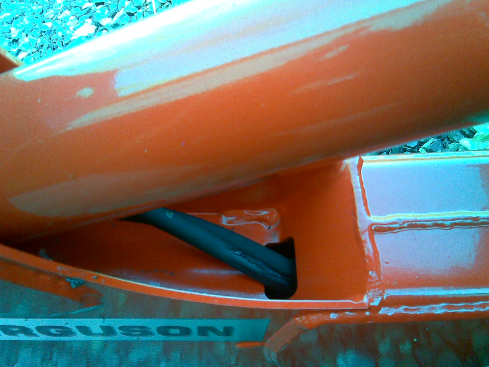

I love my new tractor, but experienced my first problem this past weekend. A hydraulic hose on the main boom for the backhoe burst, sending hydraulic fluid into my face. It appears that this is a design flaw, as there is nothing to protect the hoses as they past out of the boom. (See Photos). I called my dealer, who is sending new hoses, but I believe that I need to make a grommet to protect them. Any ideas. Thanks

Yes, Find some good thick hose and slice it and slip it over the edge of the metal. They also make hose wrap.
You could also unhook the hoses, and use a thick two in hose or radiator hose as sleeve and secure it at the edge of the metal, then reconnect the hoses. Rounding off the metal might be OK. Some tire rubber glued in place.
/ Problems with new backhoe on GC 2610 #3
Ouch!! Like JJ suggested-- I did the same on my 2310 in a couple of spots where I could see problems might develop-- use a good, heavy/hard hose to go around the hydraulic lines as they go through the hole. I also wonder if it would be worthwhile to file the metal just a tad to round/enlarge the hole out a bit. Sure does look like a design boo-boo to me!
Just wanted to give everyone an update. While installing my new hoses, I found that the orginal "blown" hose did not have the right amount of slack in it to allow the main boom to extend. The extra length of hose was in the control box. When installing the new hoses, I simply left more slack at the main boom jack and now have no rubbing problems.

You can also route the hoses thru the boom instead of on top of the boom.
Yea, but you got to bring them out to hook up to the jacks and that's where the problem was. Thanks

In responding to "frank1213" questions, I forgot to mention, that I pulled into one of the hoses going to the outriggers apart a few weeks ago. While changing the hose, I found that Massey used two 4ft hoses to each outrigger and used zipties to control the lenght of the hoses. This is where the problem lies. While transporting the backhoe or for any other reason that it remains on the tractor for any amount of time, these zipties are subjected to the regular vibrations off the tractor. This in time could cause the zipties to slide, causing the hose to be to short when you try to lower the outrigger, causing the hose to pull into. When I changed the hose, I did not use zipties, just rerouted the hose. I also clipped the zipties from the other side to eliminate any future problems. Obviously, Massey did not put this backhoe through a rigorous test session, prior to shipment, or these problems would have or should have been corrected, prior to shipment.

I found on mine that the cylinder hoes connector point was pinching the the hoses in the tray. I used a die grinder to make to opening a little larger and made some "U" brackets to hole the hose in place along the outside walls. Has done the trick for mine.
/ Problems with new backhoe on GC 2610 #14
Rob,
A friend of mine has a 2410 and had the same problem. You need to re-route those 2 hoses. Pull them out of that small opening on the boom and re-route them inside the boom, it'll eliminate the problem you are having. My buddy said Massey had a service bulletin out on this problem (over a year ago now), see if your dealer can get you a copy of it. He hasn't had a problem since. Good luck!

Thanks, I finally got the service bulletin from another dealer and fixed the problem. I just wish Massey would send an email or notice directly to the owners and let them know of these things.
