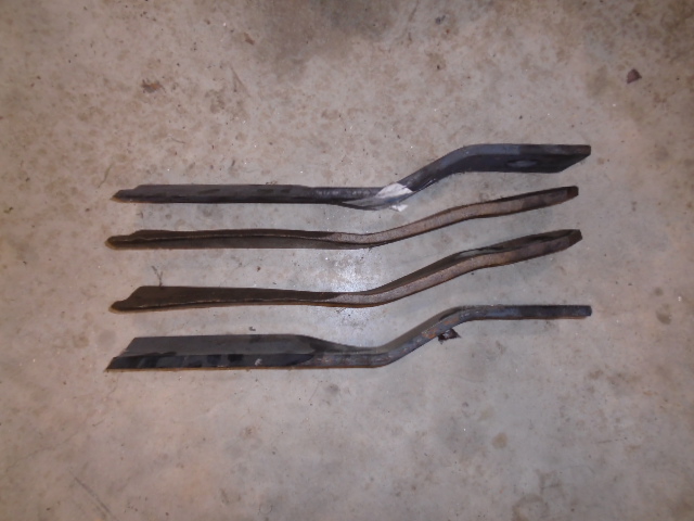

Wow, those were really bent up! LD1's blades look like they are still in good condition, with the cutting edges hanging level.
LD1, how much rake do you usually have? With your experience I'm assuming you've experienced with the amount of rake already.
   / Problems with my new Bush Hog 3008 #32
Those actually look like what they call "uplift"
Looks like behind where it is sharpened, the blade gives a little upward curve. But pic could be deceiving.
And for that cutter, I think the "flat" blades are actually double edge. I am looking at getting bushhog part number 86666. Seems I can find them for ~35 a blade. And woods wants $140/pair. Dimensions are the same nearest I can tell. Mine measure 20-1/4" long, 17-3/4" from hole center to tip, 1.5" hole, and 2" offset. Only difference I see is my woods blades are either 3/8 or 7/16" thick and the bushhog are 1/2".

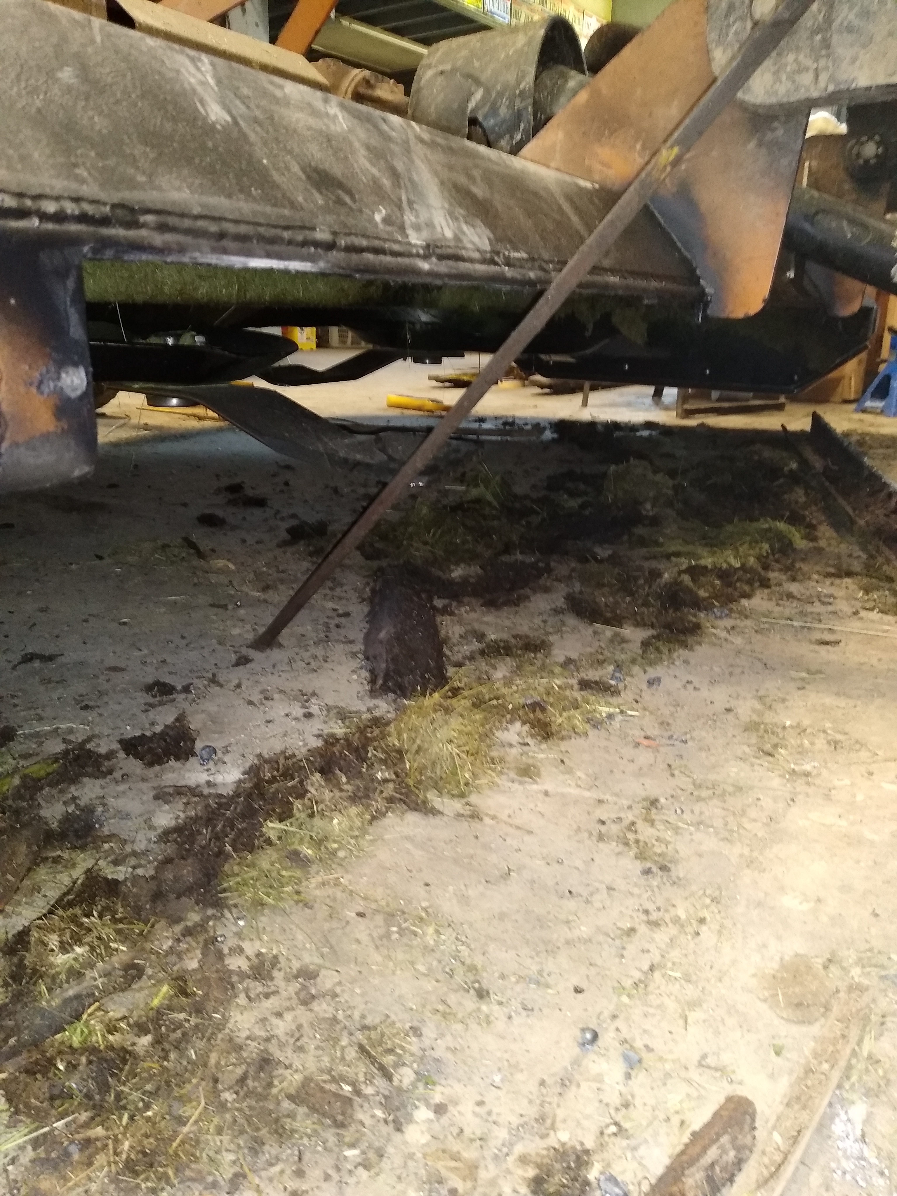

Dont know the exacts, I can measure this afternoon, but there is only about 6" between the blades and the deck bottom.
And that piece I cut off, was 3". And it was a few inches forward of the blades even, when the blades were at their closest to the front of the deck.
SO basically having a piece of metal.....in FRONT of the cutting path.....laying weeds down. And that piece of metal was only 3" above the cutting height of the blade.
Now I have 6" of so

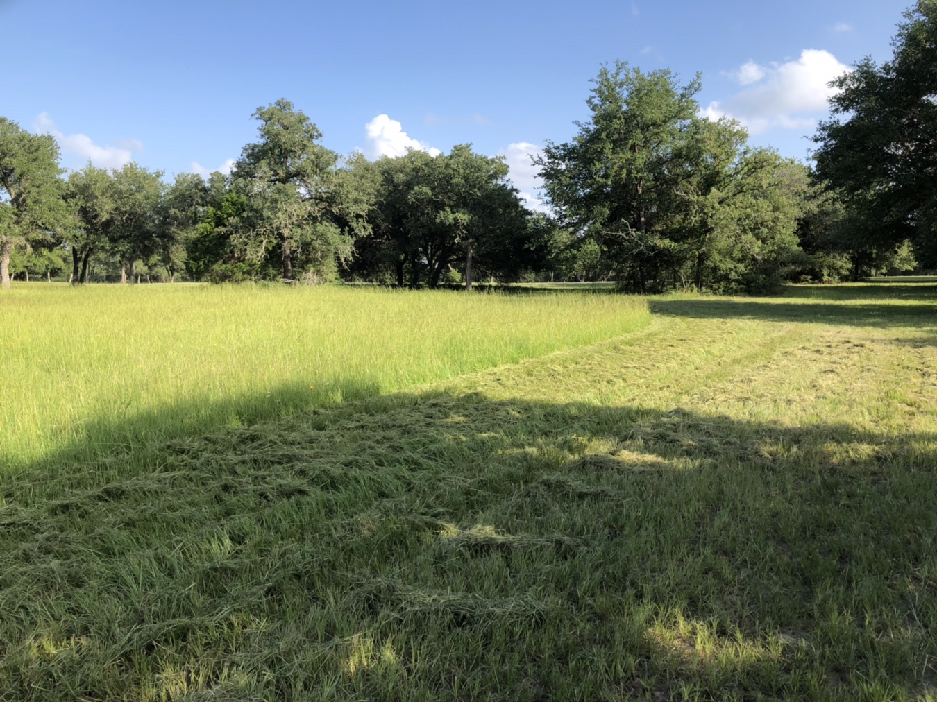

This is the before and after difference of how much the weeds will be laid over.
That is my usual mow height. 6.75" and 8.5" in back

I'm interested in your results LD1. That looks like it should do the trick! I've got a DS96 too and in tall stem johnson grass it doesn't do very well. I have to double cut some places. I took this video just after sharpening my blades. The weeds are taller than the deck is long and so the stems don't have a chance to come back up. This clip is fast forwarded to a spot that shows I had to do a triple cut. I don't cut for the public, but it's still annoying to have to go over an area twice.

Hey, you really got right on it! Good pics. Good job.
Its going to work. Youve touched on about every pertinent parameter here. The part I bolded causes a varying effect as you know, since the front is flat/straight, and not instead contoured to approximate the blade arc. - - I have no experience with multispindle. My only long term experience is with an old 5' JD which is contoured with 3 angles and therefore presents more equal layover across the cut path. Blade setback from the front edge is only 1" in the middle and doesnt increase a lot until out near full cut width.
- - With your front skirt essentially removed that varying effect might fall into the noise and be undetectable even with the straight across front.
Ill be interested in hearing how it works out, and also whether front ricochets become any problem

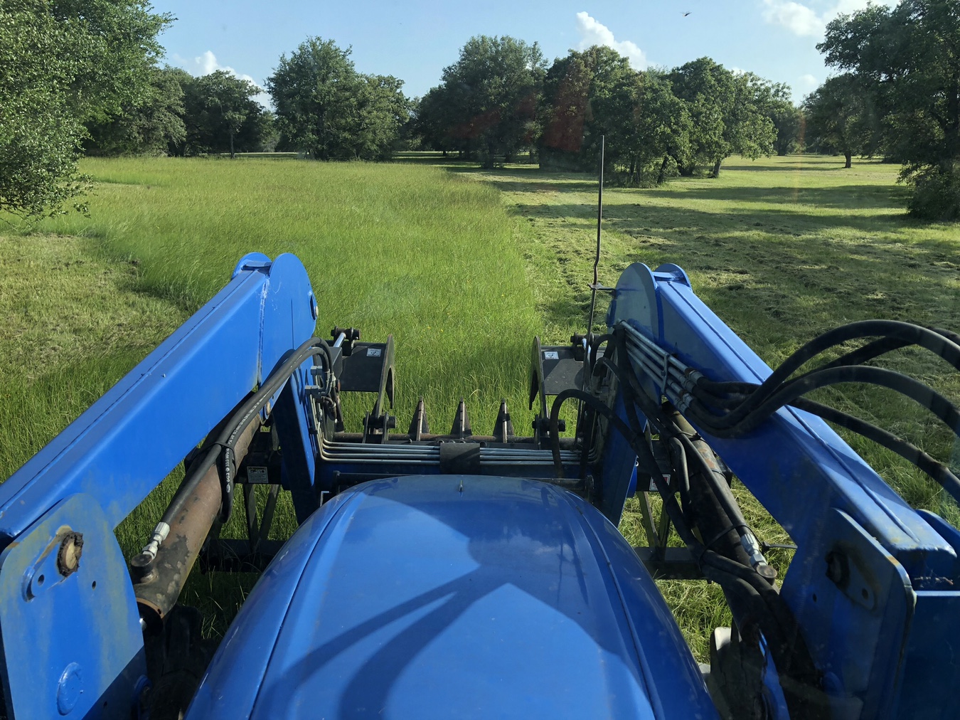

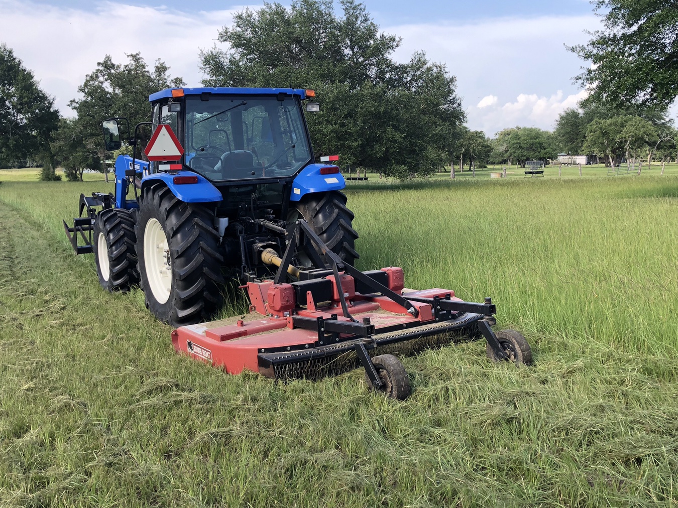

My BH 3008 is about 10 years old and probably 350-400 hours on it. I touched up my blades with a grinder about 100 hours ago. It's cuts just fine. This is tall Bahia grass, running in Range II 2nd gear.
The rear of the deck is set about 3" higher than the front.
It cuts the same forward or reverse.

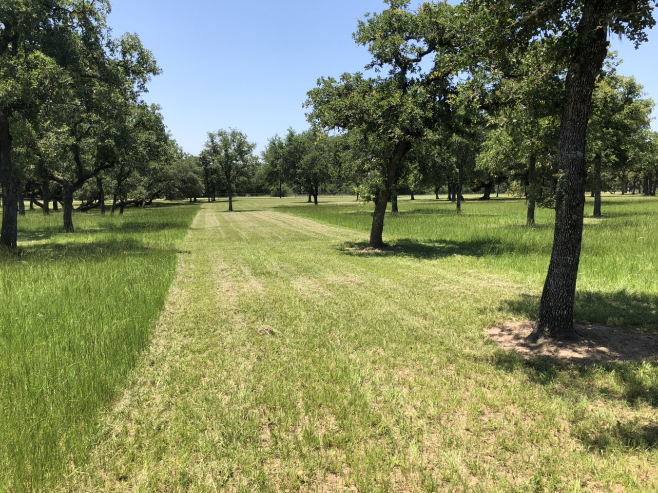

For comparison here is Bahia in our 9 acre "yard", not quite as tall as the above pasture, cut with my 84" rear finish mower.
