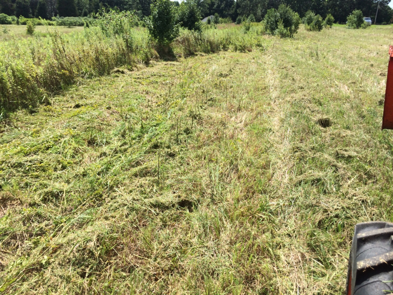

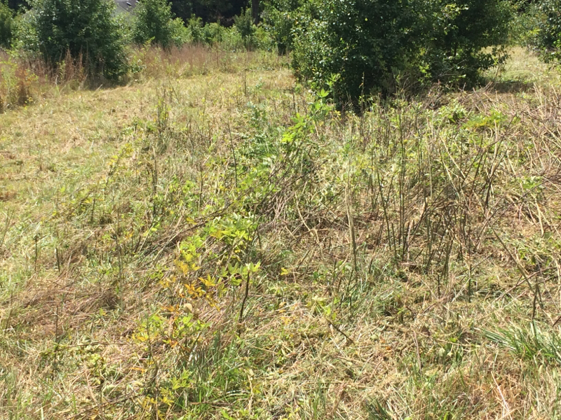

To set the stage I do some mowing for the public. I recently upgraded to a Kubota M7040 back last November and have slowly been upgrading my attachments as I could afford to. I sold my JD 390 flail and bought a new 8' BH 3008 twin spindle cutter. I was really excited about the purchase, having read nothing but good reviews on here, online sites, and at every dealer I called or visited. I eventually sucked it up and plunked down the cash. The first cutter had a gearbox with a bad vibe so it went back. I took the second cutter immediately to the field for a 18 acre job. Usually I can run my 6' cutter 5-7mph and leave a good cut. I expected the same from the 3008, NOT so. It cuts pretty hard but the m7040 has plenty of power although fuel consumption went up 20%. The cut quality is terrible on tall grass, weeds, and briars. It basically strips the leaves and leaves the stalks. On more "stemmy" material like Johnson grass, thistle, or milkweed it will leave about 50% of the material behind.

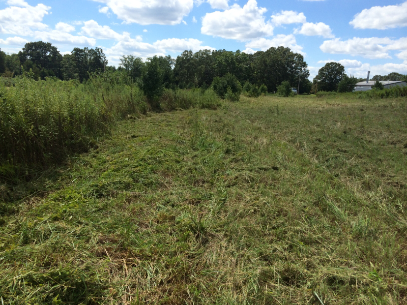

I contacted the dealer to which he of course recommend to drop down to L2, literally 2.1 mph. It cut better but not great and no one can mow that slow especially if you are trying to make money. I tried L3,L4, and H1 gears. Ranging from 3.0 mph- 5.0mph which coincidently is what it's manual recommends. All produced a similar result, of course getting slightly worse with ground speed. The odd thing was if you mow in reverse (same speed) it cuts awesome and leaves little behind, which is the way I cut the "tough" areas.
I called the dealer again today after another job and supposedly a BH rep will be calling me. We'll see. Here are some briars it missed image-289238998.jpg Left side I mowed in reverse, right side in forward image-1539195493.jpg

I run a BH 3008 on my 7040 same setup as yours. From the photos, I believe you have a 1000rpm bush hog on your 540rpm PTO. My 3008 with worn blades cuts almost finish mower quality on field grasses and light brush/briars. It builds a tall wind row in the center that leaves lasting stripes on a pasture.

you do have a slip clutch, and you most likely need to burn yours in (remove the varnish) off the plates. (get the slip clutch to smoke) and then you most likely need to set it correctly as well.

was the blades installed correctly? they are not backwards or upside down are they?
i am guessing with a 2 spindle single deck, one turns counter clock wise, while other turns clockwise, who installed the blades? if it was an actual person, vs machine, i know i could have easily "whoops"
pull the PTO shaft off of tractor, and turn the PTO shaft manually, and see what way the spindles rotate. did they give you 2 clock wise, or 2 counter clock wise gear boxes on the spindles?
i guess last few sentences i should of ask first... if the blades overlap in the center like a finishing mower deck does? if they don't it really doesn't matter what way they spin. as long as cutting edge is in correct direction on blade, and you know you might have a little trail of uncut between the 2 blades.

Looks like your ground speed is too fast for your blade tip speed...
If you are running @ 540 check to see if the input shaft for your mower is 540 also...
Our Howse 10' BH has a 1000 pto input going into the main gearbox but we are running it at 540 from the tractor...
You will need to turn more revs and slow down to get the blade tip speed higher to get a better cut...

I'm still curious why it cuts great in reverse? What's the deal with that?
On second thought - maybe it's because you're moving dead slow.
   / Problems with my new Bush Hog 3008
#9
Thats my question too. Every cutter I've ever had cuts worse in reverse.
