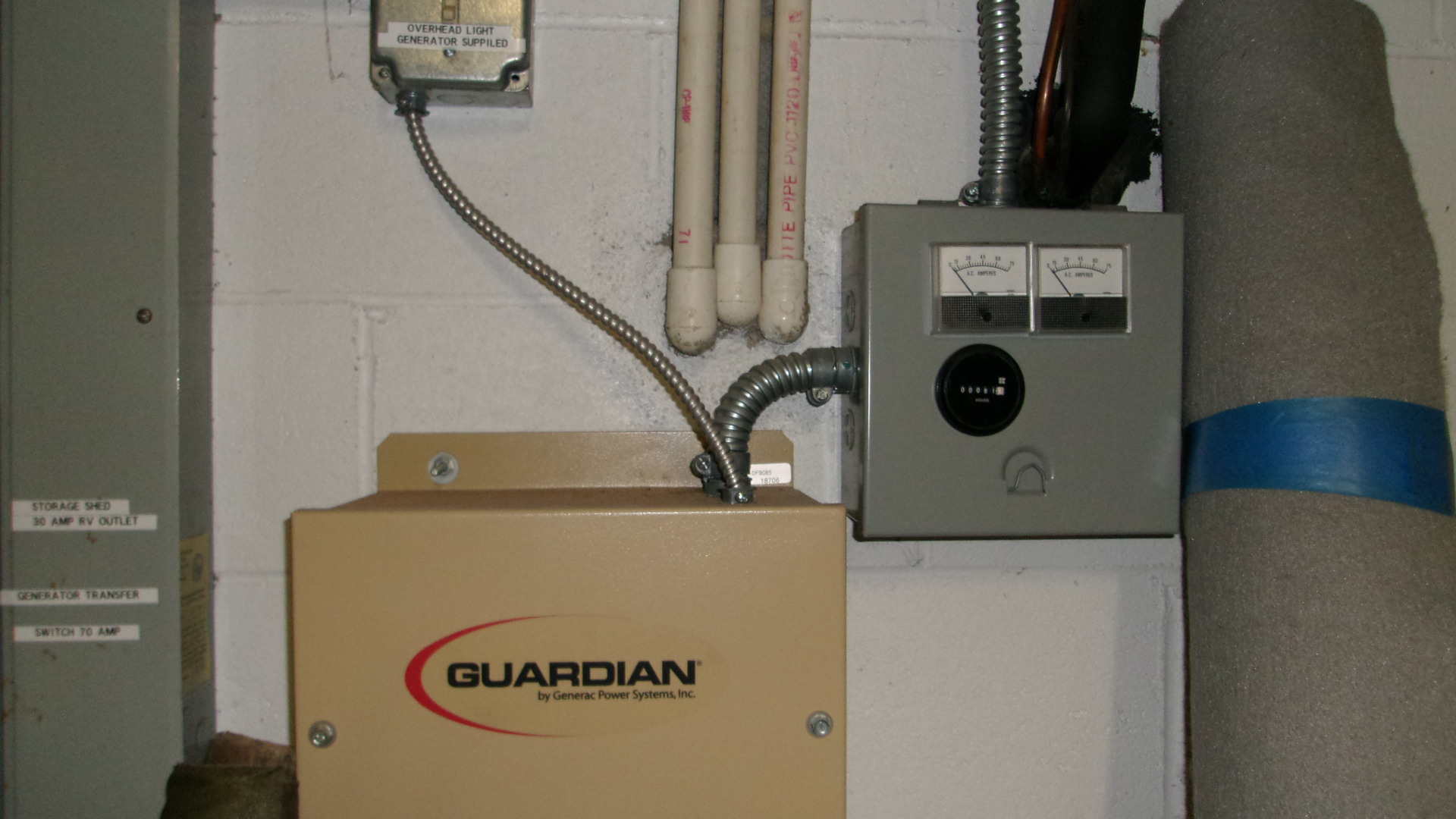

I had a the same type problem on my RV LP generator, ended up being the regulator. Partsfortechs.com has good prices on generator parts. I also have the same whole house Generac as you do. By far one of the better things I have ever bought. Nothing like it coming on automatically at 3 in the morning. No getting up pouring gas, starting and flipping breakers, oh and watching the street light or neighbors lights to figure out when to shut it off.
For those who knock Generac I would say who needs a commercial grade generator for 40 to 50 hours per year ?
Just my thoughts.
Just my thoughts.
Picture of my install.View attachment 353649
Which regulator. I thought the Generac tech told me that the unit also has one. Did I miss understand him?
I'm with you on not trashing not only Generac, but any other brand at this point. I have what I have, and that ain't gonna change anytime soon. I just want to get to the bottom of my problem ASAP.
If Cat made a comparable size gen-set, I would have one of them outside instead. But at the time I had this unit installed, Cat was not an option.
