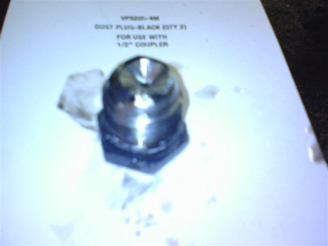

I've added a bracket and piston to my IH sickle bar mower and use my rear remote to operate it. It works much better then the original lever under the 3pt arm to lift the bar. The first 2 pictures show this modification.

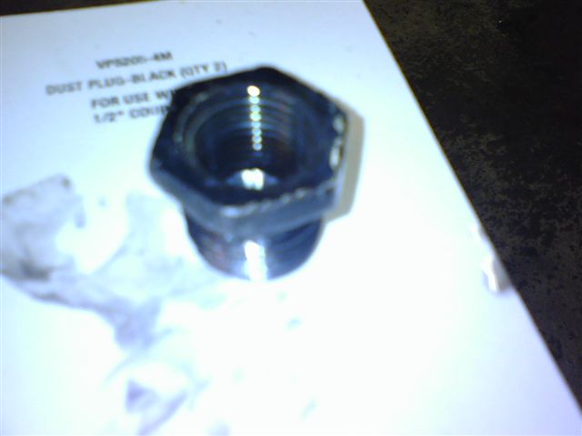

The problem is that it lifts too fast and can flop the bar higher than the pitman arm can handle. I've tried to slow it down with a home made (nearest TSC is an 3/4 hour drive each way) 1/16 orfice (last 2 pics). I made the orfice in a 3/8 to 1/2 bushing and use it between the hose and the QC at the tractor on the lift side.
With this orfice in place the mower will raise at the speed I want but will not go down at all. The hyds just squeal as the pressure relief does it's job. If I shut the tractor off and operate the valve the bar will go down fine under it's own weight.
I've since opened the orfice to 3/32 and counter sunk the holes, same problem.
Any ideas as to what's going on?

Just a guess.
If the orifice is on the mower side of the QD, when you lower the blade rapidly a stream of high pressure fluid is hitting the back side of the poppet or ball valve in the QD. If the QD is worn, or if you are using different style QD nipples and sockets, it is possible that there is enough slack in the valve that the fluid stream is closing the valve and blocking the flow.
When you lower without the power on, you don't get the same high pressure stream because the pump is not moving the cylinder; only the weight of the blade.
If I am correct, move the orifice to the cylinder/hose connection and it will work.

Farmerford; Good idea, that seems like the senario. I'll try an elbow first to see if that helps. If it does, I'll build another orfice to fit onto the piston end.
Thanks,
Dean

Consider also that there could be trash in the cylinder/line, such as piece of an o-ring or piston seal, that is too small to stop up the QD but too large to pass through it. In the past it just travels up to the back side of the QD when the fluid moves rapidly and then stops. But if the orifice is in the path, it may be big enough to plug the orifice (it is amazing how something relatively soft can withstand a lot of pressure if it is confined). When you reverse the flow it passes back down the hose into the cylinder. When you lower the blade slowly it may not get pushed up the hose because the fluid is moving so slow.
Sometimes these things sink and sometimes they float, so that can affect how they behave.
Once I had a flap of inner hose lining peel back where the end fitting went into the hose. It would block the flow when the fluid traveled one way, and flow freely when the fluid went the other way.

Problem solved!
FarmerFord was right on the money with his first post. The fluid coming out of the orfice was shutting off the QC. I added an elbow to the fitting and finished mowing the pasture.
Then I welded a piece of 20 penny nail, laying across the countersunk area, to break up the stream. This way I could have the esthetics I want in the plumbing. :)
