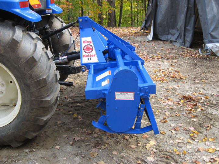

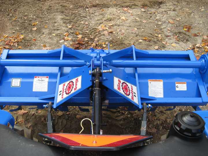

I wanted to update this thread so everyone would know what happened to the KKII that was purchased at auction. I couldn't find a 40 mm retaining ring locally, so I ordered one from KK. I hate to tell you what I paid for one little retaining ring, plus shipping, but I thought I should have the genuine thing based on the fact that the problem with this tiller boiled down to a gear coming off after somehow discarding the retaining ring. When I received the ring I installed it and checked out everything by manually spinning the PTO shaft. Everything checked out, but I wasn't ready to put it to use for about another month. In the meantime I decided to paint the tiller New Holland blue, and am pleased with the way that came out. After the wood splitter came off it was time to till the garden and plant some winter rye. Free spinning the tiller with the PTO engaged everything runs and sounds great. Shortly after I started using it to till the top gear came off again. This sent me off to the local hardware store where I decided to buy the closest size, 1.5", which is about .6 mm smaller than the metric size. This was installed and I tilled up four small gardens, with many rocks, and there was no problem. I am wary that it will recur, but am hopeful that the last ring was a better size or stronger. There is no observable play in the shaft, so it would seem to come down to the retaining ring or its groove being responsible for letting the gear off the shaft. Any other thoughts?
