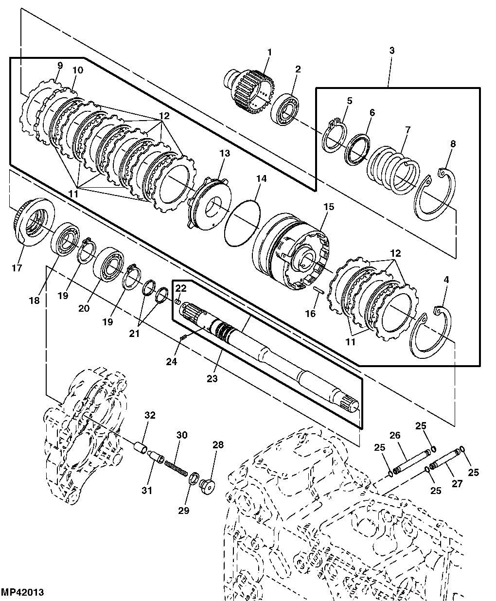

I have a 4320 that the warranty runs out the first of dec. The problem I have is there is a squelch right when the pto gets to 1/1 (engaged) if you will. I have tried all rpms from idle-1400 with the squelch only getting louder with increase of rpms. I have transported my tractor twice to my dealer (1.5 hrs one way) for repairs. The first time the tractor failed to make the noise:mur:. I took it back last fri with my 6' bushhog they sold me with tractor and there was my noise. They said it was ready yesterday after replacing the dampner (sp?) but when I got there and tried the pto there was my squelch again. The dealer told me to just take it home THERE WAS NOTHING WRONG WITH IT but admitted hearing this squelch.
This noise sounds like it comes from under my foot when on tractor. I also hooked up my cutter to a new 4520 on lot and no noise.
Anyone ever dealt with this problem

No noise with nothing attached. The more pressure it takes to start the implement louder it is. It mostly does it with my frontier rc1072 bush hog but sometimes does it with 6' finish mower but that is rare.

The noise sounds kinda like and about as loud as a squaling tire. It lasts for about a second

It only makes noise when engaging pto.

That is the internal PTO clutch slipping-sounds normal to me.
