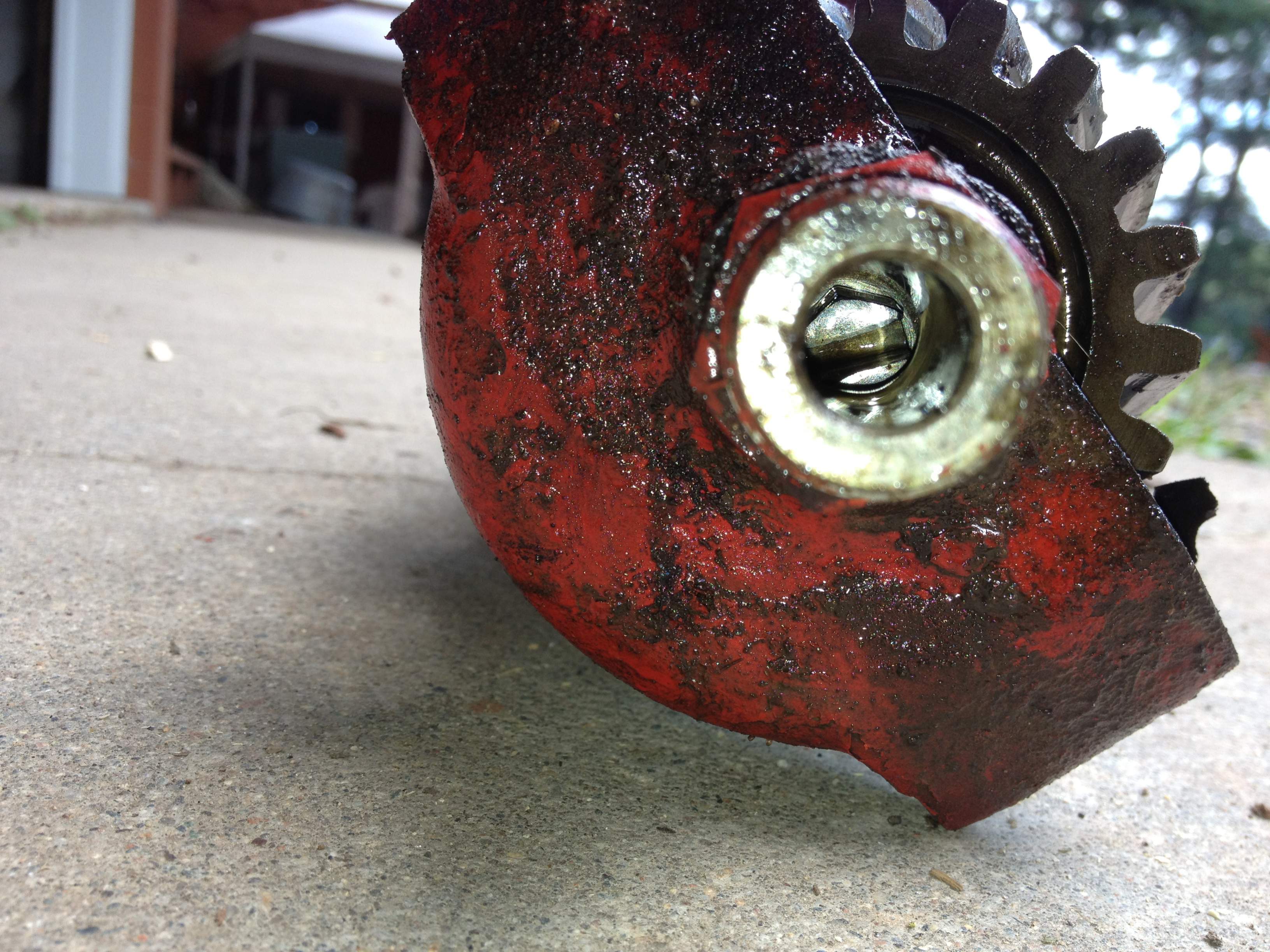

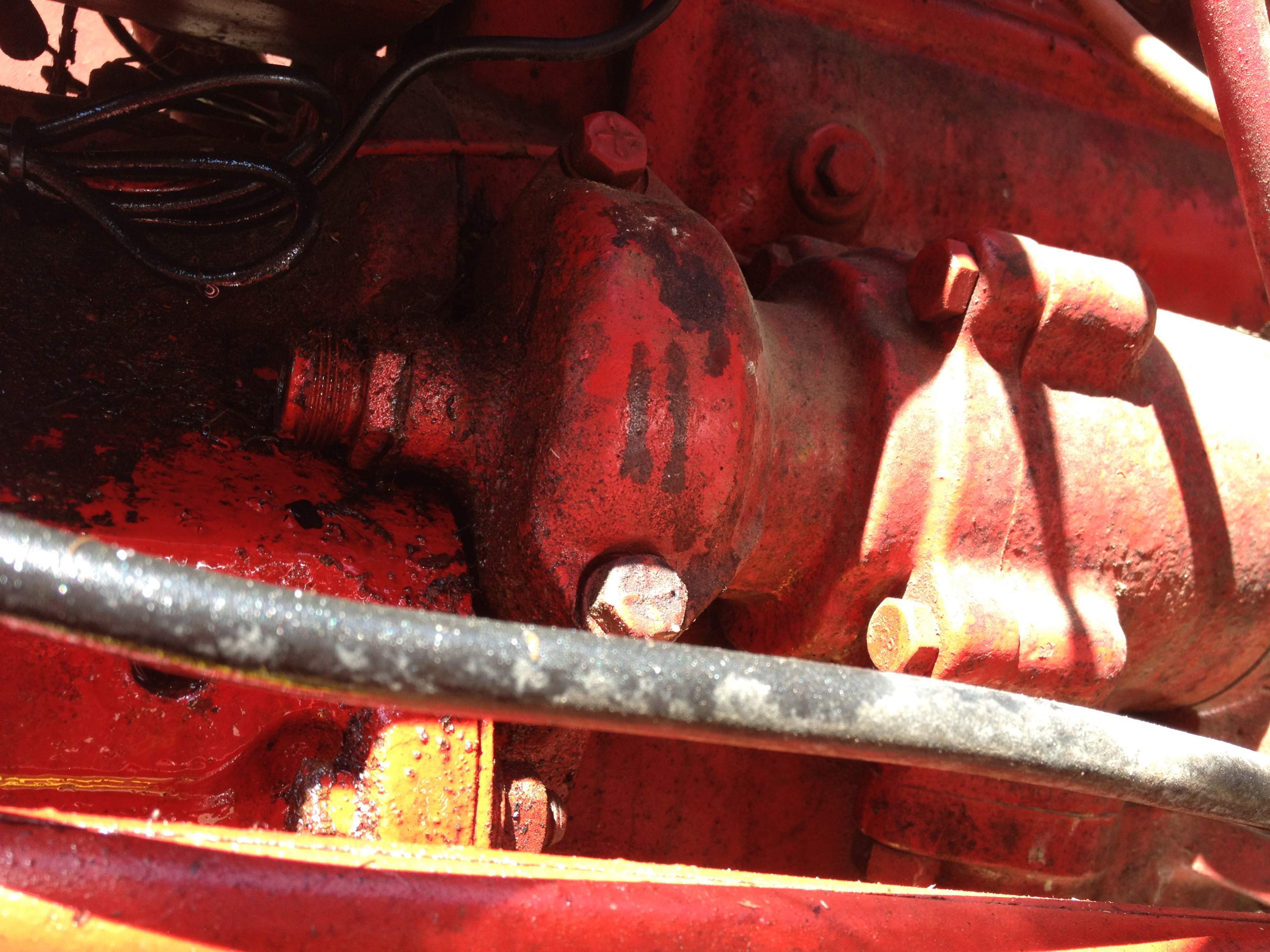

I am not sure what part this is (can't find it in the Owners Manual) but I have oil spitting out - while idling or in motion. never had this problem and would appreciate help in determining what this part is, and why the oil is spitting out (I believe it is oil). Oil/fluid is spitting out horizontally, from right to left, from the inside of the threaded cylinder, left side of picture, below the black wires.

The part shown in your picture is the hydraulic pump. The left part of the pump where you say the oil is coming from is where your tachometer cable is supposed to go. Now for the hard part...why is oil "spitting" out of there? I have never had this problem, but I would guess that you must have a bad seal. Maybe if you put the cable on there like it is supposed to be it wouldn't leak so bad. However, you will probably be looking at a pump rebuild from the sounds of things.

I drained the oil, hydraulics (and transmission, etc. they all need a change) and pulled the pump which was easy. The O-ring-like seals to the hydraulic system look good but I need another gasket (I will probably order/replace all of them). When I look down the threaded pipe/tach hookup I can see a flat screw driver like sleeve. I assume that is not pressure tight and oil from the crank case flows in there, which has recently started to spit out the threaded tach attachment end. Questions:
- Is that where a the tach attachment is hooked to, to sense revolutions (I assume so)?
- Should this be sealed from oil entering it? Should there be oil in there whether I have it open, caped off, or put on a tach attachment?IMG_0171.jpgIMG_0172.jpg

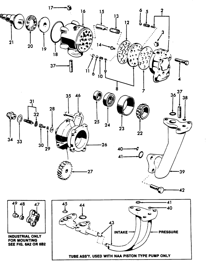

840hydpump.gifthat gear you see is driven by the camshaft.. there should be a gasket where the pump bolts to the housing. engine oil can get where that gear is.gasket is number 46
are you seeing engine oil i assume? if you were seeing hyd oil.. I'd also guess you'd be 'making' engine oil' and loosing hyd oil.
here's a parts list of that pump.. and I'll attach a diagram.
look at round gasket #33 see if you have one as well.....
