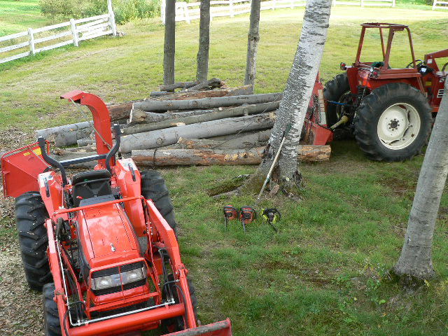

My fel has a bar bolted across the top of the booms at the rear, just in front of the virticle mounting arms. I suspect this keeps the booms from shifting position, especially if the bucket is not on level groundas compared to the legs.
You can see it in this picture if it is big enough to see the details. (click on it).
