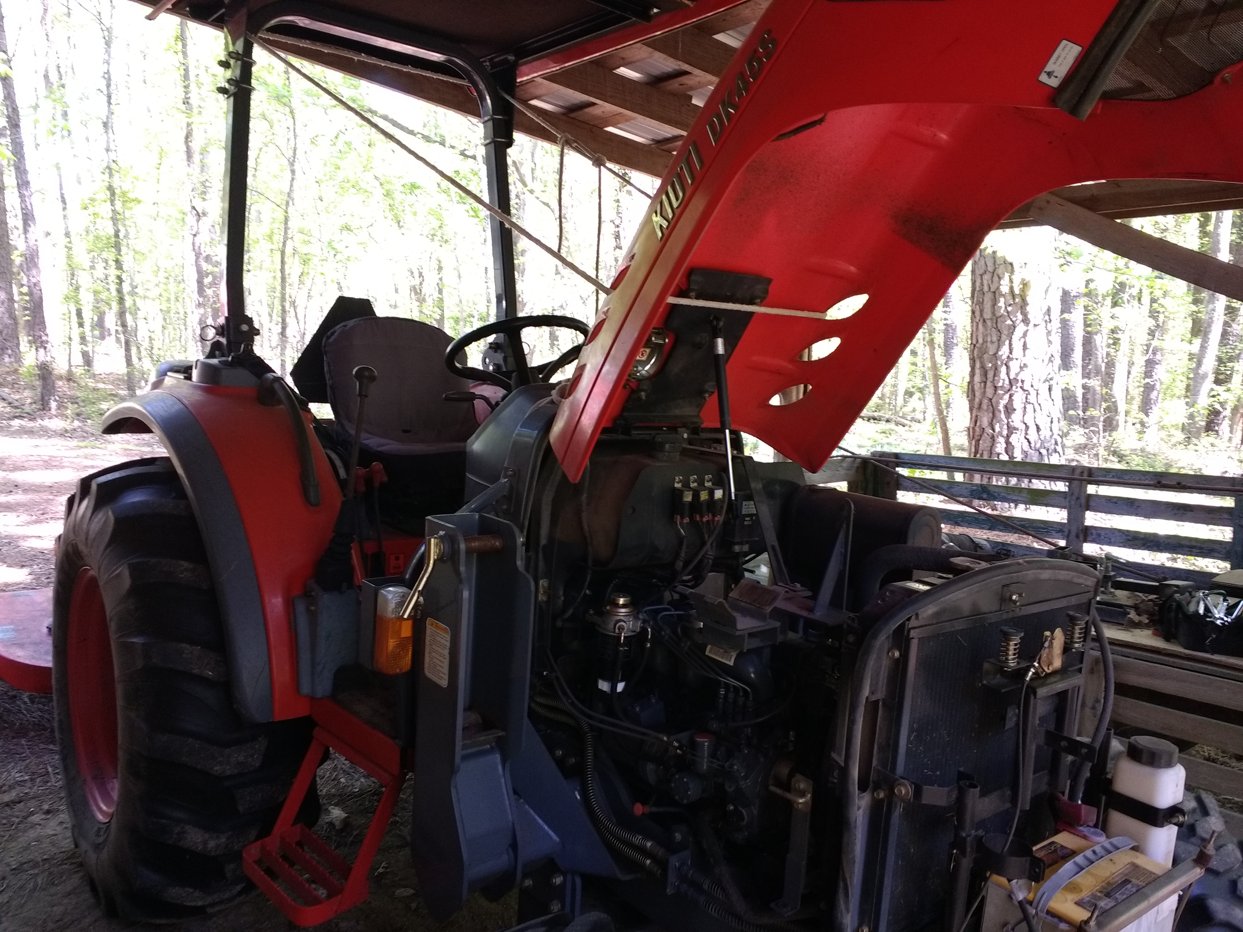

To the OP, glad to hear you've managed to get done what you have to date without mishap. I agree that wrangling your hood by yourself is too much to expect, if for no other reason than it is awkward and heavy. You might find a ratchet strap helpful to lift the hood and then hold it upright by tethering it to the ROPS as you have described. This way you can raise AND lower it by yourself easily and slowly. I would suggest a secondary backup of rope if you see the need for additional safety while working under the raised hood.
Good luck with the remainder of the repair.

A rope worked fine for holding the hood. It was very easy to do. In the shot below I've removed the air cleaner housing (but that's all) when I took the photo.
SWMBO decided we need to go food shopping today so I didn't get any work done on fixing the actual IP. Email from MIE said they shipped my gasket today so final reassembly still several days away. On the plus side, MIE charged only about $2 shipping; I guess they combined my two separate orders. Good on them.
