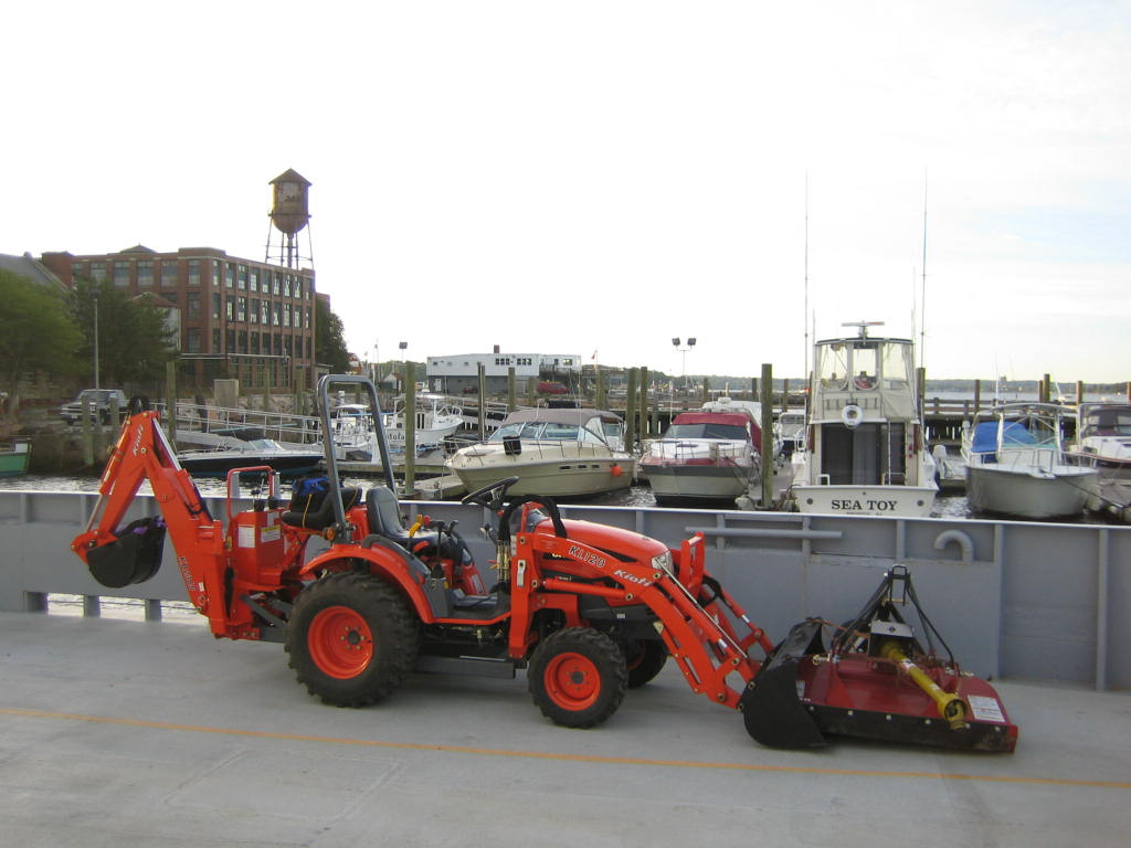

The first change over from backhoe to bush hog was a bit too exciting.... /forums/images/graemlins/frown.gif. With the engine off, I had flipped the backhoe seat up to get at the attachment pins on the subframe and did not realize it left the seat pushing on the control sticks. I started the engine to pull slightly away from the backhoe and I couldn't figure out why I wasn't moving forward.... then /forums/images/graemlins/blush.gif /forums/images/graemlins/blush.gif /forums/images/graemlins/blush.gif I realized I was moving UP /forums/images/graemlins/crazy.gif! The backhoe had lifted the rear of the tractor 12 inches off the ground. I was on a tripod and rising. I had no idea what was happening at this point, but I can, in retrospect, acknowledge that this was my initiation moment for "pucker factor". I shut off the engine, jumped off the tractor and surveyed the situation (pucker factor withdrawl syndrome clouded my thought process so I forgot to obtain a photo of the exact moment). I then realized the seat had been resting on the controls and the backhoe had lifted the tractor. I slowly lowed the beast to the ground (without power). It was a dangerous situation for a newbie and one I had not seen discussed previously on TBN /forums/images/graemlins/frown.gif. Here is a photo (reenactment) of the seat hitting control levers. Has anyone else experienced this event?? Seems to me that the ability of the flipped up seat to activate the BH controls is literally an accident waiting to happen. OSHA??

</font><font color="blue" class="small">( Seems to me that the ability of the flipped up seat to activate the BH controls is literally an accident waiting to happen. OSHA?? )</font>
I hate to say it, but it's pretty obvious that if you put something up against the control levers, they'll get pushed!! Sorry, but I saw that right away on mine the first time.
Are you using a remote hookup for the backhoe, or running off the power beyond on the main valve? You didn't mention having to move the PB lever over on the main valve when you changed over to the brush hog, so I guess maybe you have a remote?
John
   / Price check and review on CK20 TLB
#31
In order to use my BH I move the lever from neutral to the A position. I guess that is what you call the power beyond valve. If I leave it in neutral I have no power to the BH.
Regarding how "obvious" the seat hitting the controls is: I was behind the tractor but in front of the BH controls when I flipped up the seat. With my attention focused on the pins securing the subframe, I did not notice that the seat was resting on the controls. That might seem like an obvious thing to miss but I would argue it is also an obvious thing for a designer to take into account as well. The engine was off when I flipped the seat so I did not see what was happening behind me until I got back on board and started the engine to pull away. The power was on to the backhoe because I needed to jiggle the backhoe controls in order to free up the subframe (at least that is what my dealer showed me to do).
I know tractors are not built with the same safety standards as cars but it does seem silly not to have some sort of lock out arrangement. I presume Kioti is not alone in lacking this type of safeguard.
   / Price check and review on CK20 TLB #32
</font><font color="blue" class="small">( Regarding how "obvious" the seat hitting the controls is: )</font>
Sorry, I was really just picking on you, and forgot to put the smirky face in the post. You're right, some lockouts as the loader joystick has would be good. I hate the way one has to move that seat anyway. On mine, it's necessary to pull down on the lever to move the seat up! Rather counterintuitive.
I honestly have bumped the controls at times while moving the seat with the tractor running, so really I LIED! /forums/images/graemlins/grin.gif
John
   / Price check and review on CK20 TLB #33
I had to go take a look since this has not been a problem for me. With my seat filpped up it just makes contact with the joysticks, not enough to even make them move.
The bottom bolts (seat) are back as far as they can be and the up/down bolts are in the middle setting.
Kurt
#34
</font><font color="blue" class="small">( The bottom bolts (seat) are back as far as they can be and the up/down bolts are in the middle setting.)</font>
That is interesting. My seat is set at the middle/middle bolt position. I'll play with that to see if it helps.
I agree with KiotiJohn that the seat latch is awkward too. Difficult to do with one hand and even more difficult from the tractors left side which is the obvious place for the operator to stand while removing the BH given that the FEL control obstructs access to the operator's seat on the right side.
Both of these issues are things that one can get used to with time. But they do stand out as suboptimal safety/ergonomic points in what is otherwise a very capable BH.
