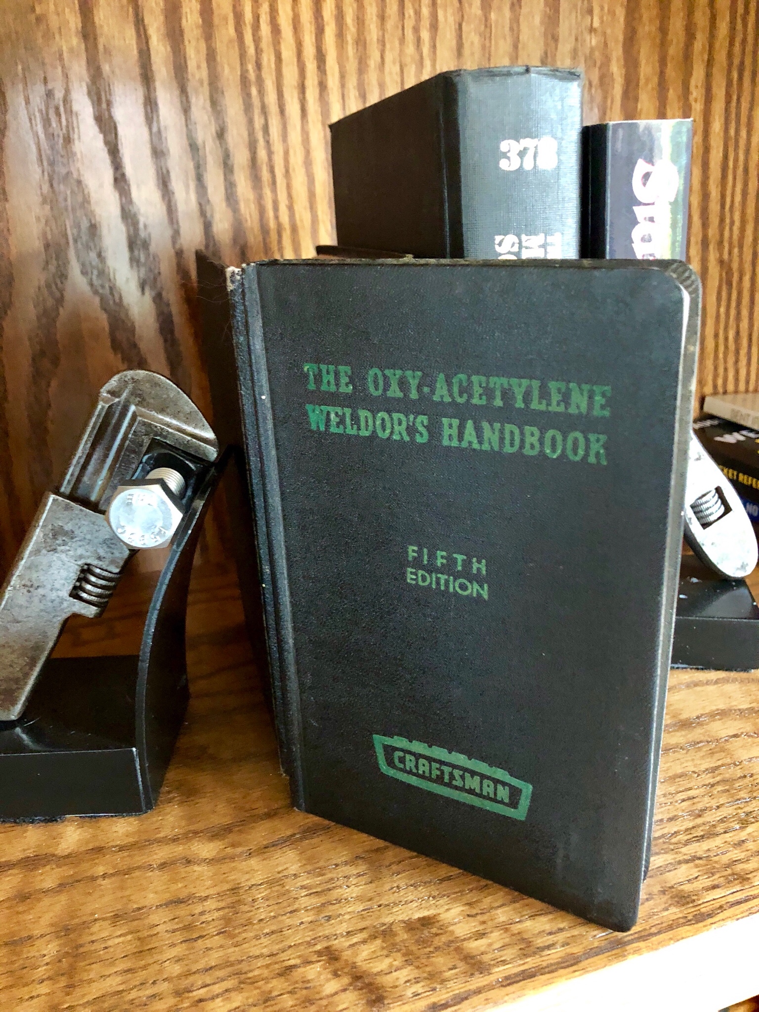

I’d suggest reading up on proper operation of oxy-fuel torches before proceeding further.
This is good:
   / Prest-O-Lite W-250 Torch #13
   / Prest-O-Lite W-250 Torch #15
