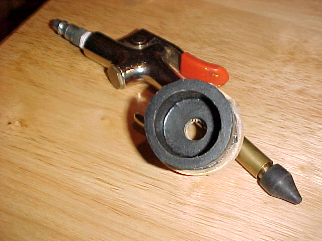

Hi Leo,
There's no warm place to put my pressure washer on cold days, either. I've used a magnetic based lamp, too, but sometimes forget to set it up and turn it on.
I have a Sears PW unit that's a few years old and have blown out pump gaskets half a dozen times when it freezes. I've been very lucky that only a gasket replacement has been necessary...but even that is not good and it's a pain. I keep two or three gaskets on hand in the garage.
A couple weeks ago, after a freeze, my steel reinforced high pressure hose blew out, too. That was the final straw!!
I devised a plan using my air compressor. I used a tapered rubber tip attachment with the compressor hand valve to blow out the high pressure hose. First, disconnect hose from pressure washer, squeeze PW trigger, then blow air through the hose 'til no more water comes out.
To drain the pump, I made a wood/rubber fitting to slip over the water inlet of the PW. With the PW high pressure hose still disconnected, blow air through the water inlet. On my PW, water comes out the pump outlet...enough to convince me that it's mostly gone.
Reconnect the PW high pressure hose and your in business...ready for the next freeze. It's easier than replacing a gasket or buying a new hose!
Pictured is the adapter I made to fit over the pump inlet. A short piece of old garden hose (female end) was my first choice, but none of our hoses are quite ready for dismemberment.
We've had single digits overnight lately. I'll let you know if this strategy doesn't work next time I fire the PW up.

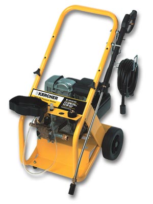

Bill,
That is their K2400HH. That is the one I am looking at also. Northern Tool has one with the same specs and the best I can find that one for is $369.00. My problem is I am not familiar with the Karcher Product at all. Never heard of it or how it performs. So if anyone out there can say a few words about karcher, let us know.
Murph
