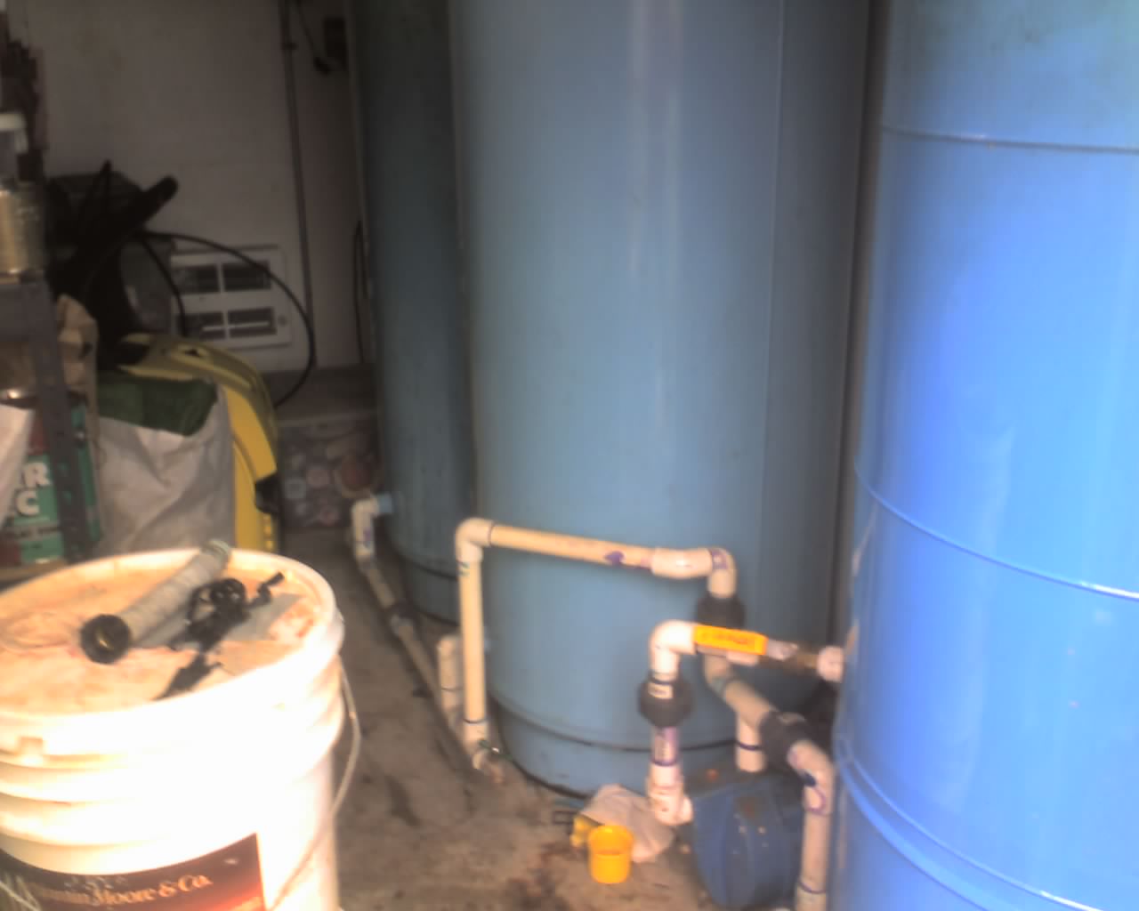

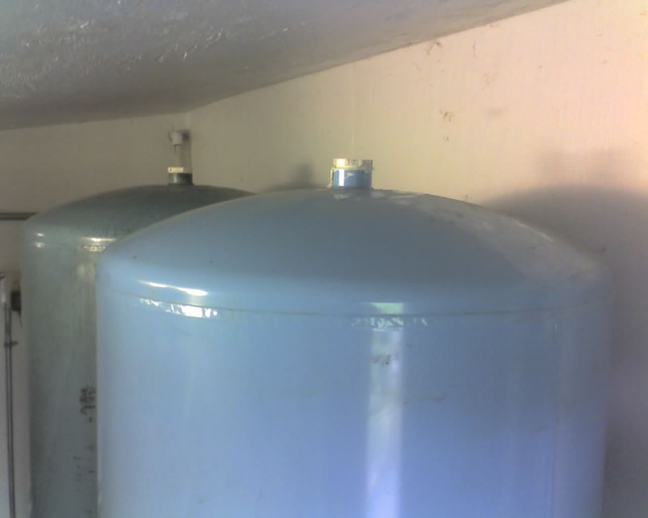

Nope. Just a 1-1/4" white PVC plug in the top.
Replace it with an air fitting so you can charge the tank with a compressor. The most efficient use of the tank is to pressurize it to 2 psi below the pump cut-in pressure. That gives you the most tidal volume per pump cycle.
With no tank bladder, it's hard to overdo. Any excess air will just bubble out through the plumbing.

Your tanks are waterlogged, but you already knew that. Well service people make more money on water logged tanks than you can imagine. Waterlogged results in lots of burned up pumps, switches, etc.
Since you went ten plus years with no trouble I would just check it every 3-4 months and make sure there is still a good head of air. No need for anything fancy yet.

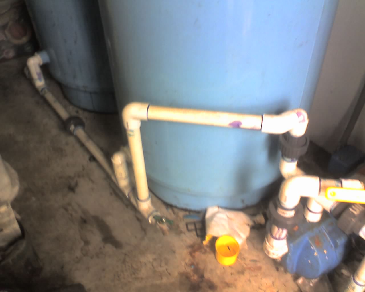

For those who are interested, here are a couple of pix of the tanks.

I use non-bladder tanks without a problem. I recommend that you replace the PVC plugs on top with a tapped plug that will let you install a Schraeder valve. Pressurize the tanks to 15 PSI before you start the pump and you'll have an honest pressure reserve in the tank. I'm sure you'll have to bleed the tank now and then, but putting the 15 PSI in first really helps keep that to a minimum.

Are you sure they aren't bladder tanks? Those *look* like bladder tanks.
