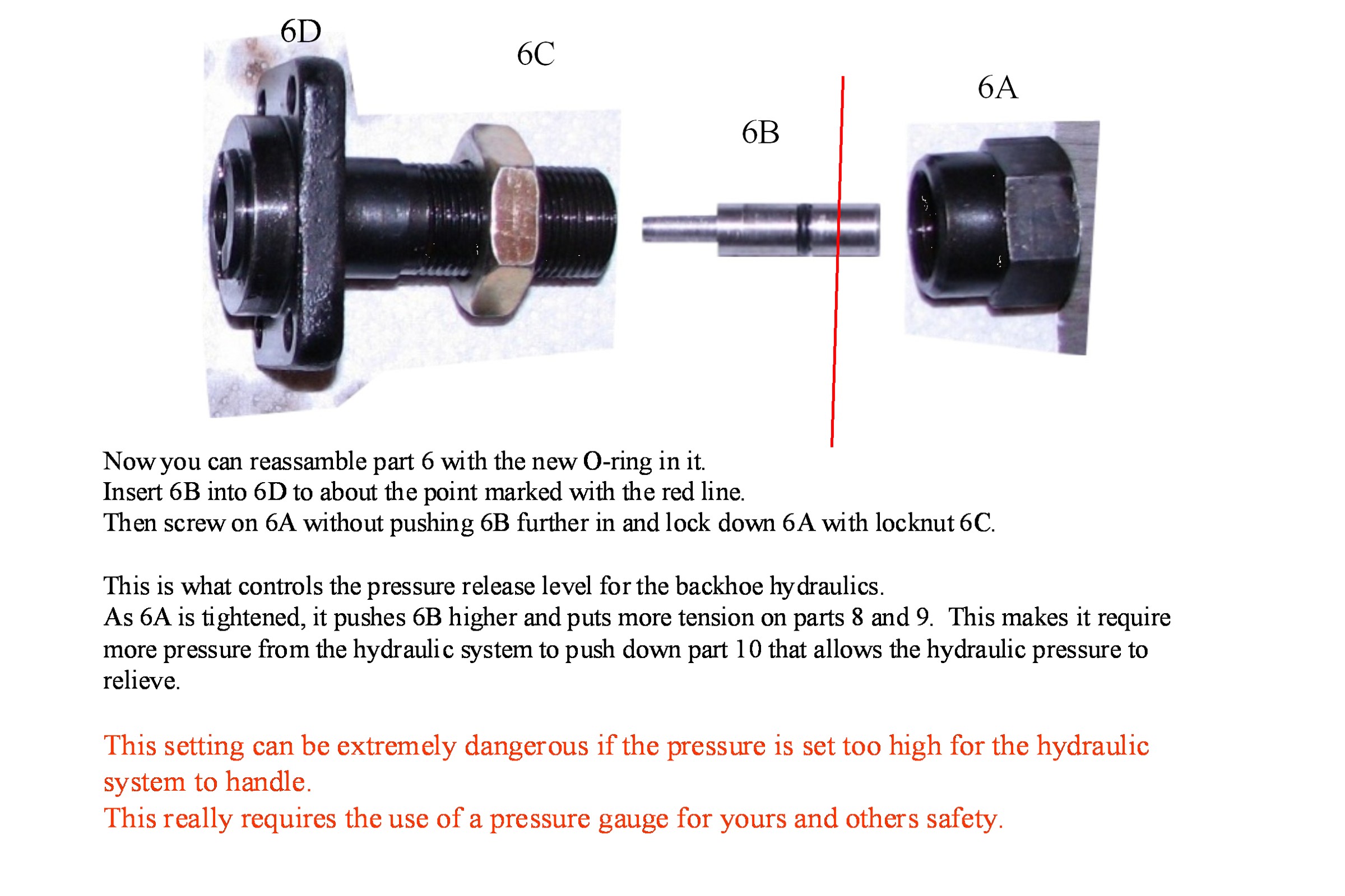

Another option which I did for my BH is to modify an adapter that will screw down into the plug that holds down the spring for the check valve ball. When seated at your backhoe, there should be a round slotted screw head plug to the left side of the valve. This plug is directly over the relief valve assembly which is on the bottom left end of the valve block. You can modift an adapter to the same dimensions as this plug and put it in place of hte plug, and screw the gauge down into the adapter. This worked well for me to check system/relief pressure. IF you like, I have some diagrams of the adapter I modified, but it requires a little machine work with a lathe to make one out of a standard metric adapter.
Good Luck
/ Pressure check on JW03 backhoe
Ron,
Thanks for the reply, I have seen your photos/diagrams of the PRV setup. It is the machined part that is a problem for me at the moment. I was wondering if I could put a longer spring in the check valve which would fit inside the adapter but I didn't know whether this would effect the working of the check valve and cause me a problem there, hence looking for a "easier" way.

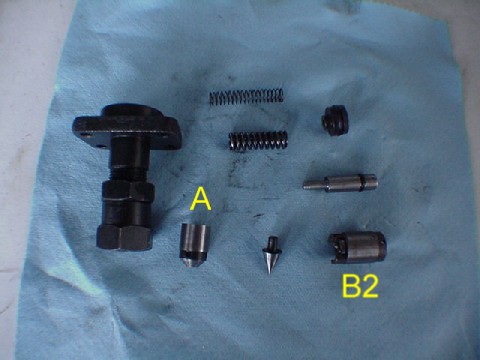

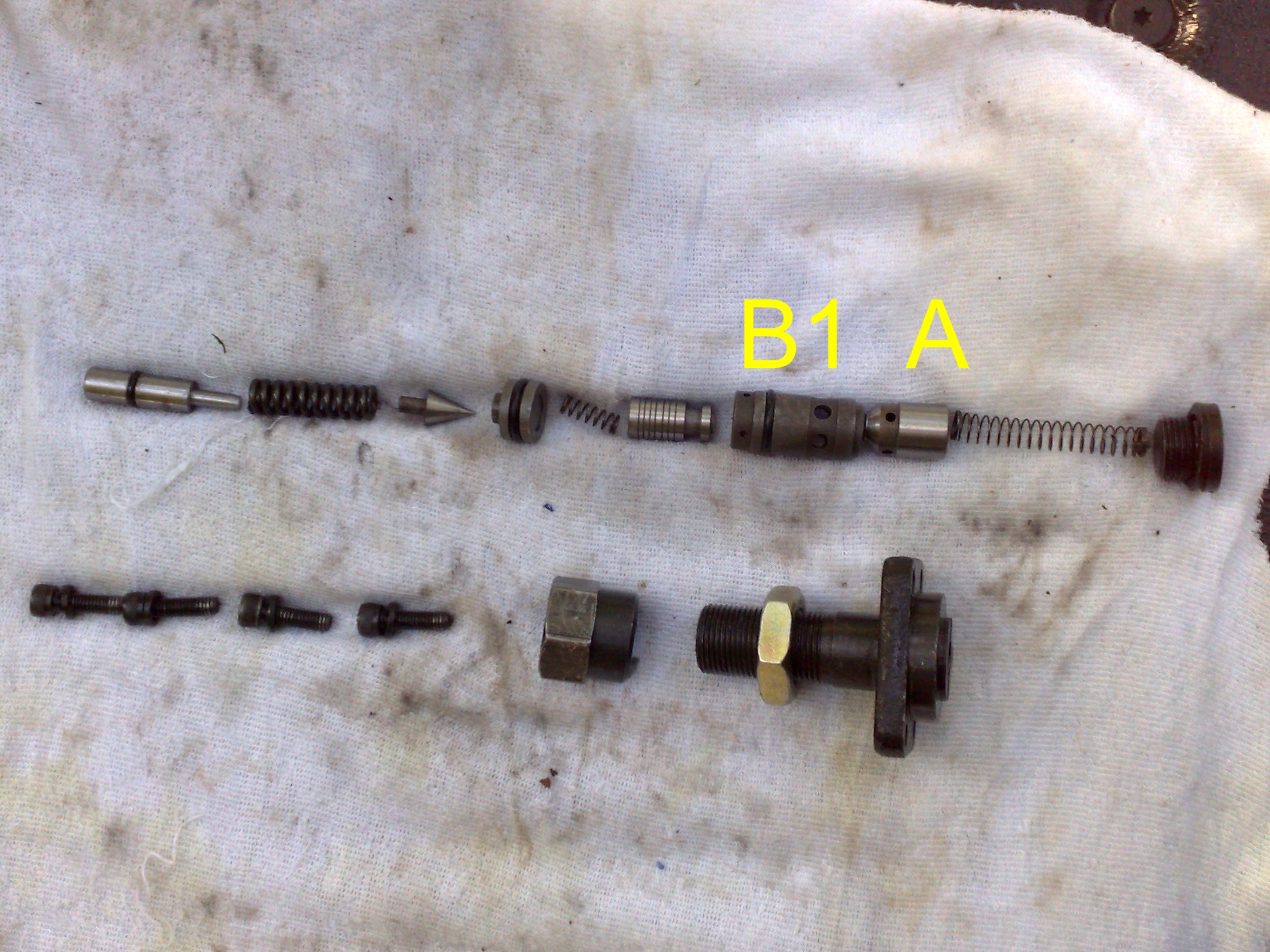

I decided to purchase a pressure gauge, but where should I insert it into the hydraulic system as easily as possible. Hence the original question. My check valve does not have a "ball" in it, unless the component (A) in mine is called a "ball". See attached photos In my PRV I have a component, either B1 or B2 that I cannot get out. B1 has an o ring on it so I imagine it should come out. So as not to cause any damage by forcing this part I decided to leave it be. I considered the fact if this part is removable has it moved and got stuck and is effecting the adjustment of the pressure in the valve. The reason for my thinking of this is that I have again rebuilt the PRV and when I insert the bottom pin (6b) it feels like I can only just insert it and I mean just, with the o ring just inside the valve and not as far as the red line in the photo. The o ring on my pin does appear to be slightly nearer the end of the pin than the one in the picture. I suppose that could explain that. It's past midnight here now so I will sign off. Thanks for your help so far.

The term "Ball" is generic, and refers to the moving part of a ball type check valve. part "A" in your attached pics is the check valve ball and mine looks lust like the one in the pictures. I do not think the upper check valve portion of the control valve inlet would have anything to do with your described problems. The fluid enters the control valve body from the left side(when seated at the hoe controls). As it enters the valve body, it flows into the vertical cavity that houses the PRV and check valve. The fluid enters on the middle leg of this "T" shaped cavity, with the PRV on the bottom and the check valve on the top. The fluid has two paths it can possibly take. It's normal path is up past the check valve, pushing it easilly up and out of the way. The fluid flows past the valve ball and enters a gallery that runs all the way across the control valve body and enters into an exit gallery. As you operate any spool control valve, fluid is diverted from this cross gallery and sent to a cylinder. The return from the other side of the cylinder comes back and makes it's way to the exit gallery. As long as the commanded cylinder movement occurs, there is always fluid flowing out of the exit gallery. The other path the fluid can take is used when the comanded cylinder movement does not occur. As the pressure builds in the inlet "T" cavity from the stalled flow, this pressure forces open the PRV, and the flow is redirected thru the PRV to the exit. THE FLUID IS ALWAYS IN MOTION, either thru the valve unrestricted, performing work in a moving cylinder with flow comming back from the backside of the cylinder, or thru the PRV when it's limit has been reached. Fluid not flowing does bad things, like blow out seals in a hydro pump, or blow hoses, or bend/break structurs ect...
If you are seeing flow across the reservoir with the pump runing, then the pump is obviously moving fluid. If at this same time, you cannot perform any work with the hoe, then the fluid is bypassing the gallery that feeds the spool valves, and no pressure can be built to move the cylinders. This bypassing is most likley occuring in the PRV, that has most likley something stuck in it and holding something open, that should be pushed closed by a spring. As you surmised, the part with the "O" ring on it that you cannot remove, is probably the root of your problem. It could be that a piece of crud has worked it's way thru the system and wedged itself into this close tollerance part. The dealer I bought my hoe from said that crud in the valve was the only problem they had had with these units.
The only purpose of the check valve that I can see is to prevent fluid from exiting back from an open control valve on a heavilly loaded cylinder toward the pump, or the PRV. In my experience, most valves do not have a check at this location. Instead they have whats called a "load check" on the inlet to each spool of the control valve that prevents fluid from flowing back into the cross gallery and being fed to another open spool valve. This valve dosn't have individual load checks, which IMO is probably it's biggest weakness as far as smooth operation is concerned.
In your position, I would disassemble the PRV and check valve again and using some smooth faced rod stock or punch, see if I couldn't gently get that immovable part to move either up or down, and perhaps out of the valve body. Once out, a testube or bore brush and some kerosene or diesel could be used to scrub out the PRV cavity.

3. Remove PRV and try as Ron Mar suggets. What I don't understand, the piece I cannot remove at present, if I get it out, how do you know where abouts in the valve it fits? How far up/down the valve do you insert it? Is there as "seat" for it to come up against. That would determine if it comes out through the top or the bottom of the valve. If it is a moving part and is stuck, what does it move/stop against as there are moving parts above and below it. I just can't visualise this being a moving part and how it fits/works in the valve.
