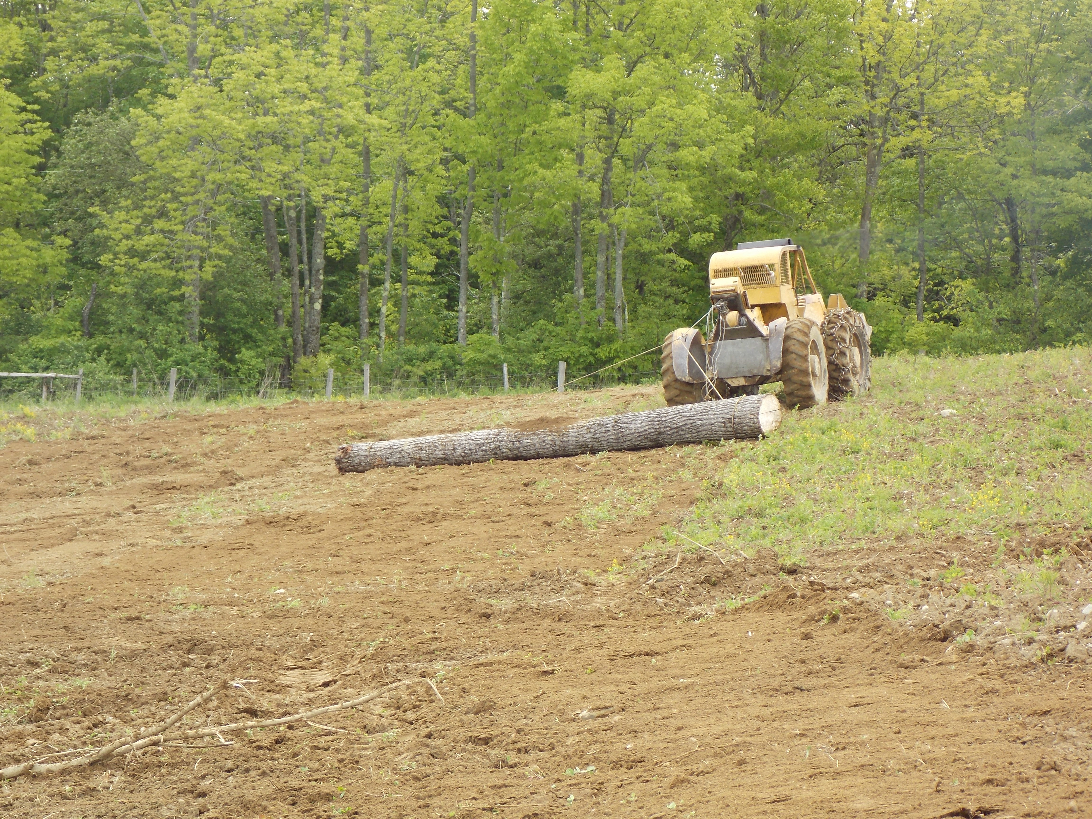

When I crop rotate from corn to hayfields, I just use a plow and a log cut from the woods.
By deep plow with a land plow, it loosens the soil. Then I take the biggest, longest log I can drag through the dirt, and then grade the area.
The log pushes the rocks into the soft soil, but also compacts and smooths the surface of the land. The longer the log, the smoother the field because it cuts and bridges holes and such. Just keep dragging it over the area many times and it will get more and more smooth, picking out the rocks each time you go over it.
I used a skidder to pull my logs in doing this particular field, but it is whatever your tractor can handle.
