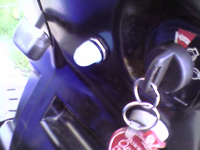

Doesn't that tractor have an automatic preheat timer switch? My TC33D had one and it went out and the dealer had it in doing a conversion to the hydraulic system, he just ran a toggle switch out beside the steering. I liked the idea so I put a push button on it and ran it through the dash near the key. When it is cold it won't start so I hold the button for about 4 to 5 seconds and she fires right off. After that I don't have to use it anymore the rest of the day if it is a warm day. And in cold weather if you don't let it set to long it will start.
When the engine is warm you don't need the glow plugs anyway. As far as I am concerned it probably saves the glow plugs.
