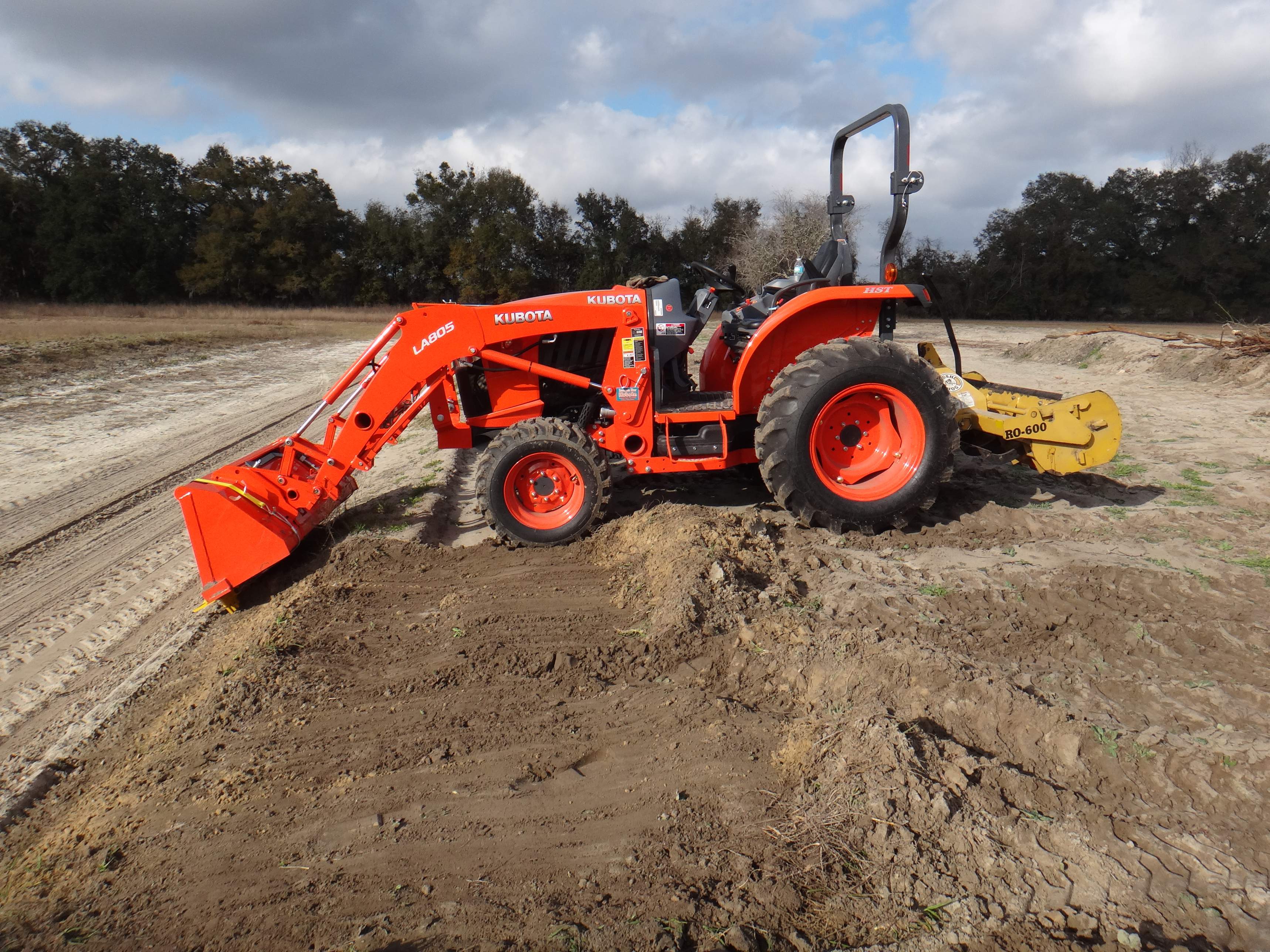

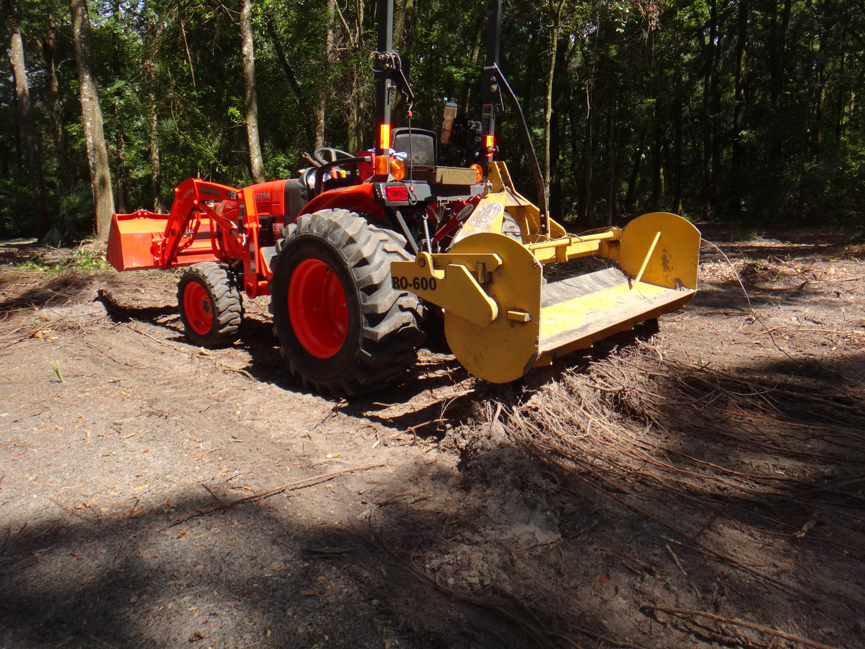

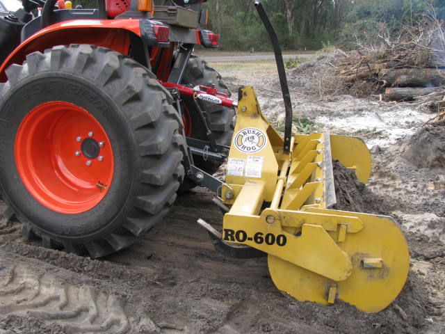

PHOTOS: Bush Hog (Brand) 60" Rollover Box Blade, 625 pounds = 125 pounds per foot of width. This was a max load for my Kubota B3300SU, Photos #1-2. It is an easy pull for the much heavier L3560, Photos #3-5. Both about the same horsepower, both with R4 tires.
