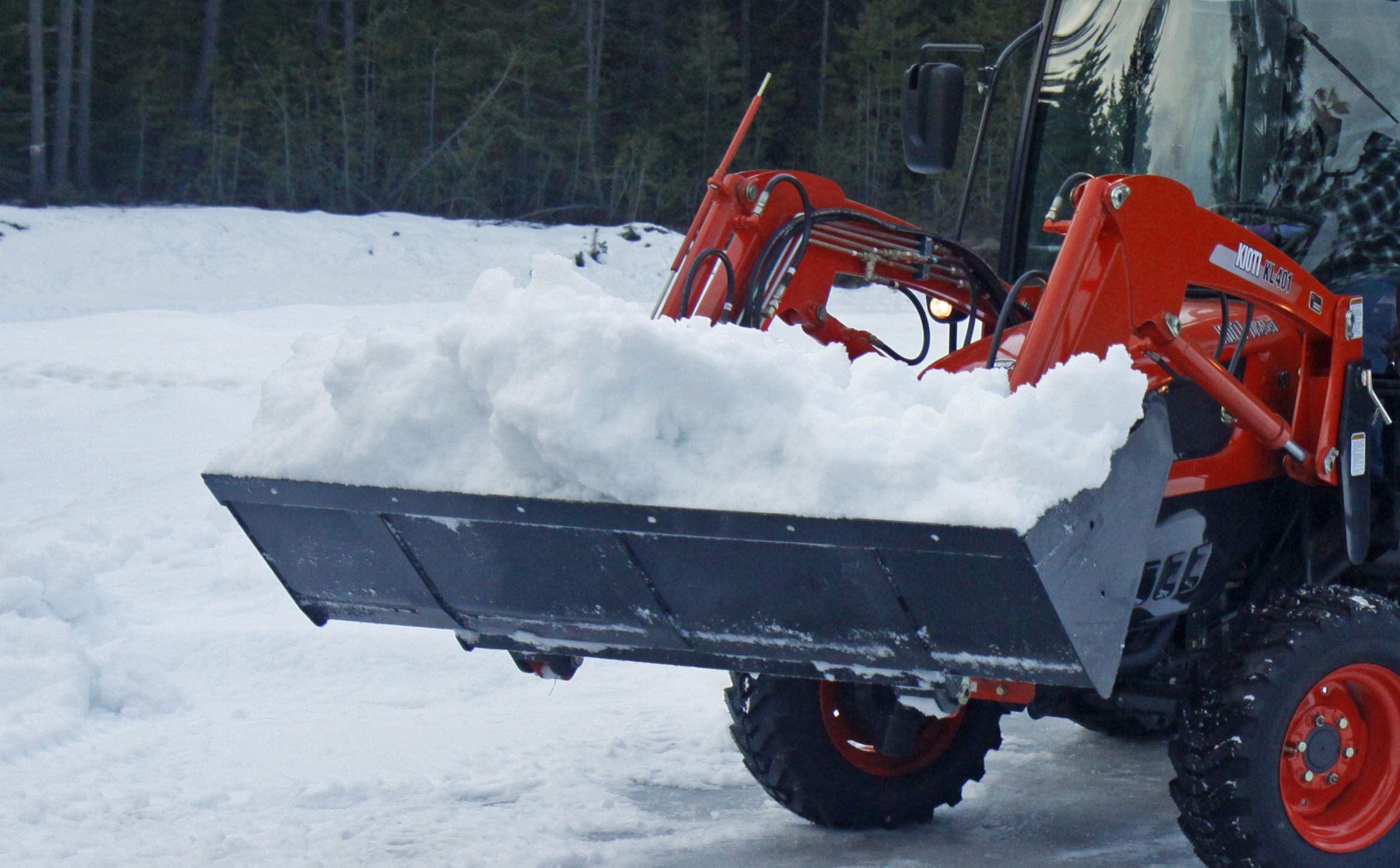

Hey guys my new dk50 hst shows up in mornin. Does the buckets have the holes pre drilled for a tooth bar? Was curious. Ifnot I was goin to c if they are able to drill those holes so I wouldnt have to once my toothbar shows up. Dont have the tools to dril threw that thick of steel. My neighbor does though lol. Thanks guys I will post pics as soon as I get a chance. Rain,is in forecast for the next 5 days so lil down I mite not get to use much. Thanks

Never have seen a bucket pre drilled for a tooth bar. I would wait till I had the tooth bar to make sure the holes were in the right place. :thumbsup:
   / Pre drilled holes? In bucket #3
Toothbars don't have standardized mounts so you really need to fit the toothbar yourself and then drill the holes. The good news is that bucket sides are usually only 12 or 14 gauge or so and drilling the holes is easy even with homeiwner grade tools. A bolt on cutting bar is different and drilling for that could be a real pain.

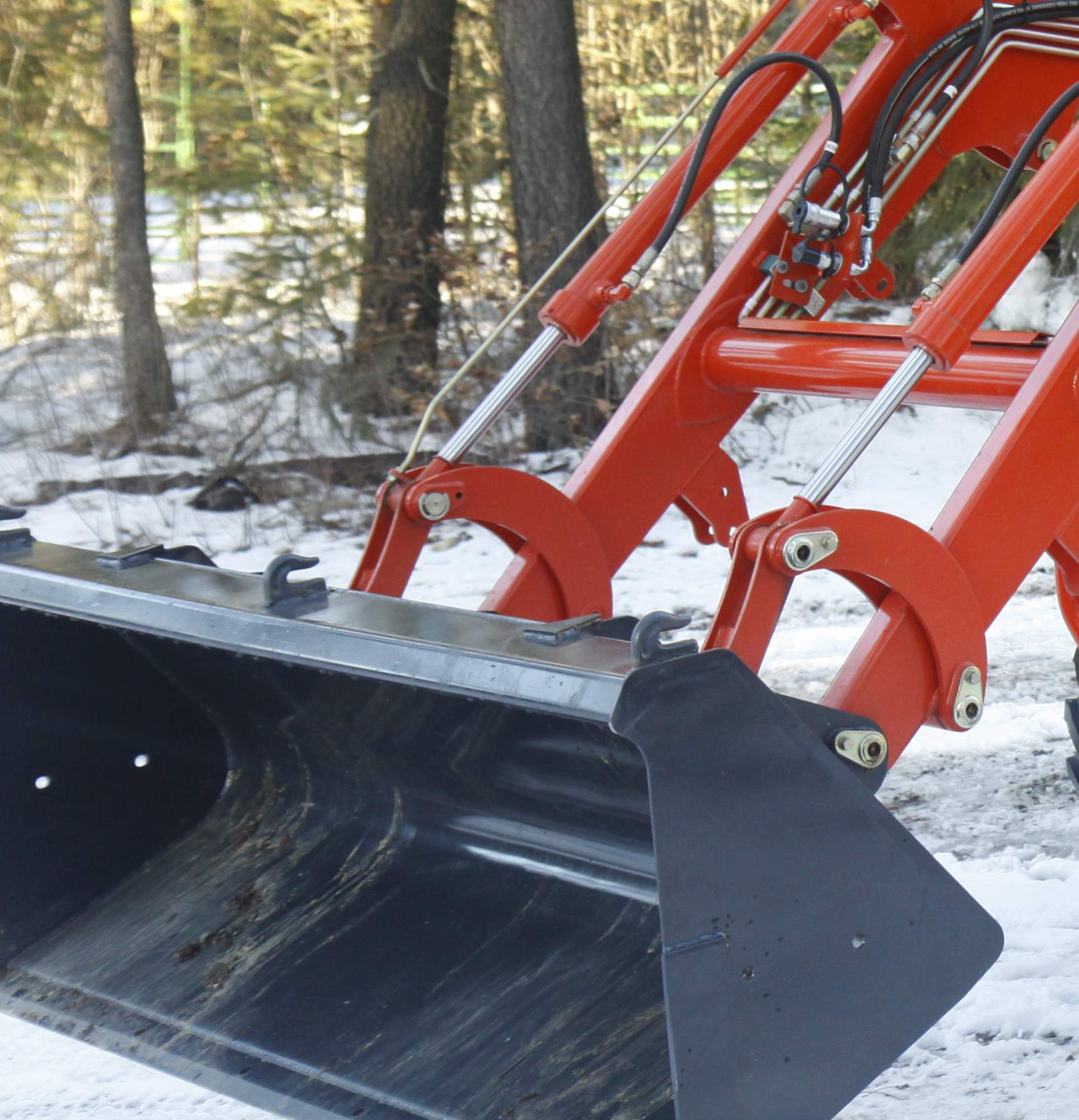

well, my 2011 - DK45 has several sets of holes predrilled in the bucket. 6 on the lower lip and 2 on each side......guess there for a toothbar....but i dont like using toothbars, so for me it didnt matter. see pics

my bucket sides are 3/16" steel...14 gauge is awfully thin
I'm not sure what the holes on the side of your bucket are for.
But they are way to high to be for a toothbar.
im not sure what the side holes are for. im refering to the 6 lower holes. the side holes may be for some kind of grapple???? id love to find out what there for. the dealer isnt even sure what there for.
   / Pre drilled holes? In bucket #10
The 6 lower holes are for a bolt on cutting edge/wear bar.
