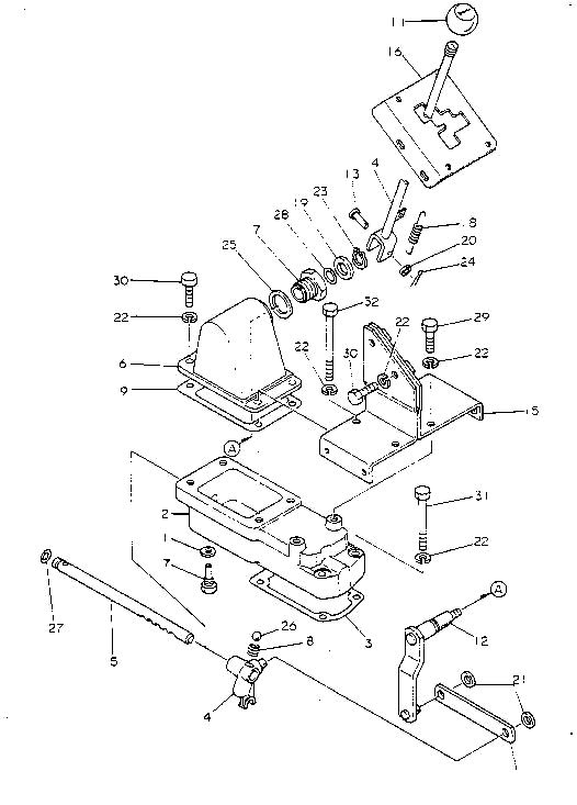

I've been sitting on this project all winter. I'm not sure when I'll actually start working on this as I know there is a good chance of some idle time once I get to tore apart.
YM2210D purchased/new to me in January 2014. Changed all fluids/filters/cleaned hydro screen upon purchase.
Problems discussed today:
1. Cant shift into 3rd gear on the powershift
2. When range shifting it is frequently(not all the time) stiff/difficult to shift into second and third gear.
I have examined the external linkage on the powershift for the "slop" that others in this forum have experienced that prevents shifting the powershift(connection at end of #4 on attached schematic). Everything there checks out. There is a bolt that rotates on/with the powershift shaft (#7 on the attached schematic) that i can put a wrench on and easily shift from reverse to first to second. When you try and go to third you encounter stiff resistance.
I plan on tearing it apart to check for the things I have read about causing powershift problems = dirty/sticky valves, broken springs, bad O rings. Any tear down rebuild advice would be greatly appreciated. I don't see any powershift parts listed on the Hoye site, but that doesn't necessarily mean they don't have them. I'd like to have a collection of the most likely suspect parts on hand when I do the tear-down. O rings and the springs are what come to my mind. There is also a small copper bushing powershift (#25 on the schematic i think) that is all but wore away.

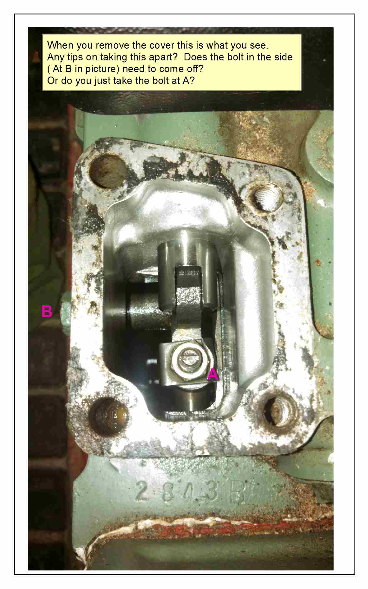

Getting closer to starting this. Question. There is a small cover on top of the "manifold" underneath is a linkage. Anyone ever take one of these apart? It appears that order of tear down could be important. See pictures:

See Figure 39 in your parts manual and it shows more of what is under "A" in your last picture. Not sure what you are wanting to do so no advice.
   / Powershift and shifter repairs #6
If you remove the entire item 2 shifter assembly from the transmission I would think you could isolate the prob between shifter and gears.

Well i finally started this project. In my original post I included a schematic. When I got to the point in the teardown process when I need to remove the "bolt" labeled #7 on the schematic I found that it was somewhat stuck. I really didn't want to exert a lot of pressure on it since it is a linkage. Anyway in the process of me trying to remove I noticed that, unlike before, I could count all the gears (R, N, 1, 2, & 3) as I rotated the nut forward. Hmmm. So I put the gear shift lever back on and of course I couldn't hit third again. I replaced the pin on the yoke (#13 on #4) and gained enough leverage to in fact hit third gear.
Oddly enough the shift lever now seems to be able to travel to far down - to the point where I can go past the reverse position. So now I have regained third gear, but when going into reverse I can actually go past it....
